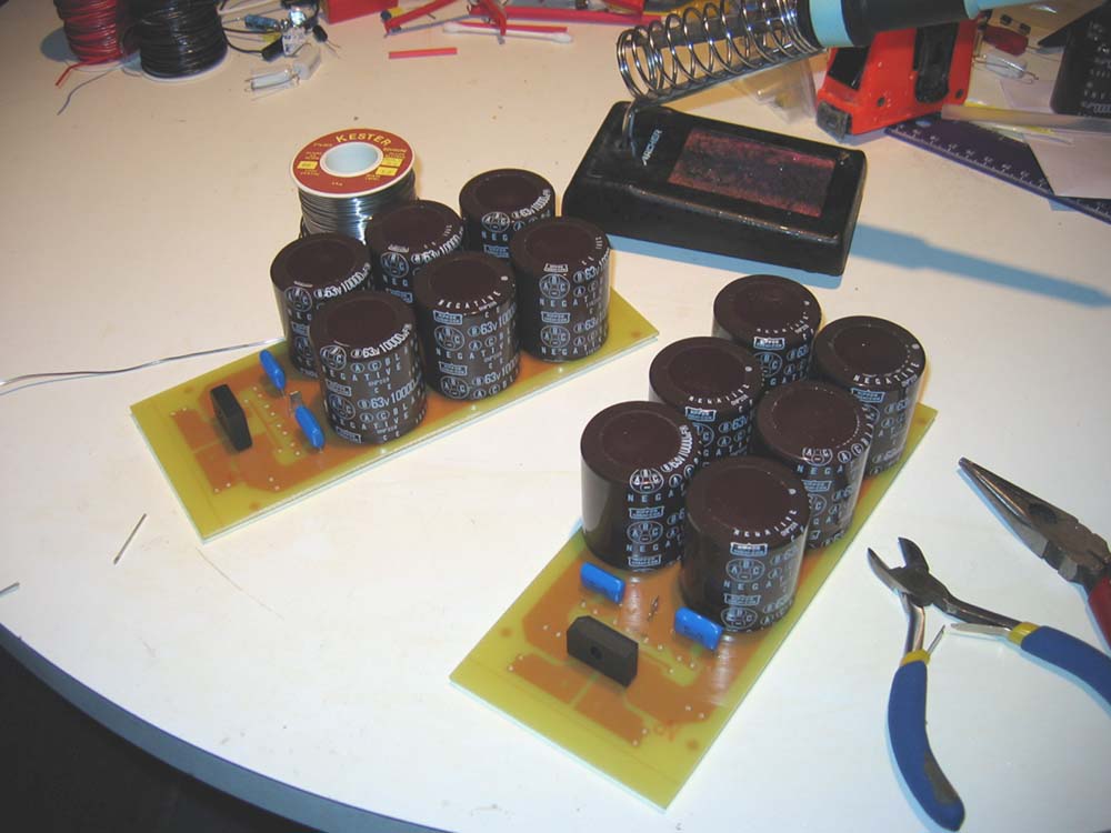

Hi Keypunch,
First, I'm very happy that you type my name correctly now
From what I understand, you said that the first time you view the image, you only saw the silk screen, right? Maybe there was something wrong when I posted the images, because after I had exported the image, I didn't found anything wrong, all the images were OK, the layout view had the tracks in red, the silk screen in white and black background, I really don't know what happened with the image. I will attach another layout (in black and grey like quasi) to check if the prob happen again.Maybe I should use pdf file like quasi too, but sadly my software doesn't allow posting image to pdf file, so I would need another software to change the image from gif or bmp file to pdf file, what a pain,if you know me better, you would see that I'm a lazy guy.
About the resolution of the image, I was very surprise as you said that the resolution of the image is only 72dpi, not 300dpi, because when I export my image, I can choose the resolution, from 100dpi to 600dpi. I will check again to see if my software has prob.
Thanks for your advice about GIMP,I will try it later, but I'm using ACDSee now, and I think it's enough for me now.
Thanks again for your praise about the driver heatsink, but I think I will replace it when I find a better one, because that heatsink is quite hot under normal condition.I also have some heatsink like Shawn's( Hi Shawn, thanks for your offer), but I'm afraid they aren't better than the one I'm using now.
About the res and the inductor of the Zobel network,I didnt have the inductor when I was drawing the board, so I put them seperate to be sure that all of them have enough space on the board( the 5W res may not fit inside some small inductor)
About the main heatsink, yes, I knew that someone would be curious with that weird heatsink. In fact, I use 2 heatsinks for my amp, for many reasons. First, I want to reuse the blac one( it's from a broken Japanese amp), but that heatsink is still small, and I also can't mount the module on that heatsink because its width is only about 60mm. So I decided to use another heatsink( the bright one), this one has 82mm width, so I can easily mount the amp modue on it, then assemble the 2 heatsink together with some bolts and thermal compound in such a way that you can see in the pictures. In addition, that heatsink has the fins along its length, and when I mount a DC fan under that heatsink, a tunnel for the air to flow is formed. Now I have a great weird heatsink! In fact, this heatsink worked very well when I tested my amp, and I fit well in the chassis(which is also reused from that broken amp).
At last, here's the sideview of my amp module, it will give you a clearer view, so you can understand how I use my heatsink, in case you can't understand my poor English.
Duong
