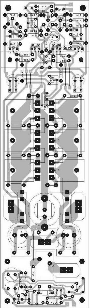

Final Version (I hope)
amp_man_1
On the contrary you have contributed to the final design.
I note your point about the requirement for symetrical rails for the input and driver stages and this is reflected in the final design
Check it out.
amp_man_1
Check it out.

PS. The board design for this amp is in the error checking stage.

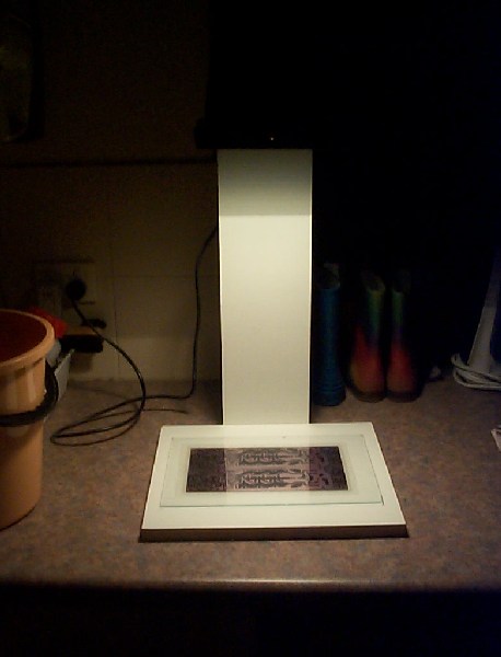

The making of the board part 1 - Exposing
A pair of layouts is exposed onto pre-sensitized board. I use a spray-on positive photoresist called POSITIV 20. Friends of mine in Germany bought some for me and sent it to Australia. I couldn't find it here ...but it's great stuff. Made by CRC industries.
cheers
cheers
