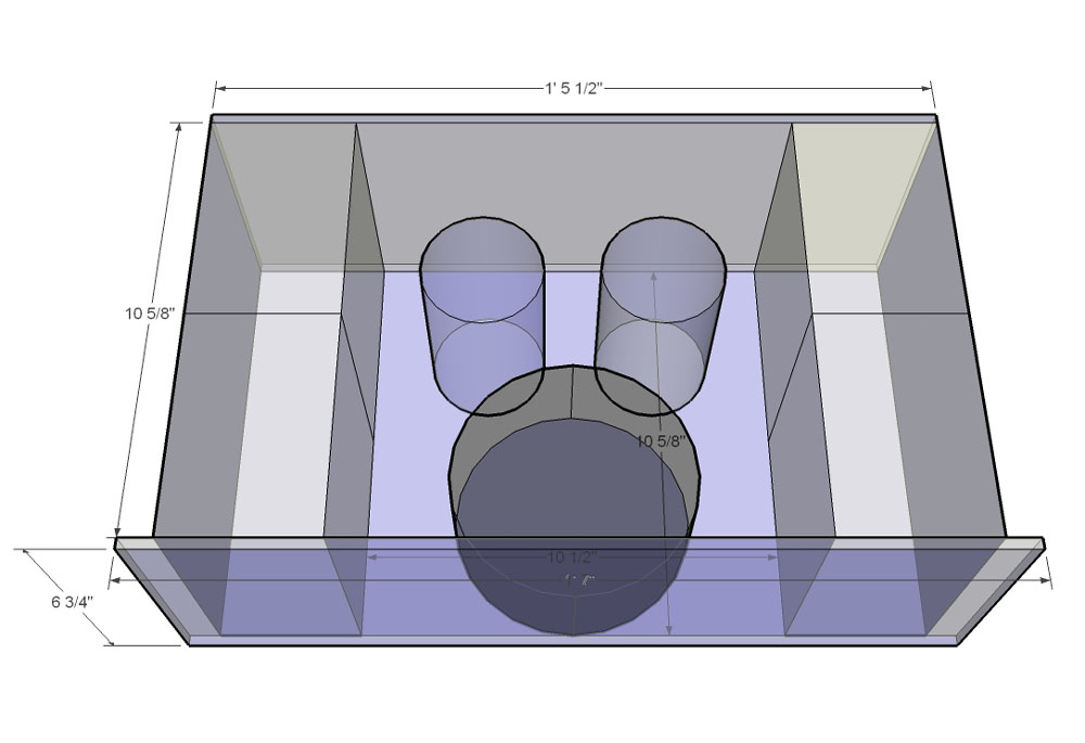

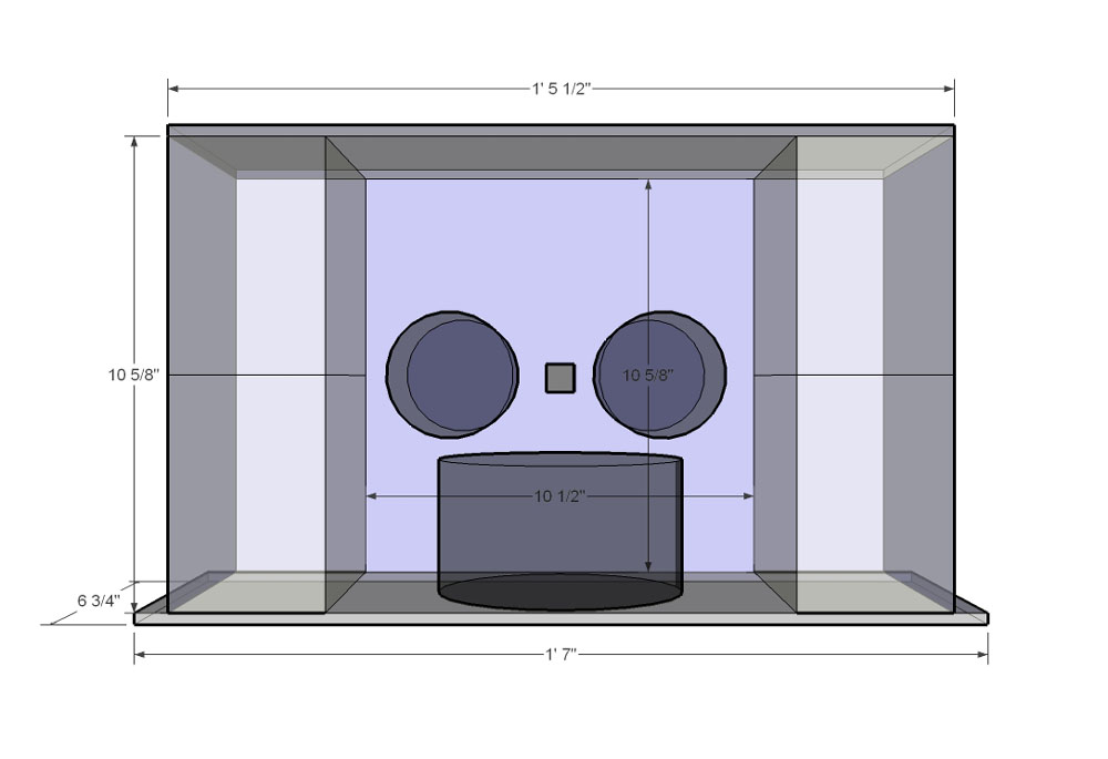

New case
I dropped off some 1/4" aluminum sheet and my heat sink extrusions at the metal shop today. This image is what is being cut. I chopped the quasi boards to just under 10 inches long and the protection circuit PCB will be mounted over each channels PCB in mezzanine fashion. The caps are each 5-3/4" tall and their diameter is 3". The Toroidal is 6-1/4" diameter by 3-1/4" tall.
The interior of the case is 10-5/8" deep by 10-1/2 wide by 6-1/4" tall.
Any thoughts on the component layout?
Shawn.
Shawn.

can you drill and tap a blind hole in the front plate to mount that big transformer? Or fix a stout L bracket to the case floor for a mounting point behind (next to caps). The L bracket solution may transmit less mechanical vibration into the case.
Mr. T, I guess you would like to see the xfmr flush with the front plate vs. sitting on the bottom. Me too. I'll pick up the pieces of the case in a day or so and play"doll House" inside with the funiture. For rack mounting purposes it is always good to have weight near the front. I don't know if the thing will ever be rack mounted, but it leaves the maximum room inside the case having the xfmr on the front plate.
The aluminum is 1/4" so I could take the front plate back to the shop and have a custom bracket welded on the inside of the plate. Have you ever serviced equipment that you can remove both top and bottom? This is a good goal and I may be able to acheive it. I guess I'm not scoring any "art points" but perhaps next time I'll make it a little more sexy?
Shawn.
removable top and bottom is excellent for maintenance/testing, go for it.
Do not weld a bracket onto your face plate. The heat will cause distortion and discolour the parent metal. Even grinding/polishing is unlikely to make the faceplate look homgenious. A good machine shop will be able to blind tap your shallow hole, it's just a bit difficult for us amateurs

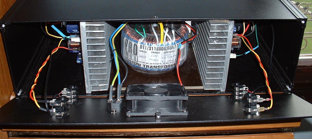

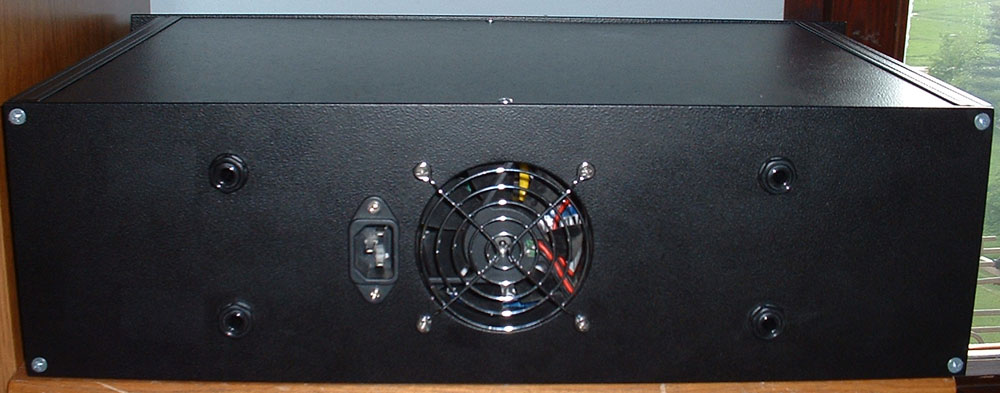

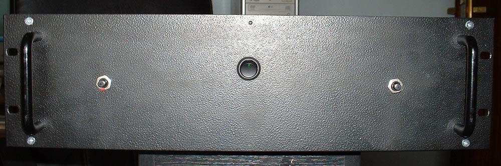

Another finshed amp!!!
Hi guys,
I finaly finshed my quasi amp and place it in the case.
I just want to thanks all the people in this thread for assistance and specially you Quasi for the great amp design .
THANKS
Here are some photos...

Hi guys,
THANKS

A blind hole is one that does not go all the way through the plate. 1/4" aluminum would not give sufficient thread to bolt a 14 pound xfmr to. It would break free in a short time. Still I love the idea of welding a bracket, however some distortion may show up on the other side as you said. I'm at odds with this. I really want to bolt it to the face somehow.AndrewT said:A good machine shop will be able to blind tap your shallow hole, it's just a bit difficult for us amateurs

Nice! Have you been cranking it up? How is it?pejinm said:Hi guys, I finaly finshed my quasi amp...Regards

Hi Shawn,
Mounting plate with multiple bolts?
You could have - let's say - four threaded blind or visible holes in the front plate. They could carry a reasonably thick plate to hold the transformer. A thread size of M4 or equivalent (sorry to be metric ) would be enough to sustain the load of the transformer (provided there are at least four good threads).
A 1/4" sheet still won't hide those threads, but if you can live with a symmetrically placed set of beautiful screwheads, you could still keep the front plate you have...

Hi Shawn,

Yes, this may be the answer and it won't cost a nickle. "Beautiful screwheads" isn't that racist?sek said:Hi Shawn, Mounting plate with multiple bolts? ... if you can live with a symmetrically placed set of beautiful screwheads, you could still keep the front plate you have...
