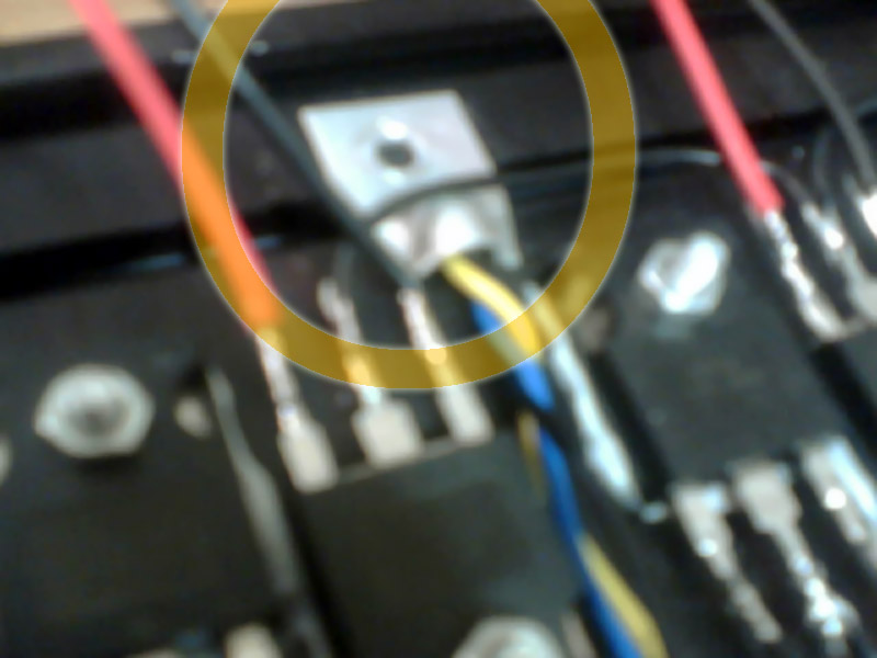

4) Have you found a way to secure the one output driver that you had some challenges securing with a screw yet? I ask as I am assuming that if that one output driver is not physically secured like the others it may be more prone to the device die heat build up, which might lead to its failure.

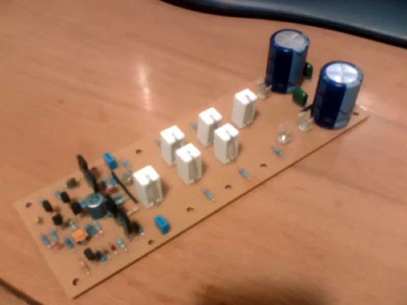

hi all , hi quasi :)
here s mine , it s not complete yet , i ordered the transformer , i ll post some new pics as soon as i complete it ;)
( i used bc639 instead of 2sc1845 )
the main FETs will connect to pcb by short wires ;)
so how is it ? plzzz comment

Hi John,
1) I faced the fins inside because I wanted to have some shielding between transformer and modules (less interferance), and it was the only way to mount these sort of heatsink securly and with less drilling of the case.
2) yes.
3) I will see how it's heating once I turn up the amp, but I belive that it has a good pasive cooling.
4) yes.

Miodrag,
Thanks for your reply.
1) Interesting reason. As I mentioned I not seen anyone do make effort to isolate a toroid before. I guess most feel the level of transformer field raidiation was low compared to distance from toroid to modules. It makes sense for sure. Personally I like to keep as much as possible passive thermal cooling. I appaud your well thought out approach and rational to your approach.
1b) I had been thinking of making the amp PSU external. The reason was driven more from a flexibility and physical standpoint. The toroids in question are 6 inches (15cm) in diameter, and about 5 inches (12.5 cm) high, not to mention the weight about 12 pounds (27kg). As you can see, the weight and dimension of these 1127 VA or 926 VA toroids is large. Also one can run at least 3, in practice 4, modules. A case for 4 modules, toroid, and PSU for each module which has seperate rectifiers for + and - side of the rails is real formula to massive and very heavy final execution in the usual manner. Ergo seperate case for each module, toroid in own case and PSU's each in own case is the likely approach for these large toroids. I have some more "civil" size toroids and I will likely do like most diy and commerical units which is how quasi did for his first completed unit.
3) I will be interested in your assessment of the pre-driver/driver heatsink under moderate to above moderate drive levels for extend periods of time. Say Organ music?? If you prefer a test signal is ok too. Passive here is good ;) I sure hope the passive cooling works for the heatsink
4) I am very happy you were able to secure that one output driver.
You are doing a very fine job with the project with your solid thinking and reasoning for how and why you make the decisions that are important to your DIY version of your amplifier.
I suspect others following this project will look forward to hearing how you find the completed project and your opinions of the design variants you choose.

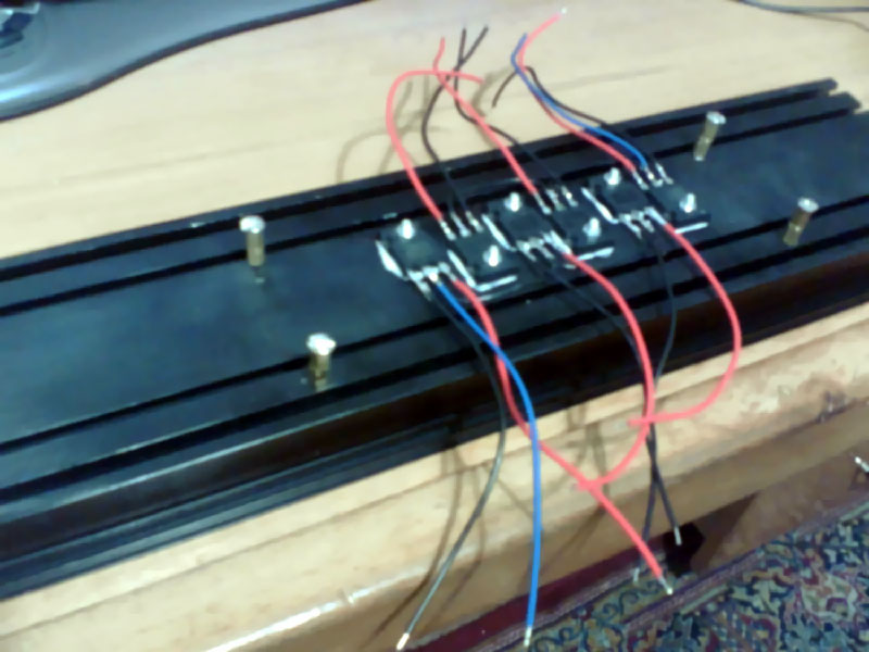

Hi Ahmad,
A few quick questions if I may:
1) It looks like the board is mounted on the standoffs on the heatsink. If this is true, can you briefly explain why you choose to use wires from output drivers to PCB?
2) Are the wire lengths as you have made them in the second posting pic with output drivers mounted?
3) Are your output drivers insulated with something like a mica, silcon pad under? I see the silcon grease. I ask as some people on diyAudio say no insulating pad is needed if one is careful when mounting to an andozied heatsink. Ergo why I asked this question.
4) I cannot see in either of your pics how you will do the T8 - Vbe. I cannot see a Vbe on the heatsink. How are you going to ensure you have a Vbe to correct device?

hi all , and thanks for comments :) ,
It looks like you're going to bring the leads up through the holes and solder to pins on the PCB were the FET legs would normally go. Is that right?
yeah quasi that s exactly wat i m going to do ,
sure i ll keep wires as short as it can ;) thnx .
to John :
1) at first i wanted to mount the FETs under the board and on the heatsink as common , but the grooves on heatsink didn t lemme that , so i had no way but mount FETs on heatsink and connect them to pcb with short wires ,and then mount the pcb on heatsink w 4 standoffs , as u see .
2) yeah the wires are bout 5 inches , as u see i already soldered them to FETs , and ready to solder to main pcb , as quasi guessed i m going to bring up the leads through the holes and solder from the upside of PCB . i hope i got ur question right :p
3) yeah the FETs are not connected to together , cuz of the black color layer on whole heatsink . but i used silicon grease .
4) bout T8 , as i said the whole project is not completed yet , i leave bout .25 inch space between 2nd and 3rd FETs to mount the T8 there , i ll make a hole for T8 there and will mount it w silicon grease and a pice of aluminium as u can see in the pic i attached .and finally will connect it to pcb w short wires ( hope i got ur question right and answered to it , i m not sure i got it right lol :( )
thanks again :)

Hi Ahmad,
I've also read the view of using the anodised layer as insulation, but it is too risky in my view. The anodised layer is very thin and heating and cooling stresses plus the odd knock or vibration could cause it to break down over time. I might be over cautious but I would use insulating pads.
In the end it's up to you, just make sure that you measure an open cct from the heatsink to the FETs drain.
Cheers
Hi Ahmad,
Thanks for your reply. Yes you answered the questions just fine.
3) I have been thinking for lower thermal resistance I might consider a direct mount using the anodized layer as the "insulating" element. You, as I have been for some time, should give serious consideration to quasi's comments with respect to this. I am trying to come up with a "creative" solution that best deal with the issues or finds a "balance" between the concerns quasi raised. This is in part why I am interested in the sonic and stability of the amp by using wires to the module for the output drivers. Part of my creative solution may mean I have to run wires to the output drivers from the module.
;) lol lol lol Why did I know quasi would suggest mounting in such a manner (with no mica or silcone pad, et al) "... is too risky in my view.", "I might be over cautious but I would use insulating pads." Not to worry quasi, you raise very valid concerns in such a direct mount of output drivers. quasi makes a good point to remind you "just make sure that you measure an open cct from the heatsink to the FETs drain."
4) Excellent how you have thought not only to leave the extra space between the output devices, but that you wish to place the T8 Vbe between a pair of output devices. One of the changes I have not done to the modified PCB's I have posted a while back is to open up some extra spacing between a pair of output devices on same rail if someone wants to do as you have. For me I need a bit more space between. I want to use a TO-126 case type for the Vbe to be mounted between a pair of output devices on same rail. I am also trying to come up with a few other "creative" Vbe mounting/thermal solutions. These will likley require increasing the spacing of at least those output driver devices involved.
