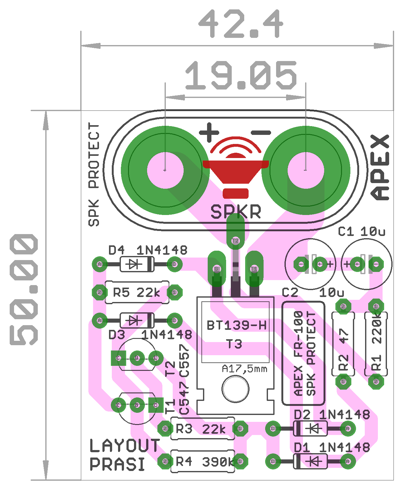

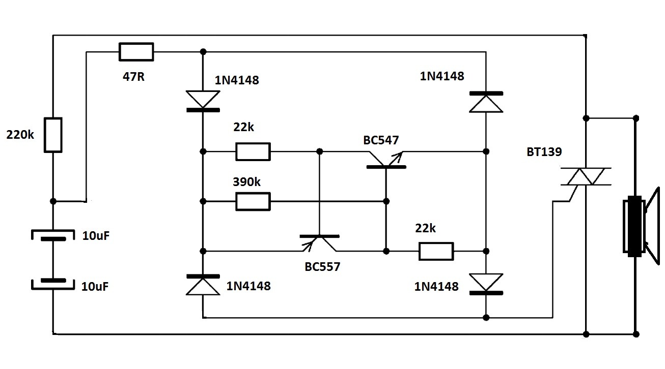

if you not want loose your speaker YESDo I need some kind of speaker DC protection with those amps?
use Triac crowbar, very reliable and cheap
I've found this circuit in another thread - is it what you suggest?if you not want loose your speaker YES

I've spent whole day yesterday reading various articles about that, and here is my solution, added to another thread, to stop hijacking this one: https://www.diyaudio.com/community/threads/speaker-protection-board.377896/page-5#post-6927637Hi Rankot.
