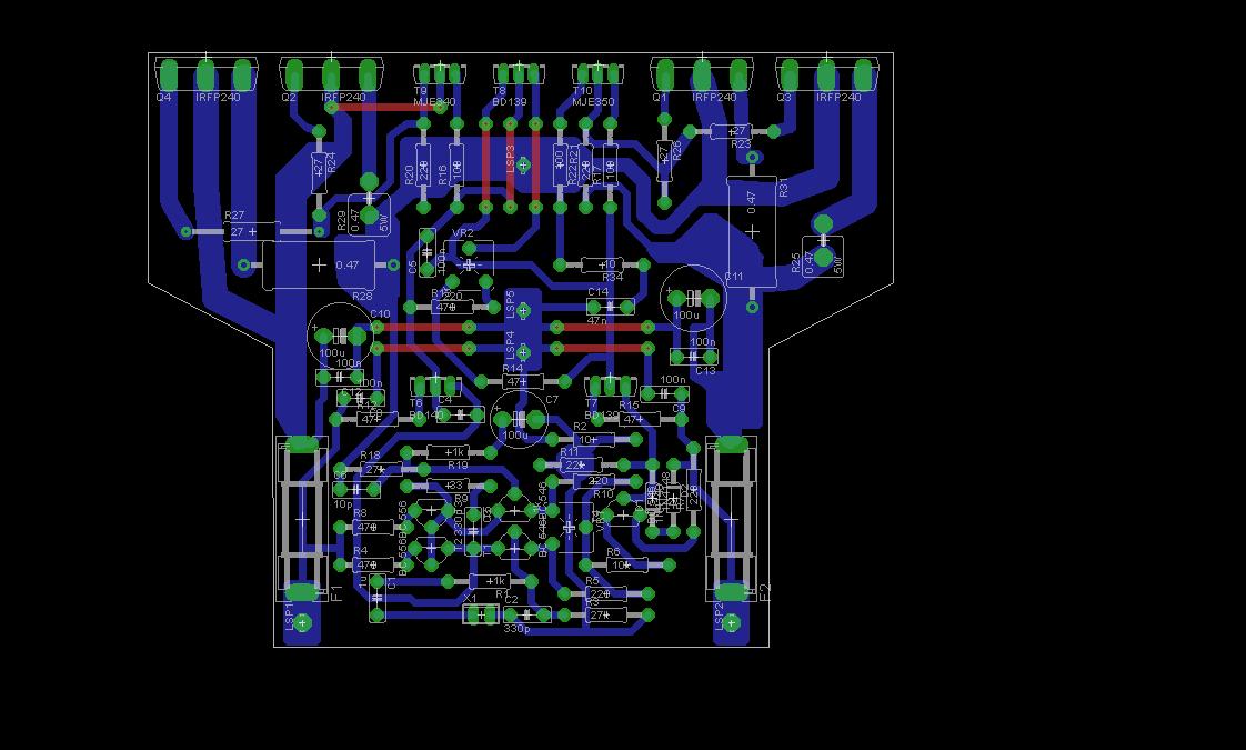

Hi guys,
Here is the PCB of Quasi DC detect with added clipp detection. I hope someone will found it usefull. I found clipp detection circuit on Marshall Leach websait: http://users.ece.gatech.edu/~mleach/lowtim/graphics/clip.pdf .

hi maxente
how is your 2 pair nmos200 .did u made the amp?
can u share the pcb layout in pdf format.
hi nazirdigi
The PCB i use is in the post http://www.diyaudio.com/forums/solid-state/43331-power-amp-under-development-370.html#post2508414
but you can use quasi pcb here is the pcb it's almost the same whit minor modifications and it's working great clear sound
hi maxente

hi nazirdigi
i use eagle software for pcb
i didn't create this version of the pcb i just add another pair of irfp's on it
my version is with one pair irfp 240 and i use v rail of +/- 32vcc 300VA toroid transformer the power is around 50w because of low v rail
i use cerwin.vega speakers 2x200w/8ohm
at high power the heatsink is worm the sound is very clear
you can build this version of pcb with two pair of irfp it's the same compaired with one pair version but do not exceed v rails of +/- 50 vcc as quasi said (you might change first stage transistors and some value resistor if you increase over +/- 50 vcc check nmos350 schematic)
now i wanna build nmos350 version
i have a transformer of 1000VA 2x60 vac and i planned to use on this version because i love the sound of this simple cheap amp
