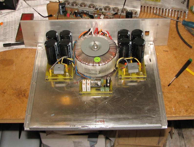

Another in the making
The father - son team are making progress.
Piccie of;
500va transformer, 2 x DC supplies with 20,000uF per rail each providing +/- 75 volt rails.
Shiny 3mm base blate with L bracket supports will be sanded to a nice brush finish.
Next job is to mount the heatsinks with the amp modules, power switch, nice blue LED, input sockets and speaker posts, fan etc.
Sticker on the transformer say's everything is ok!
Cheers
Q
