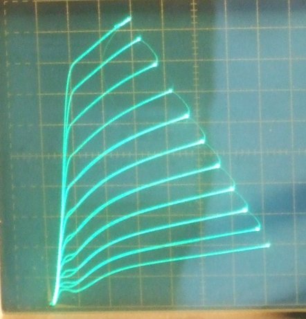

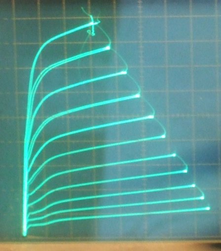

Here are some "Schade" curves for the 6HJ5, which worked well for George earlier. (100 Watt output easily)
(50 mA/div, 50 V/div)
I would say the 300B has got some dead serious $5 competition.

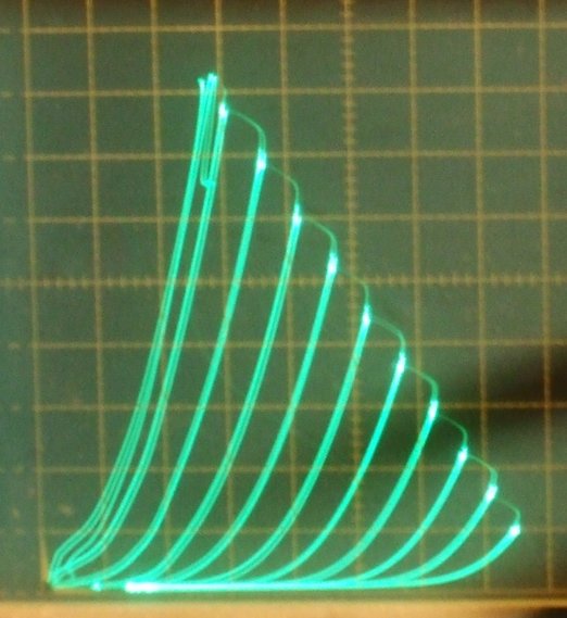

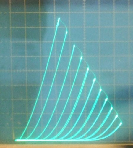

Then for those who would like to make a smaller amp, Schade curves for the 9 pin, high gm, 6HB6 (another one of those $1 tubes, like the 21HB5A above ), 10 Watt diss, probably good for 20 Watts out. The steep curves (low effective Rp) should offer a really good damping factor, even without any global Fdbk.
(20 mA/div, 50 V/div)

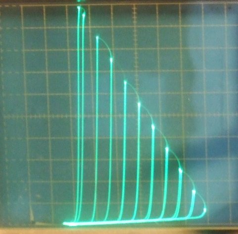

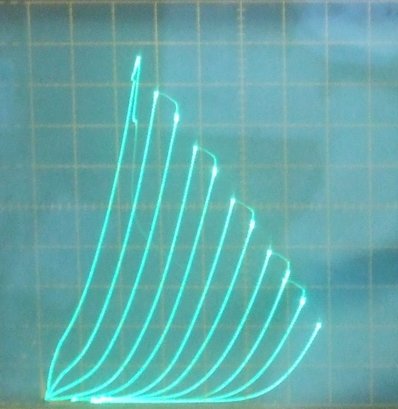

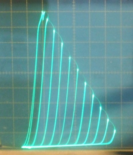

Well, lets see. There's still 26DQ5 around for $3. And 29GK6 for $1. (an EL84 clone) Those $1 21HB5As have jumped to $6 unfortunately. Ahh, but 21JV6 is $3, nearly the same thing. And 21EX6 for $3.
Oh, there are plenty of 38HE7/12HE7 around ($1, were $0.35 in bulk), the pentode in these is close to the 21HB5A, but with a somewhat reduced size plate. And many of the 38HE7 versions have an IC (internal connection) pin that connects to the heater between the pentode and the damper. So you can power up just the pentode at 21V for the heater. The plate Watt dissipation should be OK at 16 Watts then, without the damper diode running. The 38HE7 pentode may also be close to the individual sections in the 42KN6 (the doubled version). Have to get a 42KN6 to try on the tracer yet to compare.
1) 26DQ5 in Schade
2) 26DQ5 in triode
3) 29GK6 in Schade
4) 29GK6 in triode
and for comparison with the 29GK6, the 6HB6 again:
5) 6HB6 in Schade
6) 6HB6 in triode
7) 29GK6 pentode
8) 6HB6 pentode

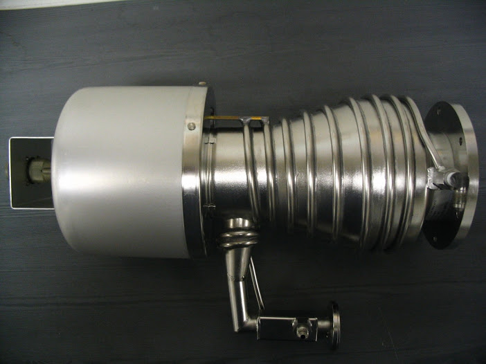

Jeol Oil Diffusion Pump DP 4E | eBay

The $49 diffusion pump is cool, but only one small piece in a hivac system. As with any system, all the pieces must be sized correctly for everything to work. A diffusion pump must be backed up by a mechanical roughing pump. The diffusion pump operates at a high temp, and is basically an oil jet that pushes stray molecules along toward the roughing pump. If the oil is at temp and sees atmosphere, it will "crack" and must be discarded. Our systems also incorporated a cold trap which is a stainless steel flask filled with liquid nitrogen. This freezes any moisture in the system, and keeps it there until the weekly system shutdown and cleaning. Everything is cleaned with acetone and reassembled and sealed with vacuum grease. The roughing pump removes all the air from the system. The system must be at a certain vacuum level before the diffusion pump is started.

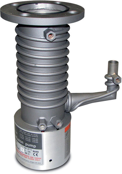

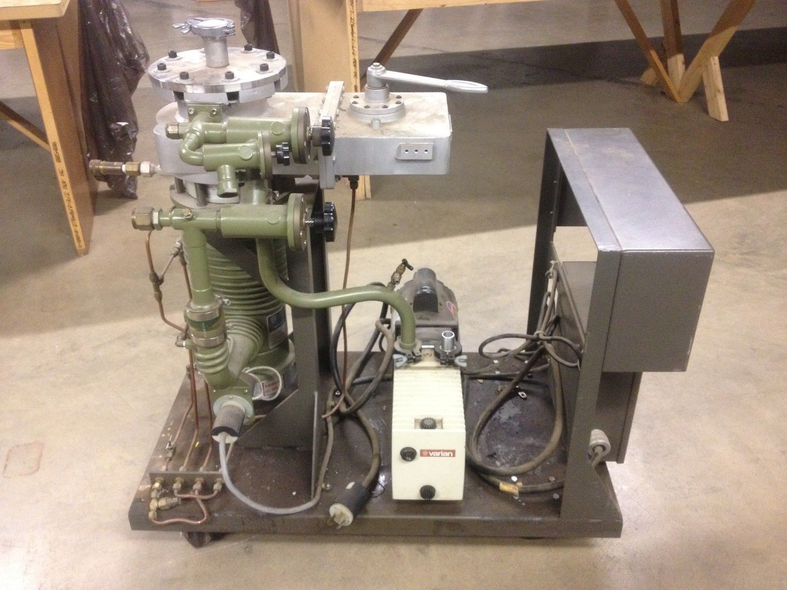

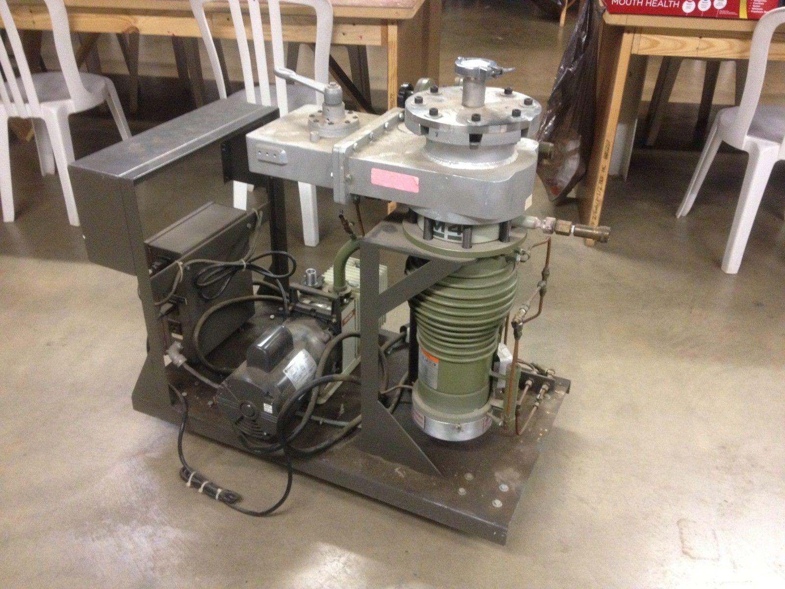

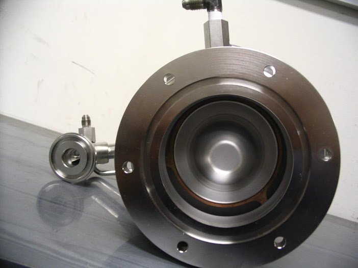

I got a full roll around Varian vacuum cart last year for $400. It's got a VHS-4 diffusion pump, Varian SD-300 (Alcatel) roughing pump, slide valve, baffle, control box and a bay for vacuum gauge readouts. Appears to have been hardly used, paint is new on the diff pump heater, and the inside is sparkling clean. It's about 1000X too big for whats needed for evacuating vacuum tubes, but hey it was cheap. (and the shipping was free, I tied it onto the top of my old kayaking car)

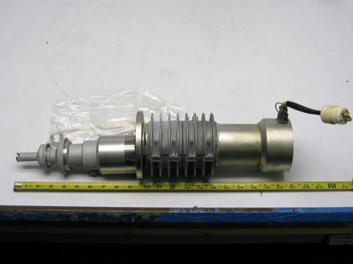

I have some smaller diff pumps, including an air cooled one (Veeco EP-3B), that I have arranged to fit on the cart for more practical vacuum experimenting. (that VHS-4 draws 1450 Watts! And the roughing pump another 1500 Watts for starting) And I've had a small Varian HS-2 pump system since the 80's. Best diff pump I've found on Ebay was a new Torr-Vac 3" made for some government contract, man is it well made and efficient too.
$100, probably cost some taxpayers $10,000
Everything typically uses Silicone DC704 diff pump oil nowadays, so is impervious to air exposure. But still not recommended. Diff pumps just never wear out either and are usually stainless steel. Clean an old one, and check the heater, and you are good to go.
Then there is the whole other technology of vacuum turbo pumps. You can get small used ones for cheap, but typically the high speed bearings are shot. Takes a controller too. The big ones are too dangerous to have around the home. (A screw rolled into an Intel turbo once and it took out the whole lab. Even the small ones are precarious, a sales rep lost his hand once demo'ng a small turbo, when a bearing failed. ) These things routinely need new (expensive) high speed ceramic bearings. And the manufacturers recommend new (expensive) turbo bearing oil yearly, even if its been just sitting on the shelf.

I have a Leybold-Heraeus LeyboDiff 400 oil vapor pump. And I recently saw a Leybodiff 170 air cooled pump on Ebay. Edwards still sells Diffstak vapor pumps. Occasionally see Alcatel diff pumps on Ebay.
And Varian still sells their VHS pumps. Many of the older diff pump manufacturers like Distillation Products and CVC are gone.
I don't think there is any research going on anymore for diffusion pumps. Although, Edwards has an interesting model that only uses 80 Watts. There is an old patent for putting a thermal insulating collar, ceramic, in the casing between the heater and the cooling water coils. I've heard 3/4 of the heat input just goes up through the casing for most diff pumps. Very inefficient. I'm thinking of putting a couple of flanges and a Viton O-ring in the casing of the VHS-4 pump to reduce the power consumption. I got 5 VHS-4 pumps for $50 to experiment on.
Commercially, the market is all Turbomolecular pumps now. Pfeiffer, Leybold Hereaus, Edwards, Varian, Alcatel, and some Japanese and Korean ones. Fast start up and shut down, low power consumption, clean (no oil vapor), operate in any position, and expensive as He_ll. The latest ones use mag-lev bearings. These things run in the 20,000 to 90,000 RPM range. You do not want to bump into one of these things when they are operating.
Vacuum hobbiests like the small diff. pumps and the small Turbos on Ebay. Some have been using low precision ceramic bearings (ie, roller skates) to fix up the old turbos. (they say that works, for a while....) There is almost no market for the bigger diff. pumps. I saw a NEW Varian 16 inch diff pump sell for $8, + $300 shipping, a couple of weeks ago. Need a stainless steel hot water heater?
http://www.ebay.com/itm/VARIAN-DIFF...D&orig_cvip=true&rt=nc&_trksid=p2047675.l2557
