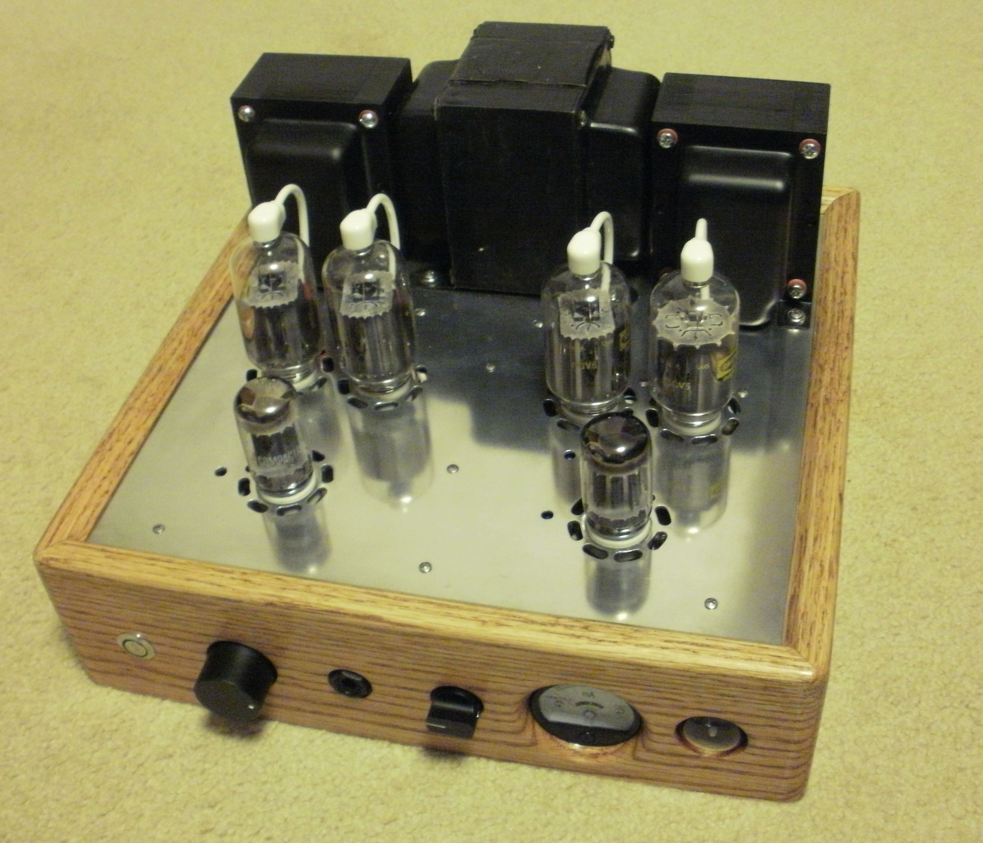

This is my version of a sweep tube amp using 6GV5's. Good little tube matched with 40 watt hammond iron 6.6k. Very similar to the big red board, but I based it on the Compactron tripple triode for the first and LPT stages. I'm not pushing over 30 watts (triode mode) so the iron is ample. I have another designed and part fabed using 6LB6's with 60 watt iron. With 600 V B+, George was able to get out 125+ watts/channel so the iron could be boosted to the 100 watt hammomds etc... not much of a price difference.
My Version....

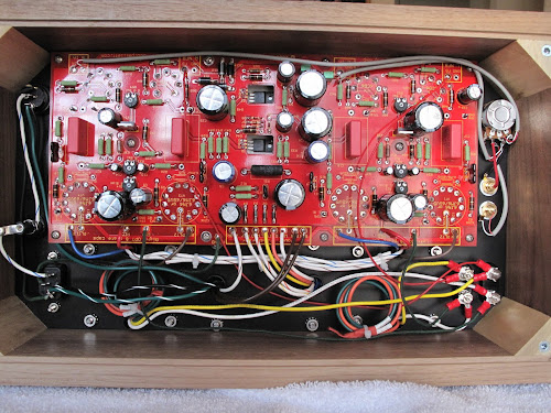

Here's my version: I built "stock" - using a Hammond walnut chassis, FPE top plate. I did break out the AC input and fuse - had parts on hand.
Note - when I took photos the feedback wires were wrong (corrected).
Things I would change:
1. Move power transformer slightly, relative to the main board - I had to nibble the transformer mounting base a bit to accommodate the screw for standoff.
2. Make the holes for preamp tubes smaller - if I build again will adjust FPE file accordingly.
Sound: fantastic with a pair of B&W's. Have also tried with vintage KLH's.
I'm using a vintage Marantz receiver as a preamp - also have tried a Hafler DH110. Both sound great and have good phono sections.
Link to album:

By the way, I have a question: I had to rewire some things that doesn't appear in my picture to have my amp working as I wanted to. Basically on the picture my pilot lights are wired in parrallel on the relay outputs of the small remote PCB. They were dragging too much current and my relays wouldn't work. So I had to wire them directly onto the small 5-0-5v transformer I've added, trough the relays. For the NFB no problem as I had two spare contacts. But on the other one, which is wired in the picture so as to cut both 280v and 50V taps out of the xfmr, I had to remove the 50v taps and put my pilot lamp instead.
So now I have a relay that can switch the 280V on /off while the rest stays alive.
I was wondering if this could be harmful for the amp?

Is there a problem having a relay turning on and off the 280v supply to the red board, while the rest stays alive (50v and 6.3v) ?
This is how my board is wired so as to have a "standby function". For now I'm not really using it cause i'm not sure this is good for the amp...
As far as I understand the amp schematic, this means my Bias and heater voltages are staying alive while the B+ is shut down.
Please help!

This is not a problem and is fairly common. I would not leave the amp in standby for long periods of time (days) because it can cause a degradation in the cathodes of the tubes. This was discovered in the early days of vacuum tube digital computers. The tubes were either conducting (a digital one) or cutoff (a digital zero). Tubes that wound up cutoff for long periods of time died faster than tubes that were full on a lot. Special cathode coatings were designed for this application and it is noted in their data sheets.
