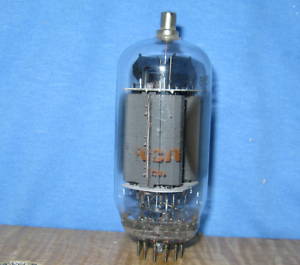

Do the doubled up guts in those 6KN6 tubes look like any tube you have ever seen before?
No and the plates are close together. This could lead to hot spots.

I looked up some images of two the 6KN6 versions. Looks like the dual version is a custom design, never seen any long skinny single pentodes like that.
The two plates are actually stamped from a single sheet and they are joined at a common seam. I bet that is where the glow starts. I am guessing that the reason for doing it this way is to allow two cathodes to support the high peak current. After looking at all 18 tubes it looks like these were a nightmare to assemble so the dual design was abandoned. Some have obvious alignment issues. They won't live long.
