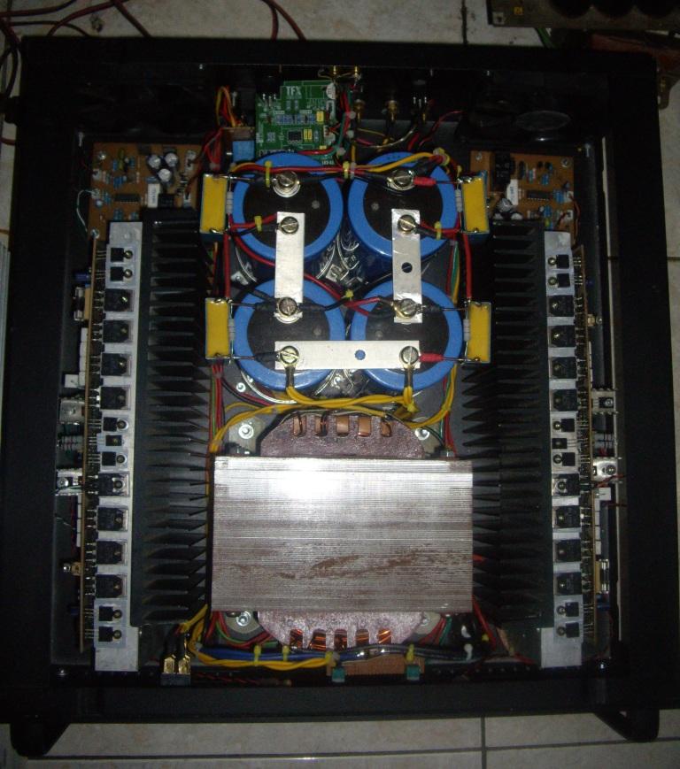

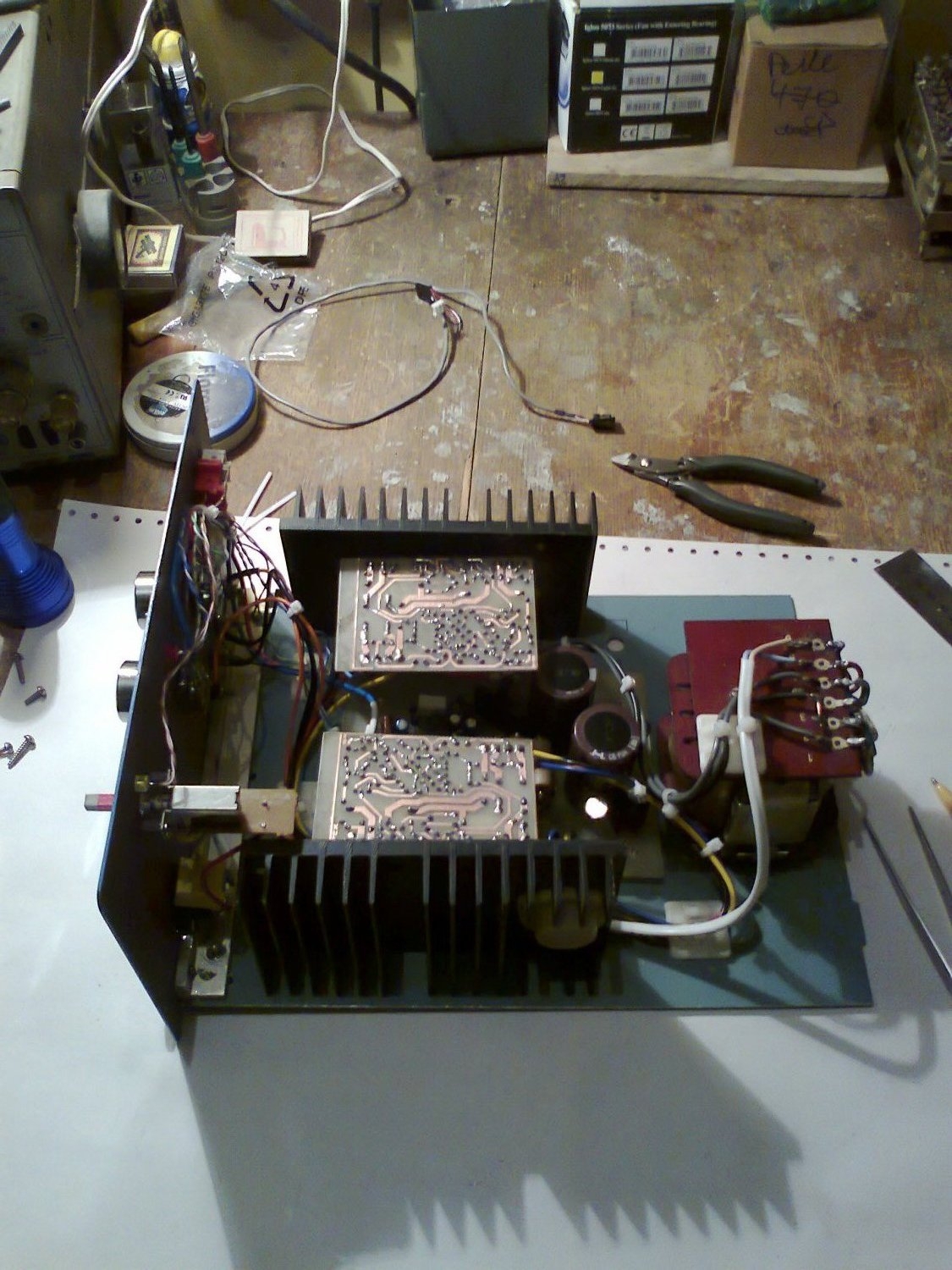

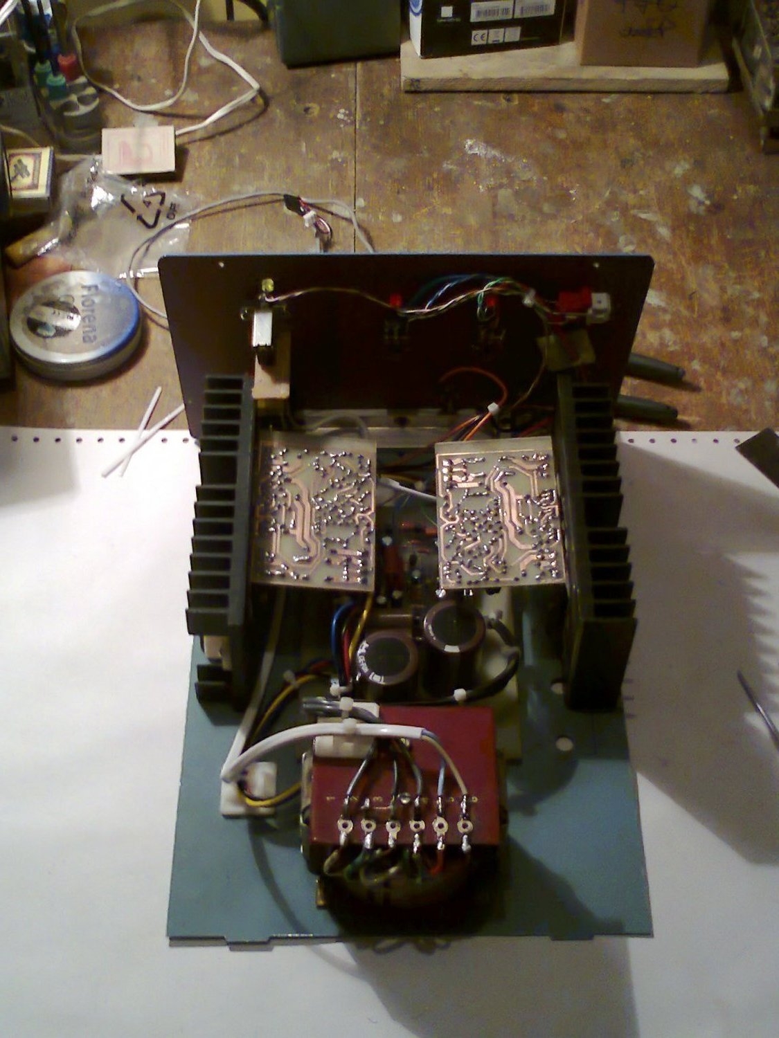

My amplifier testbed.
Currently got a class d amplifier installed on my testbed.
Note crocodile clips to apply voltages.
I use an old blown up ebay amplifier chassis as a testbed.
Cool. Ive been looking for a good way to isolate transformer vibration from the casework.
I was aiming at this direction when thought of this solution after finding these rubber rings in the junk parts bin (junk pile?!)!

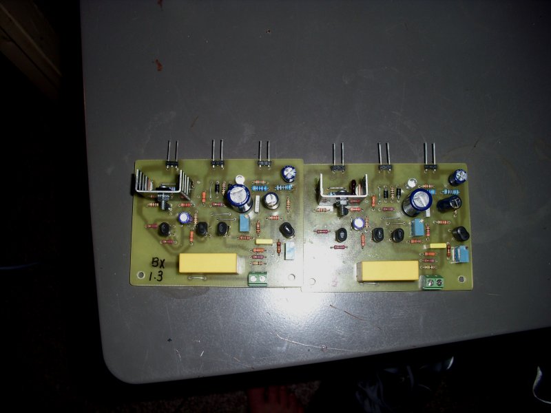

FINAL MONGREL (1 of 6 pairs) whew!!
Just got through in the "trenches" , 5 pairs for the friends and neighbors , one for me (below) Thanx to Alex MM and his libraries for the SPRINT LAYOUT. Best CAD out there to make the good stuff , no ugly amps anymore !!
I'll show the little brother of this one next (PB60 X2 stereo board).
First photo is the whole stinkin' deal... absolute headroom and fidelity.
photo 2 - The fidelity , the AX ... all TMC (no Xover distortion).. sounds like a 250w class A amp. Don't debate it , accept it. (-150db H5 for real) modular hookup , can A/B 2 amps in seconds.
photo 3 - a VERY close runner up , the BX ... it is like Destroyer X's FINE ES model , beautiful, non- fatiguing soundstage. Bootstrapped current source for that "old time sound"..
photo 4 - they all plug into this .. 4 pair of the matched NEW onsemi NJW21193/NJW21194 BJT's (small to-3p versions) , board is fed from the center .. both input (75-0-75V rails) and the output. 200w@8R/350w@4R- 24/7.
1 1/2 gallons of acid. LOT's of amps..

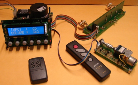

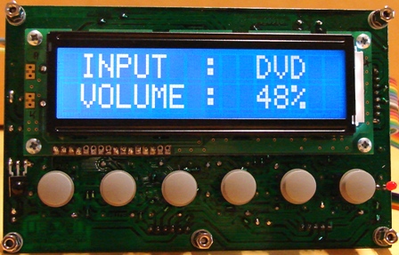

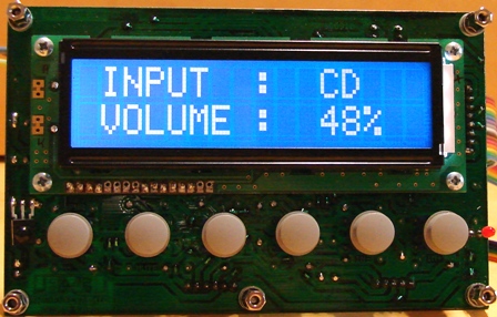

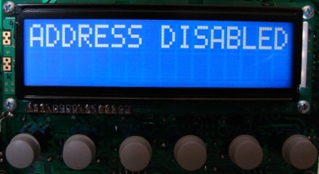

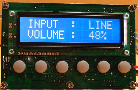

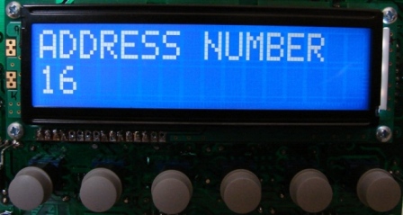

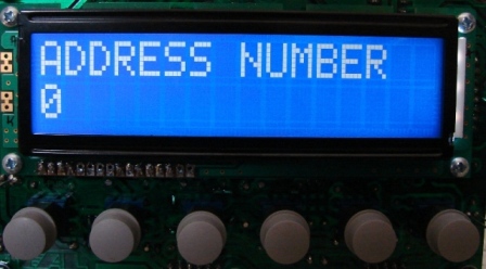

Upgrade of remote control unit
Just before 2 days i completed the code of MCU by adding a "software address setup". I did as well some small corrections in "Delays" of interrupts. Now the unit is complete. Modes of operation:
1) Management of Latching or common relays for input selection, mute and power supply activation.
2) Up to 6 inputs or 5 + Monitor/Source for tape recorders.
3) Display indications are modified according to inputs.
4) Your Logo can be added for displaying in LCD during power-up.
5) Any programmable remote control handset can be used. Philips handsets are recognized directly.

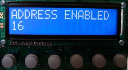

6) Address decoding can be modified from 0 up to 31. It can also be Enabled or Disabled. All of them thru the use of switches mounted on the control board. That is the "software setup", no use of external hardware like jumpers. By default, address is set to 0 (TV) and is disabled.
It can also be used with "Lightspeed Attenuator", directly, without any modification.
offer from your friend Fotios. The hex file for the PIC16F887 mcu, is available to anyone who requests it for free!!!
If you have a programmer that supports this mcu (MPLAB ICD2-ICD3, PicKit etc.) simply contact with me at eal@dra.forthnet.gr. Write me your option for input indications and your logo. Ready programmed PIC16F887 are available under request (not for free, cost is about 15 euro included packing-postage-PayPal fees worldwide).
My webpage is under transfer to Freehostia (economic crisis = lack of money = free web hosting ), so you should be patient for 2 or 3 days to you can get again the schematics and PCB layouts.
Is anybody out there to organize a group buy for PCBs and parts?
Some pictures indicating additions:
