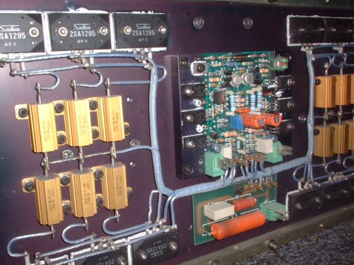

That's some nice P@P wiring

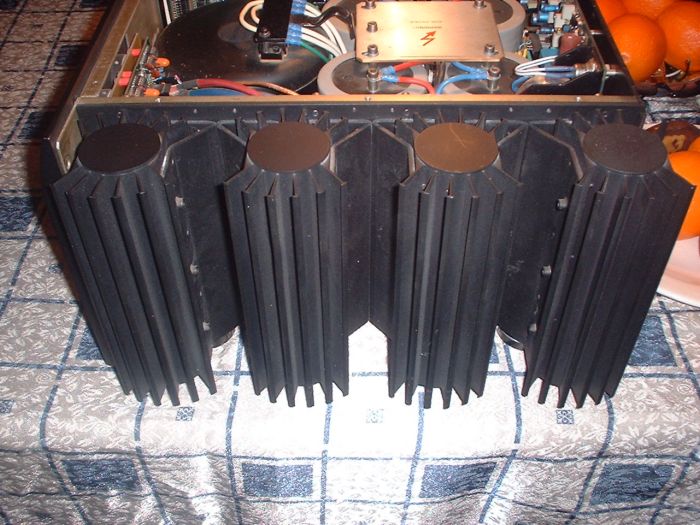

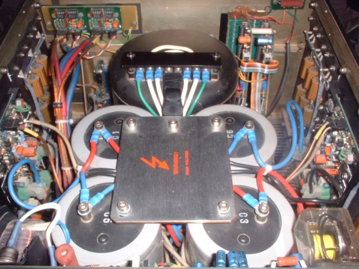

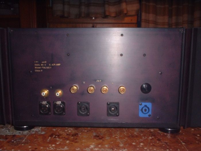

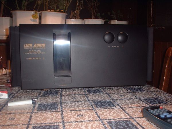

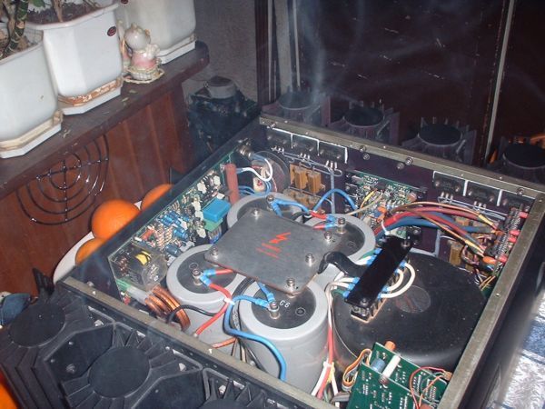

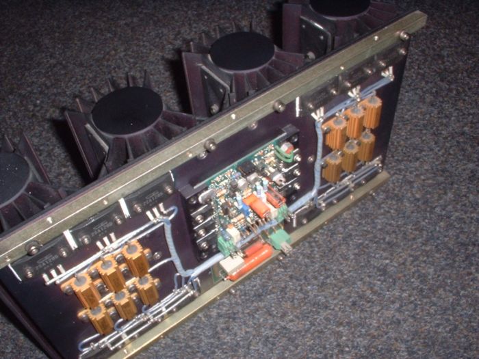

zeonrider said:CH+Heats.
This all good pictures are for all good people on this Forum.
Regards zeoN_Rider
