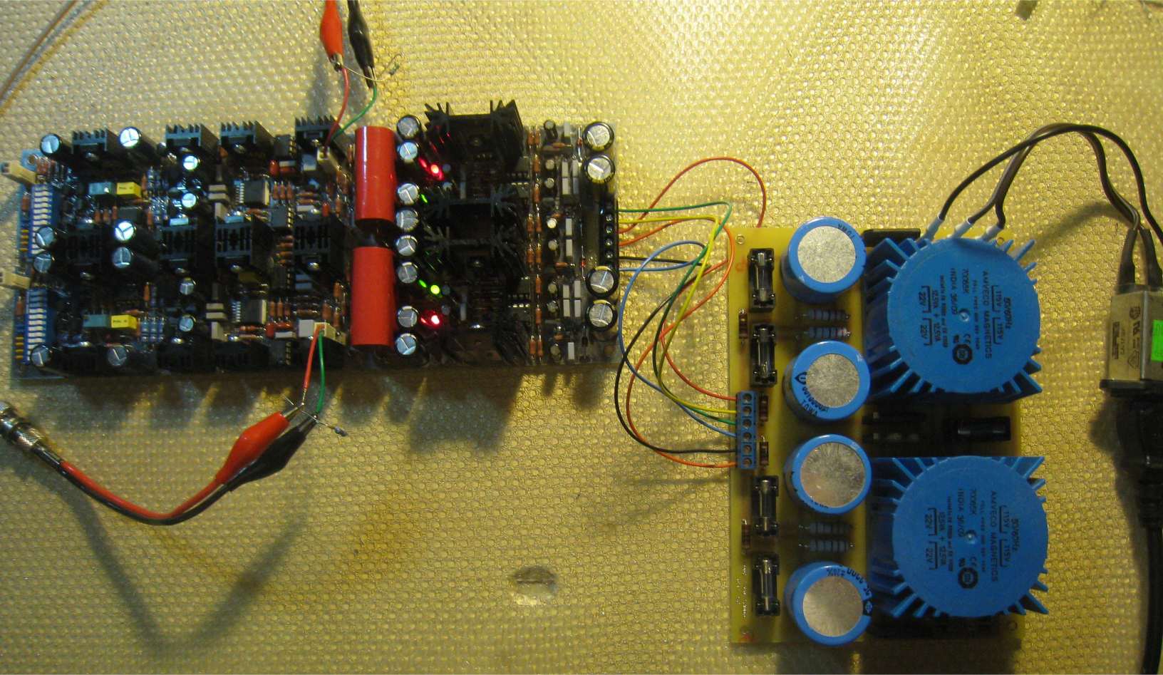

I'm not sure about what you mean re: OPA552 and Rg. I also think HPS4.1 will sound different to HPS3.1 and I'm really excited about doing some listening tests. Sometimes next week, after the Christmas dust settles I have to drill the steel case.

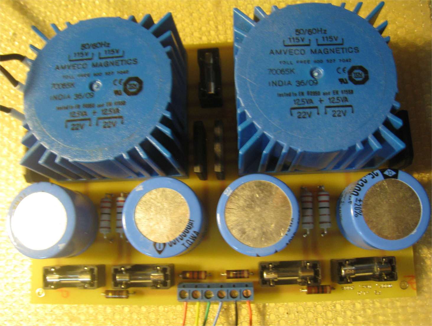

Meanitme, I have decided to do a PCB for the raw power supply (rather than using perf board and wiring as in HPS3.1). See the attached pictures.
Testing went very well, 0.28-0.3nV/rtHz and 0.008% distortions at all frequencies and output levels up to 40Vpp. I also got only 25uV output hum (input shorted), before even throwing everything in the steel case. This is an excellent level, equivalent to 2.5nV input hum. It's actually a little better than HPS3.1 in the same stage (before case), probably because of a better layout of the input stage. But the key to low hum is the dual mono construction and the ground loop(s) handling, as described on my web site under "wiring".

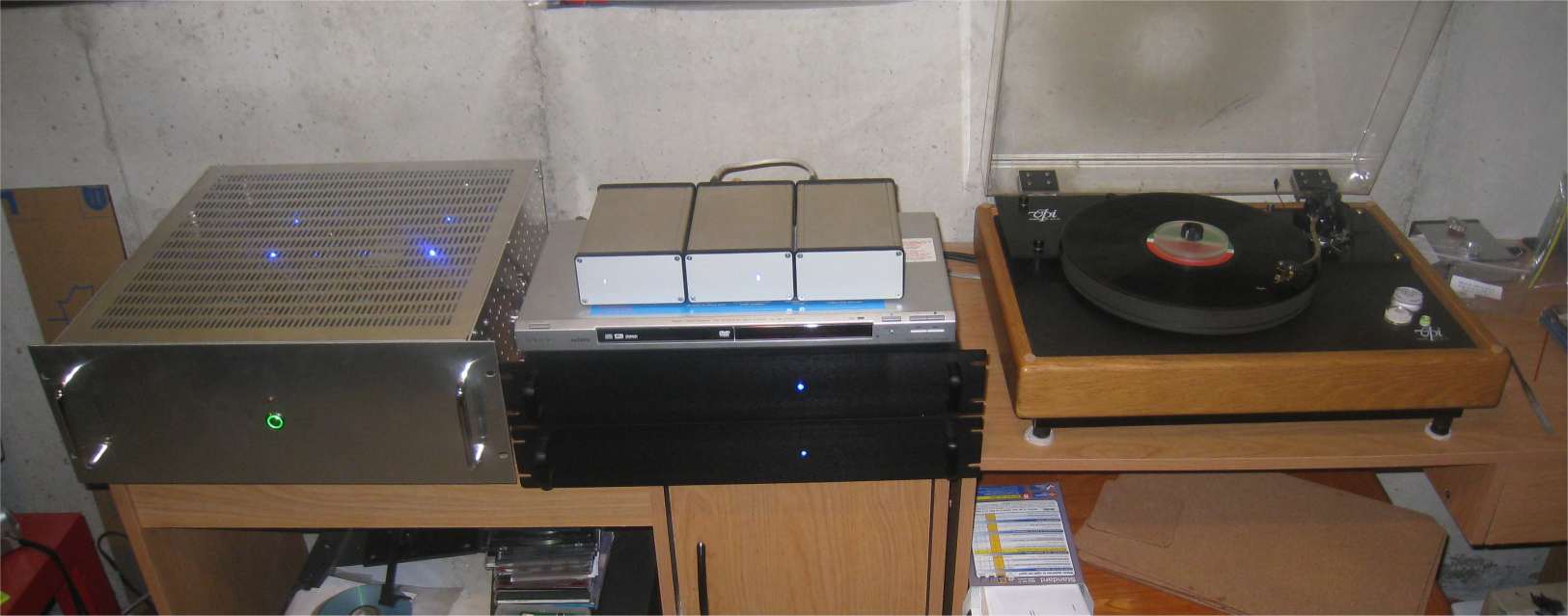

Here is a photo of my first DIY - AMP, Carlos' DXAMP.
Driven by 2 torroids with 160 watts each, a soft-power-on circuit, a slightly modified version of Greg's PSU, Carlos' PCBs with SANKEN
transistors and speaker protection circuits (so the speakers do not "plopp" during PowerOn/-Off any more).
It looks a little bit chaotic inside with all the wires running front to back and since I did not find an ALU chassis I built one out of MPX.
But looks doesn't matter to me.
This amp rocks and sounds divine.

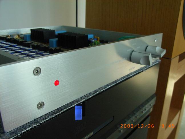

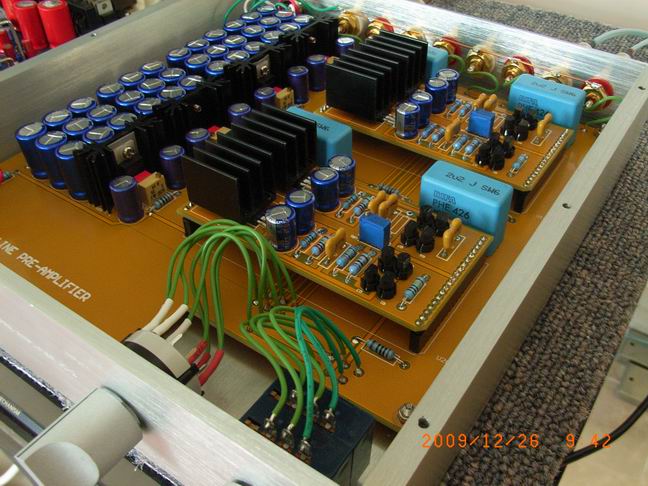

Very Nice metal-work and PCBs HKC.
On picture two it looks like the cooling fins are too high...is it an optical illusion or..?
Hi Nrik
The fins are just about 3mm distance from the top plate.

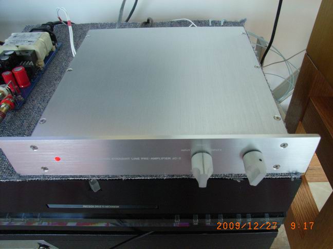

HKC, where did you get your enclosure? Self made or did you buy it in?
Very nice looking project!
Hi Bonsai
I designed the case to fit the pcb and custom order from a manufacturing house in China. It is made of 6061 Aluminum.
Best Regards
Gary
