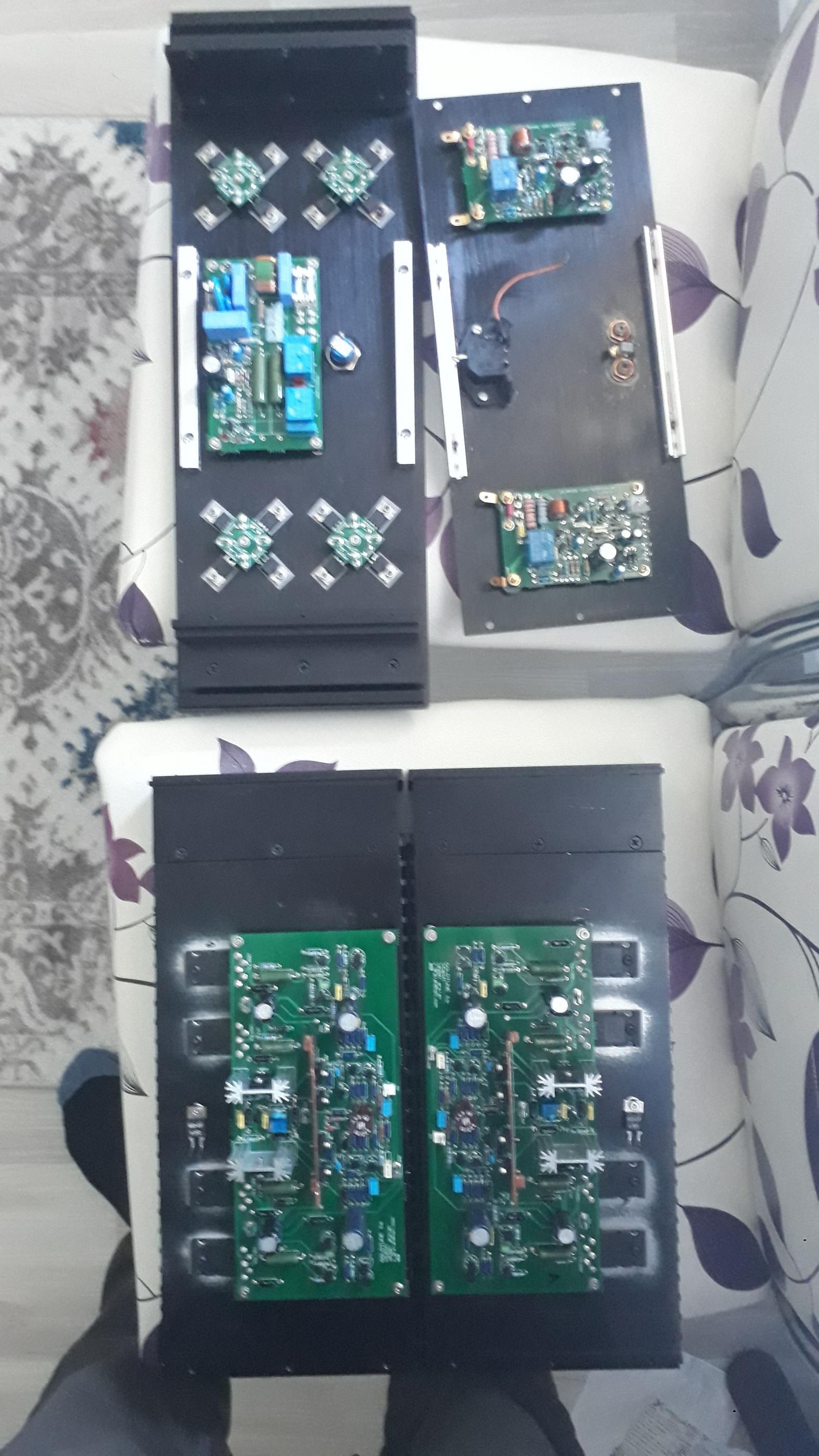

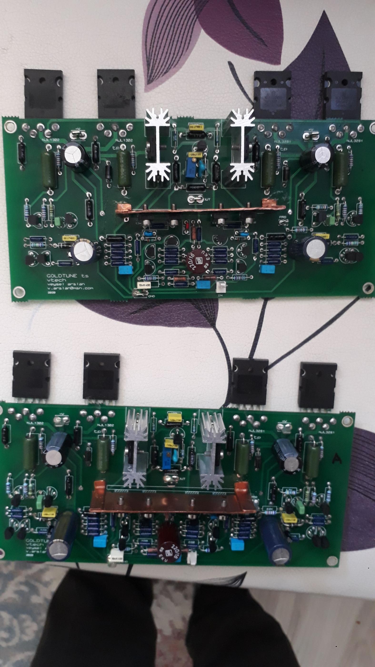

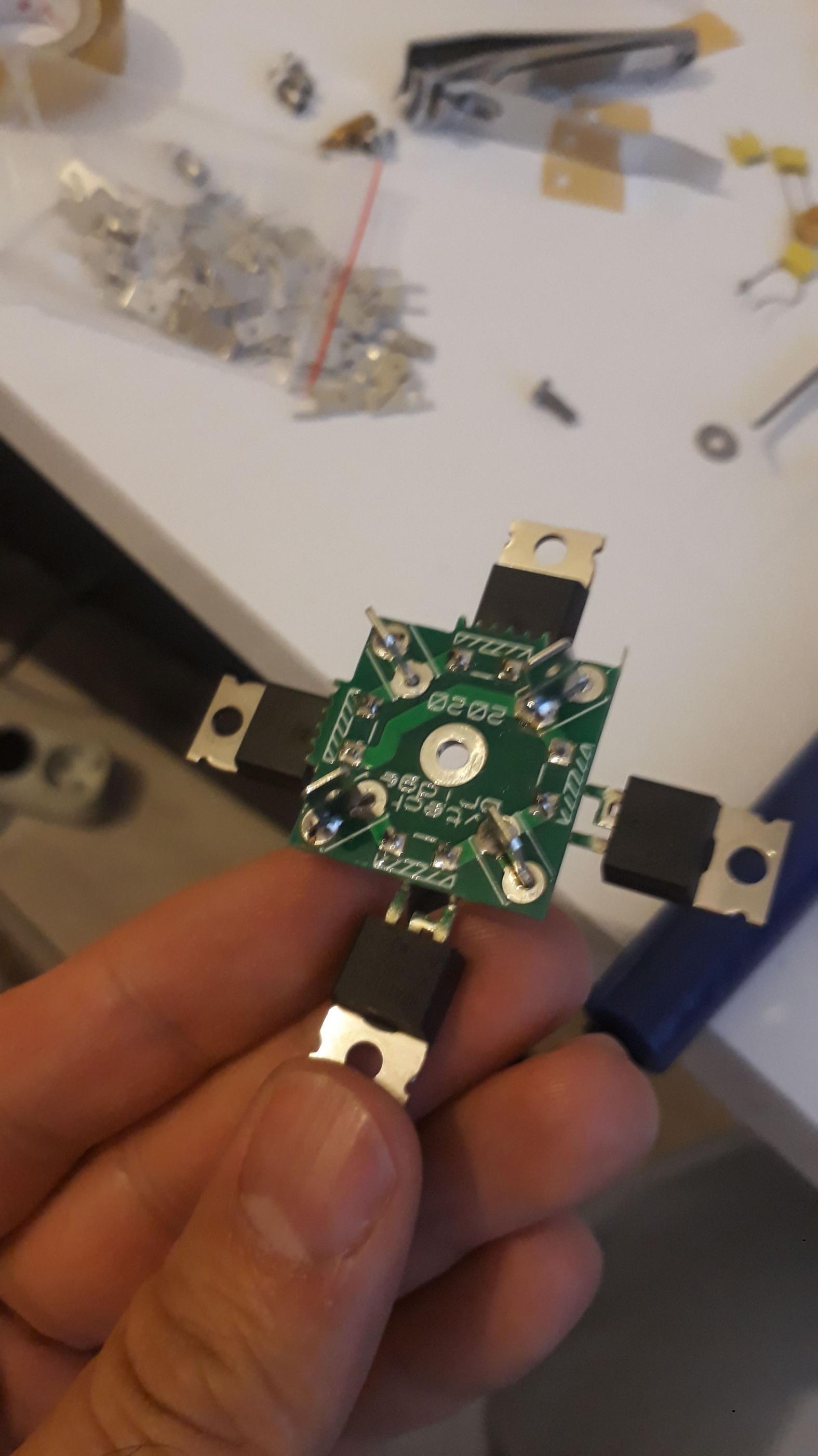

Today I received a package with PCBs.
Actually you did criticise and sort of attack and your opinion wasn't constructive. You didn't ask the right questions about the build and only made assumptions
Your built boards and design I couldve ripped into, but this is DIY audio, each to there own and to discover there own way. About time you got some proper pcbs, I'd like to see where it leads you.
Go big on the power supply
Nice build Vishalk. Very tidy. I'll study that later for tricks and inspiration when I get around to a Class A amp.

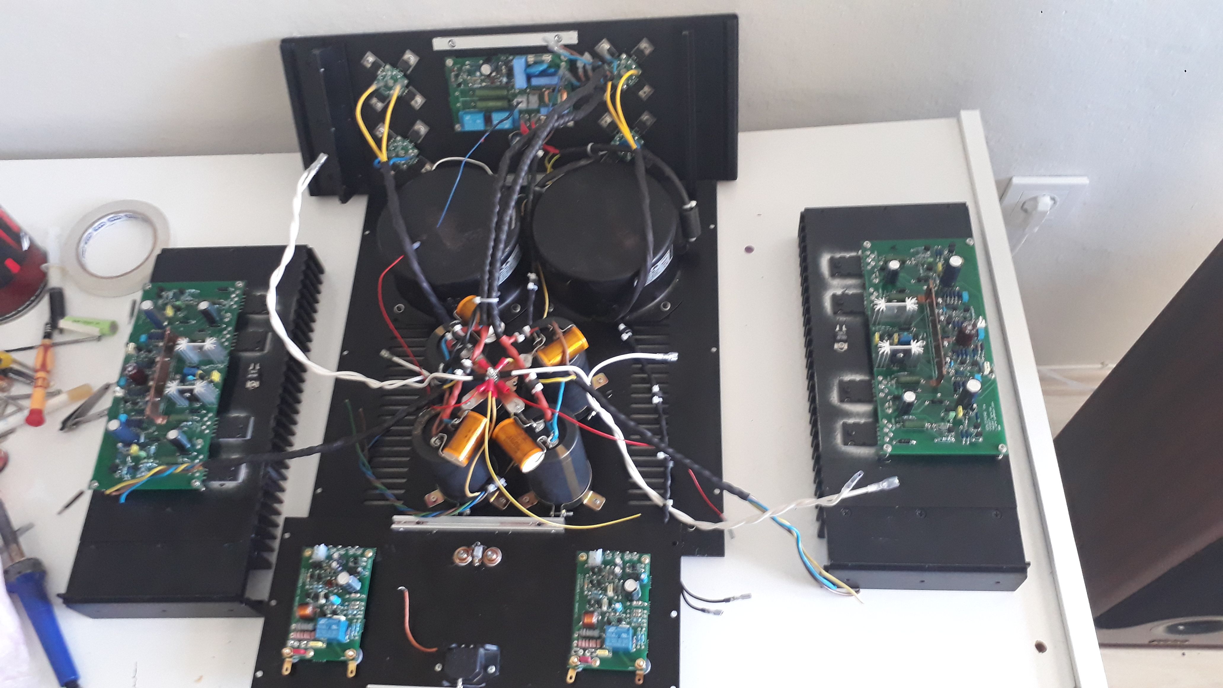

Hi all,
Regarding Vishalk's build and trannies. This circuit is Class A and dissipates about 80W per channel, 160 total. Rule of thumb per Linsley Hood is to derate trannie ac specs to about 65% for dc. Thus 225va would be the minimum warranted.
Next this is continuous draw. To prevent stressing the trannie to the max and it getting to hot, a margin would be prudent. Hence 300VA would be reccomendable for a stereo build as a minimum (take in to account ac line fluctuations etc).
500 VA per channel is overkill but does not hurt. The trannies will be less stressed reducing fields etc. Furthermore, the psu has some series resistance following the diodes. This somewhat reduces peak currents. This in combination with overspecced diodes will reduce stress in the diodes keeping the signal cleaner with less ringing and sidebands and emf. (not to fond of the psu cap bypasses in that aspect)
Psu capacity is large but not uncommon for a circuit like this. Hiraga specced more...
