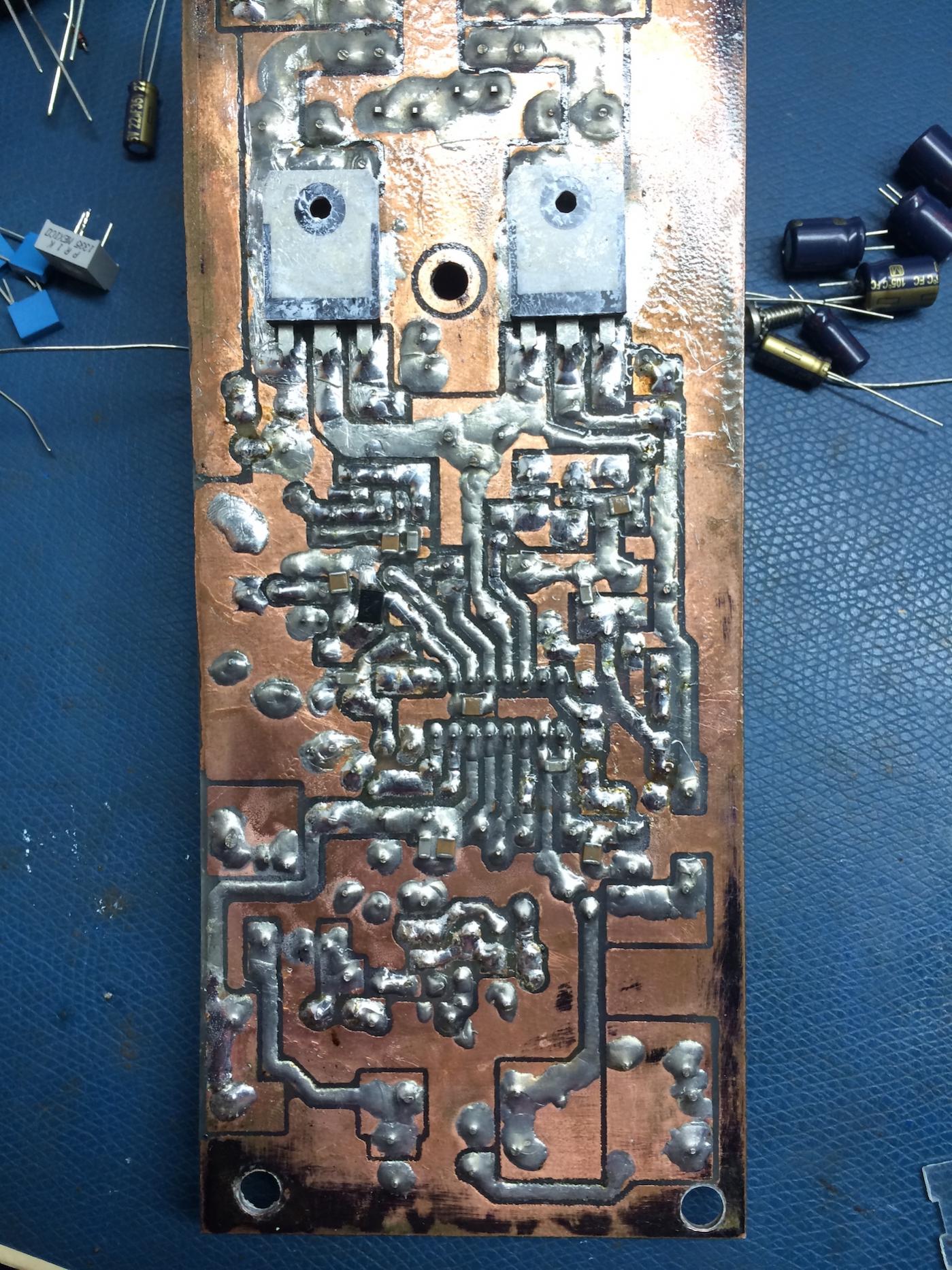

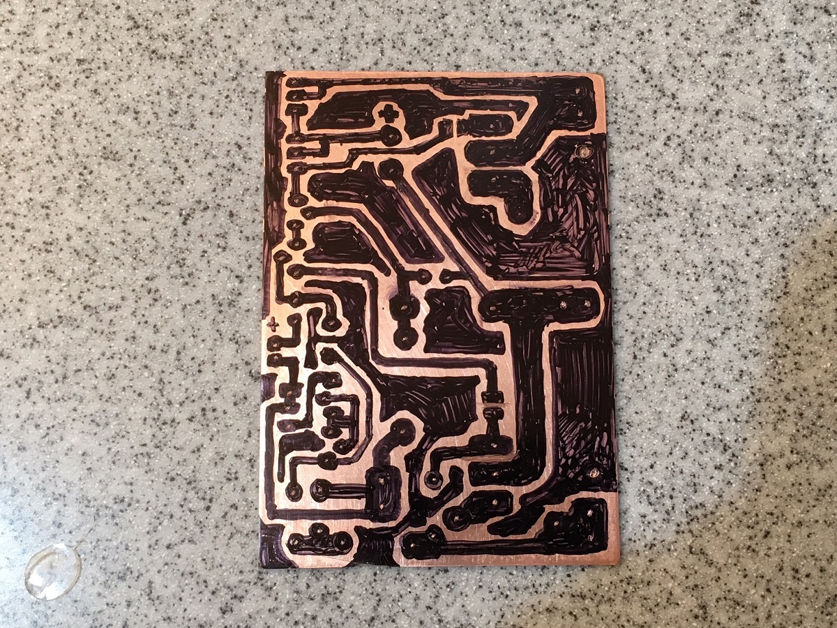

you left the copper int the acid for too long / overexposed it?
Better paint the exposed copper to avoid shorts when thinks drop on it.
I got PCB boards made in China. But the first generation I made from scratch like you did. Had more time to spare back then.

No, it's just that I was using a Sharpie marker as resist and I was running out of ink. Those large areas are just there to preserve the acid from etching too much copper and getting wasted. It's just a very rough prototype to prove concept and next step will be to use a better PCB with laser printer transfer. This amp was built in 5 hrs start to finish so a bit "rough" looking but sounds and measures great.
first one I used paintbrush. 2nd one photoresist and printed on foil with laser printer, removed layer for holes, so the drill bit is centered. UV face browner for exposure. Exciting, when a 14 pin IC did fit. 3rd one I got done at futurlec, cheaper without print, so the copper layer wasall covered with tin, gor some more conductivity. Recent one at 1stpcb, 50ct per board, if smaller than 100x100, posting cost more. Just too busy to do it from scratch and get it done in China is cheaper than just the photo resist in Oz.

I used to draw the pattern on 1/10" graph paper, then punch the lead centres. After cleaning the PCB, I'd use bluing ink to create the pattern. Component leads always fit perfectly doing it this way, and all I had to do was literally connect the dots.

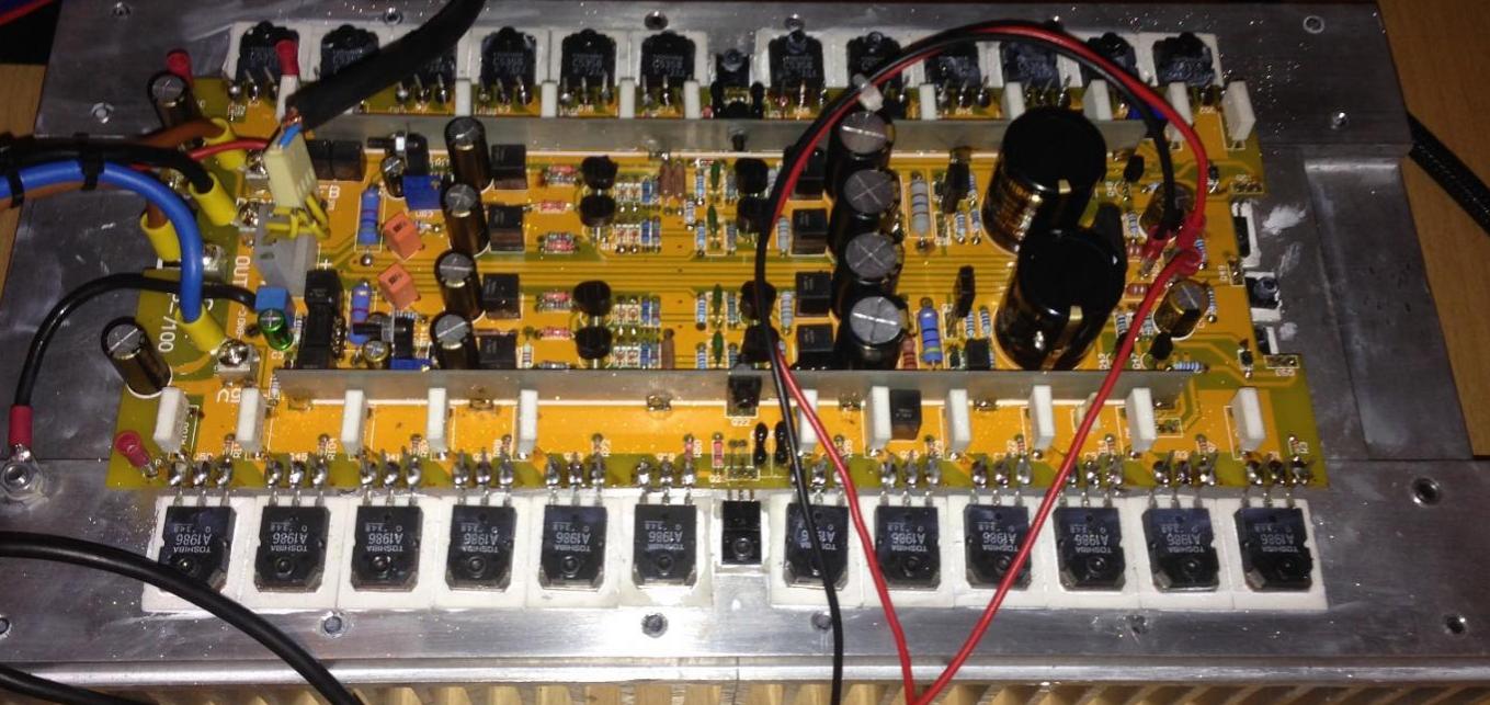

2X250/8Ω,2Χ450/4Ω(first 40W/8Ω classA)400W idling!
10mosfets per ch.
2X1kVA toroids

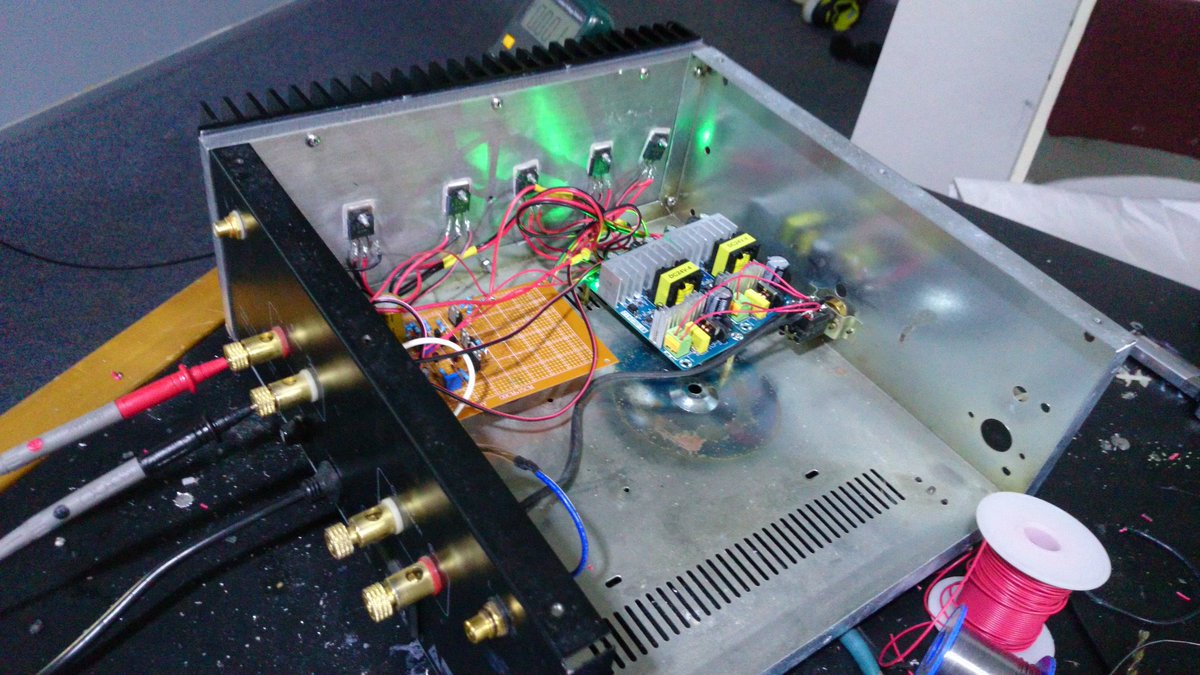

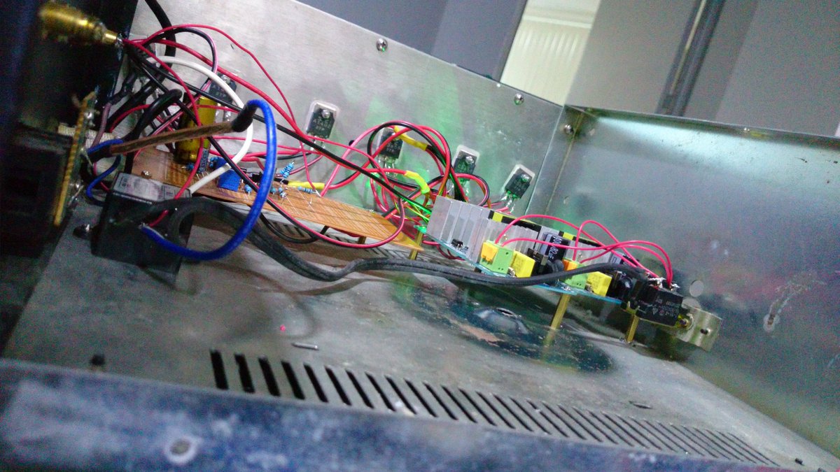

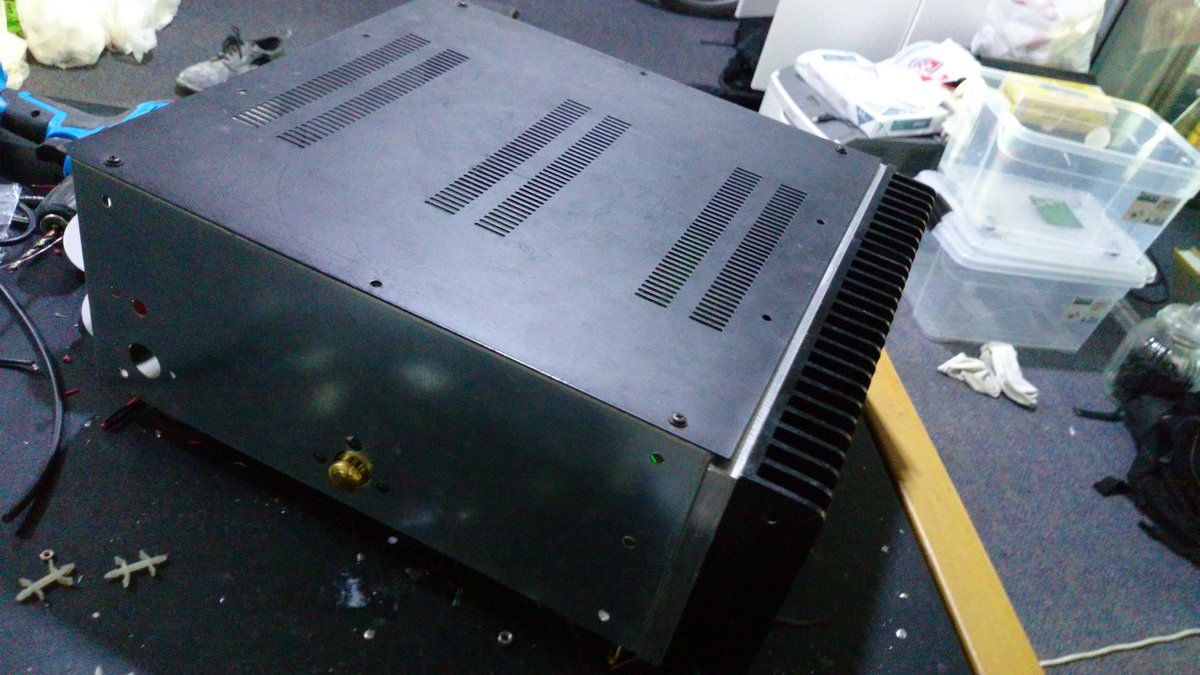

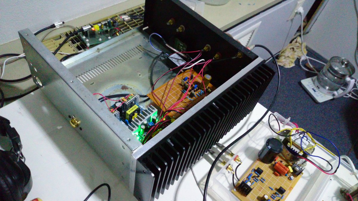

I have orignally posted pictures of my amp in my thread, but I wanna share again
It outputs 50W class a (25w RMS) The idle current is 2.5Amps, runs on duall 24v and consumes about 120wats. The maximum power output is limited by supply voltage.
The amplifier orignaly runs on duall 50v and the circuit has been refined and tuned to run on duall 24v.
The sound quality is very good, I had built higra super class a before, compared to this amp here before at duall 50v and class ab. Reckon even class ab sounds better than highra class a. Very good sound.
I still have the other channel to assemble, and have a upcomming project for holidays. where i do a duall 36v of same amp, but with a larger chassis and higher power output, and uses 6pairs of transistors instead of 3
The noise of the 2x24v is very low, no sound can be heard out of tweeters when no music is playing.
The amp is pure ocl, no input and output caps

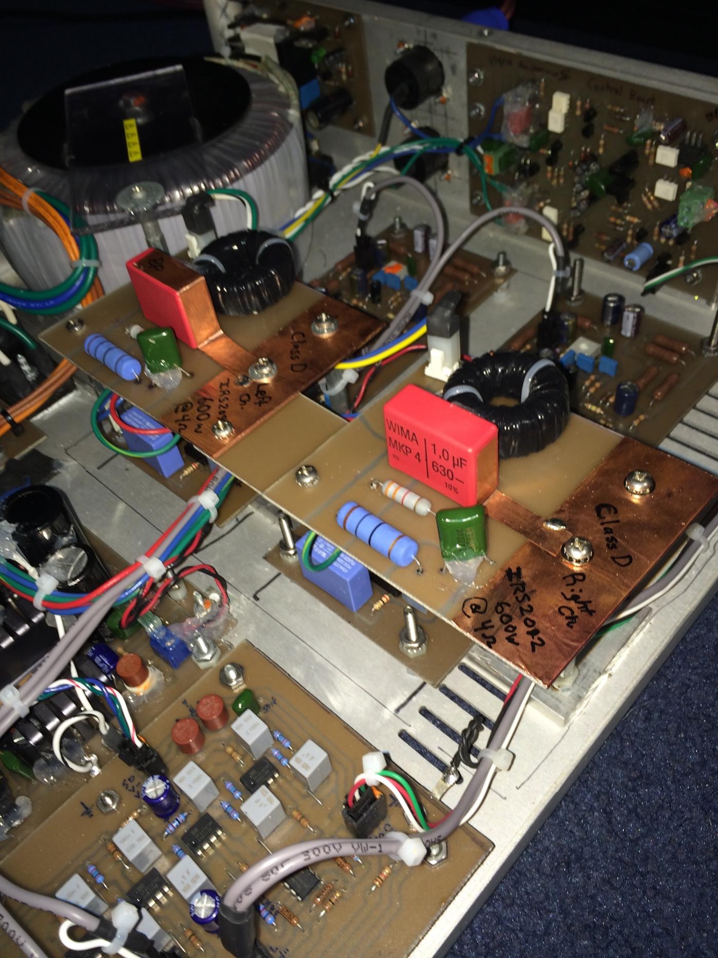

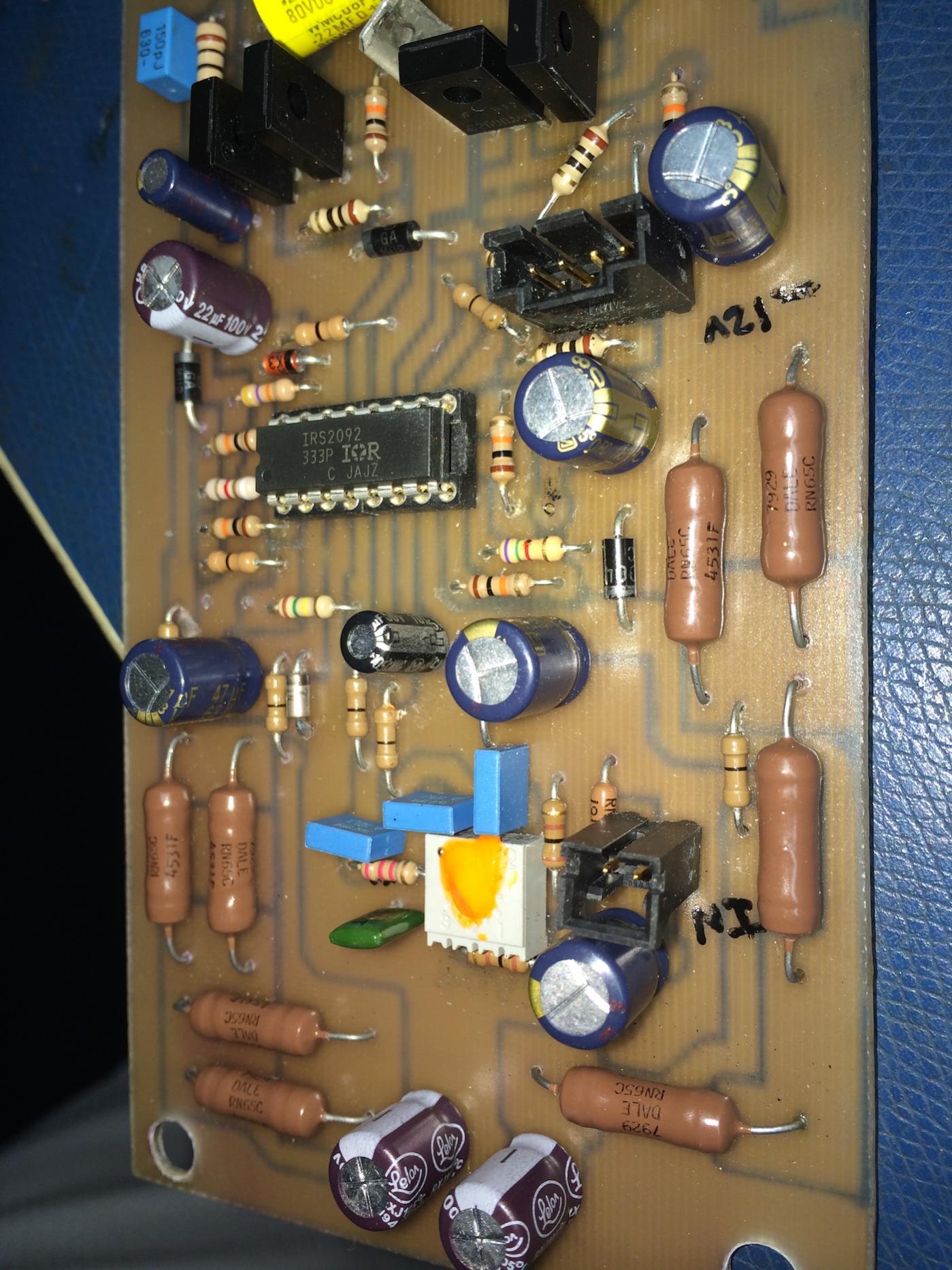

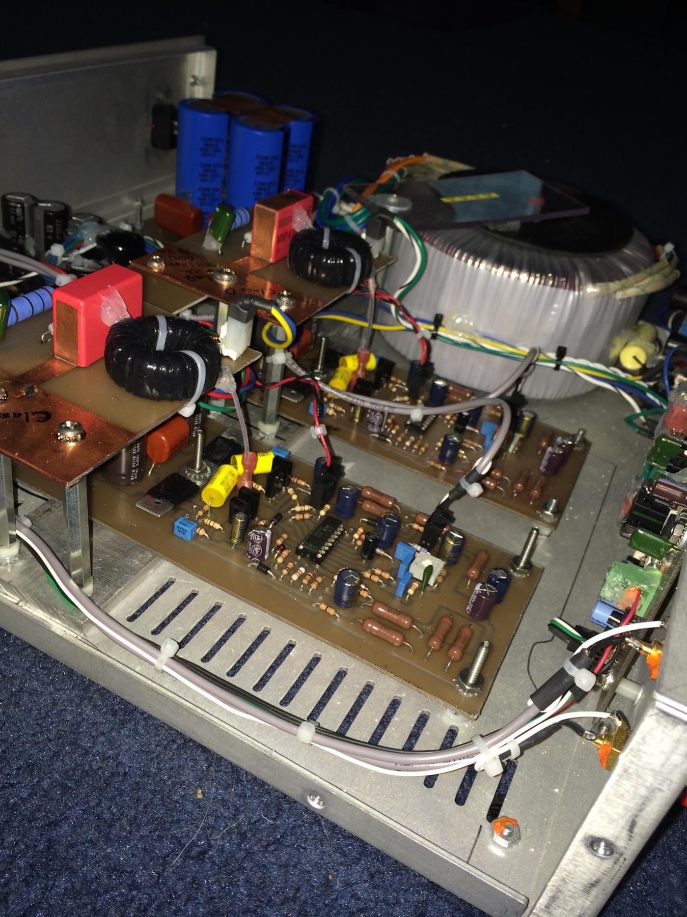

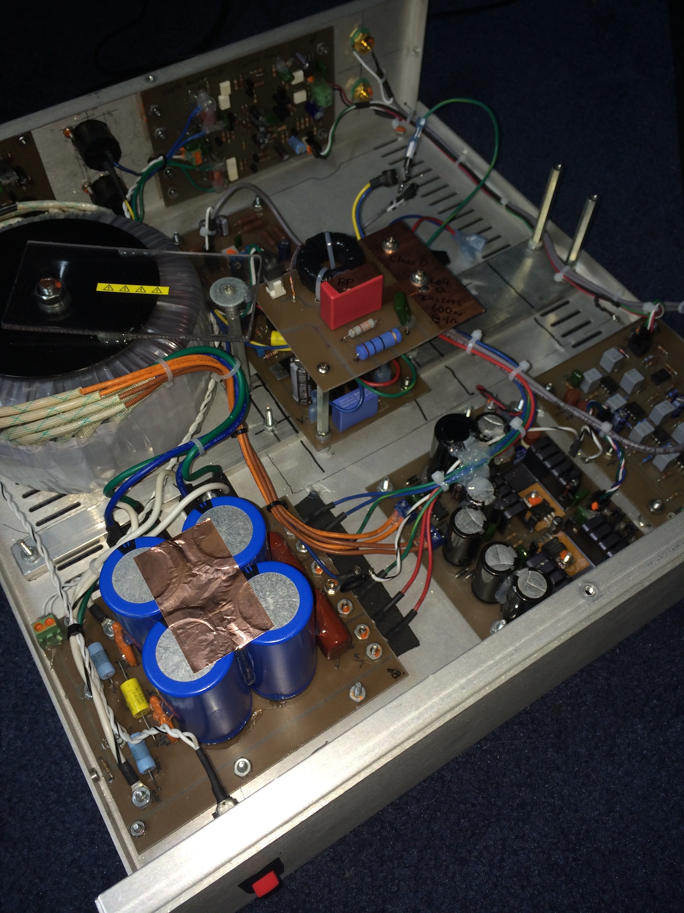

Stereo IRS2092 Class D Half-Bridge Amplifier

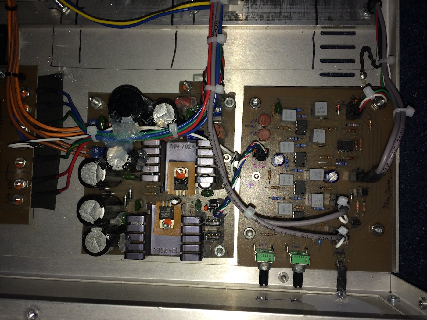

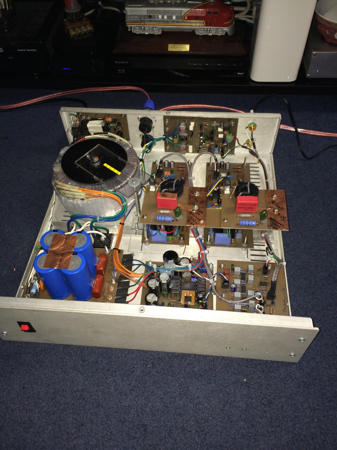

Dual 500w Class D Amplifiers based on the IRS2092, with MOSFET protection circuits, All custom designed and etched circuit boards.

Thanks, yeah it was a bit of a challenge for it not to have high noise, but having the LC filter on a separate board helped a lot. The noise is below 5mV on both channels and it sounds great!!! Almost as good as the Hypex UcD400 amps, its a pretty cheap and simple circuit too, using all Fairchild semiconductors. It doesn't get hot running even if its pushed. It's just used for subwoofers and has a built in 24db low pass filter.

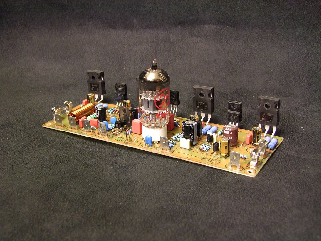

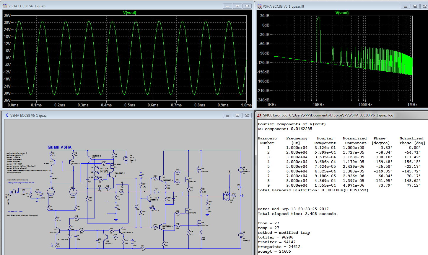

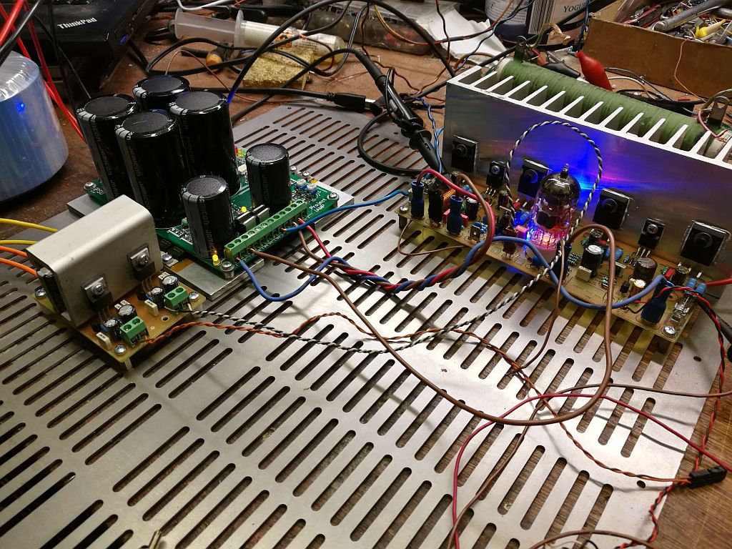

I had a few days off so why not to make another project
This time I have decided to go in some retro design with a small bit of freshness.
Never knew why people were creating quasi designs so I have tried it myself.
ECC88 input, mosfet VAS cascode and quasi N-mosfet output = Quasi VSHA.
The amp needs a bit further work but so far I am more than satysfied.
A lot of air and micro-details, bass rather warm with quite poor kick, hope higher voltage PSU for the tube front end will sort it out.
Regards
