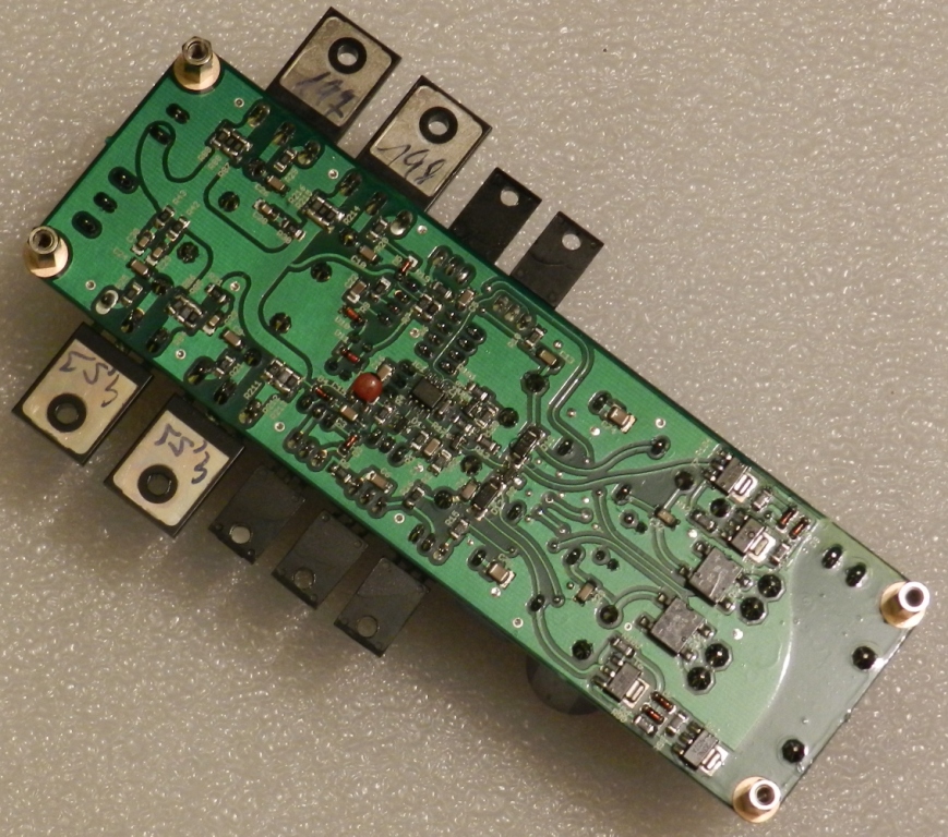

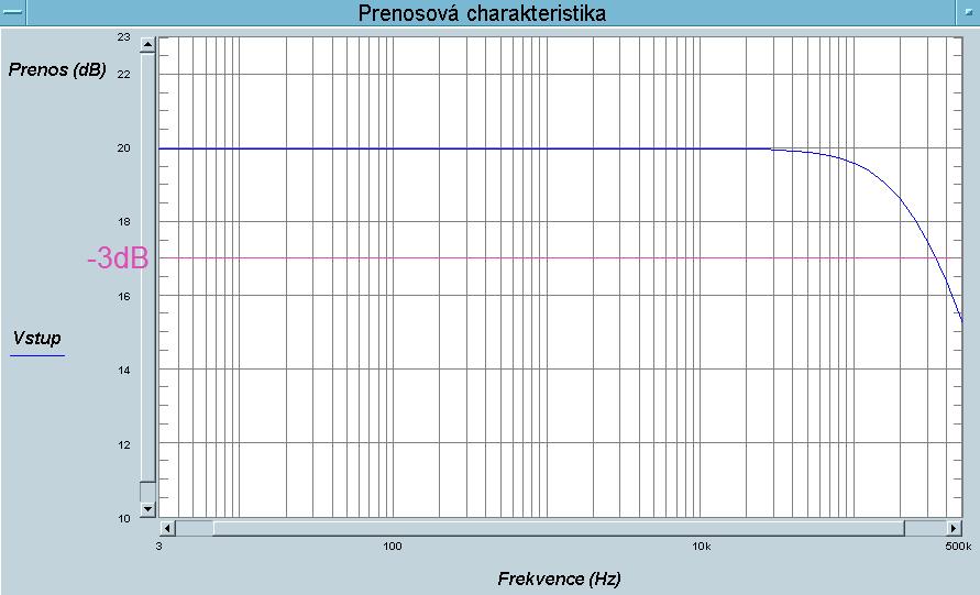

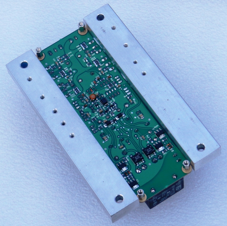

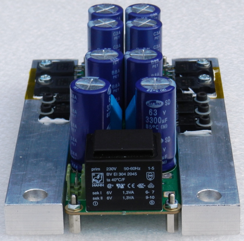

My last HEXFET 200W/4Ω :p
Measured

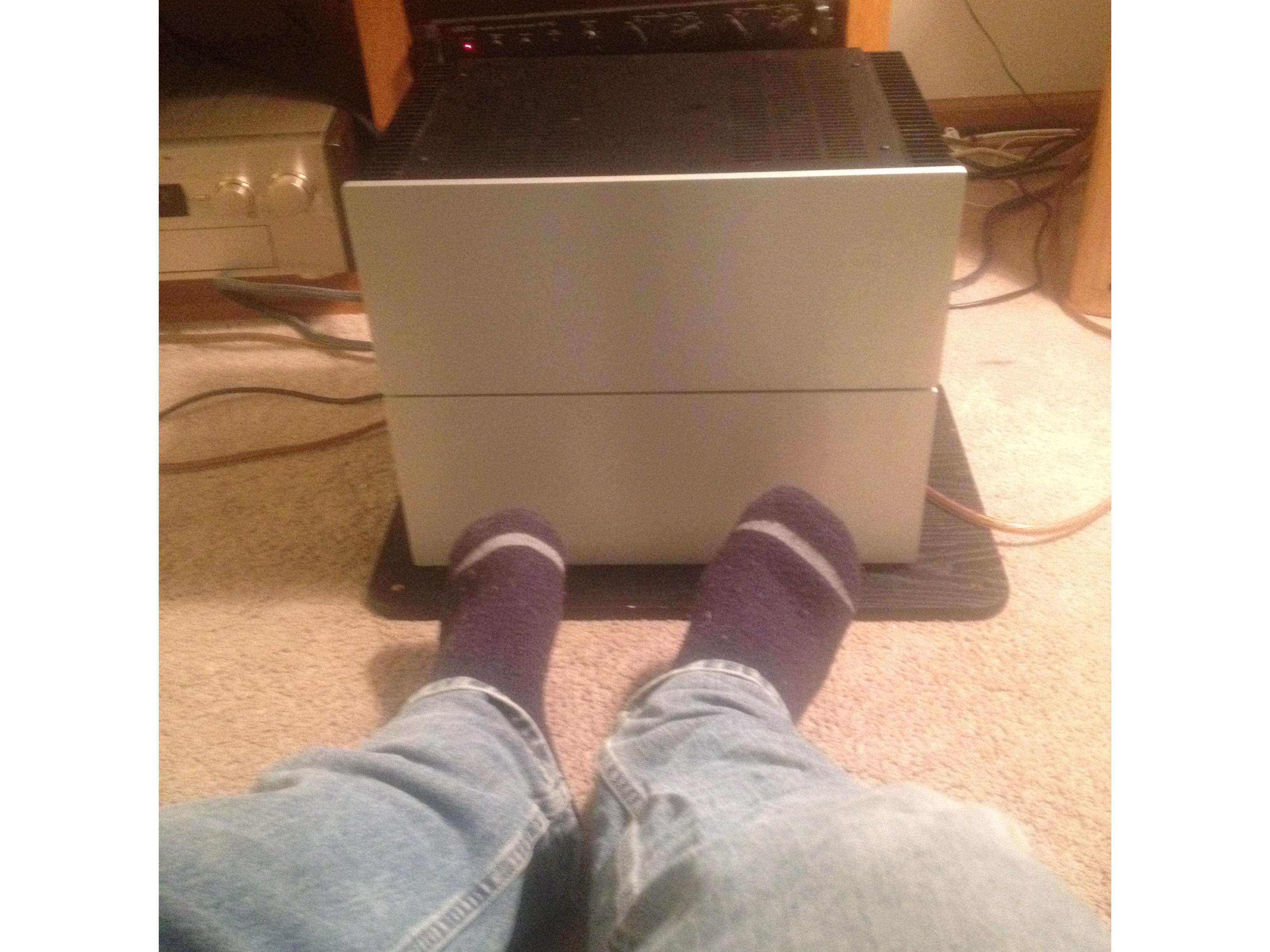

Another Honey Badger is alive. Built with OS's Mouser BOM, I used MPSA-18s for the input pair, MJE15034/5 and NJW0281/0302. Input pair Hfe = 580 left and 579 right, exact match for each pair according to my cheap meter, less than 1mv offset on initial power up. Following the build guide, power up went smoothly, the only nerve wracking part was bringing the bias up. I was surprised how many turns it took to get the bias to start.
I haven't had a chance to do any critical listening yet, so no comment. Eventually want to do a Leach/Honey Badger shoot out. 5 pair Leach biased at 50 mA/device vs. 100 mA/device Honey Badger.
I'm still working up a design to send to Front Panel Express for this and the Leach below it. Source is an Oppo BDP-103 feeding the amps directly. The receiver in the background is doing surround channel amp duty and providing remote control triggering for my home made sequencer. Planning to add a direct remote control for the sequencer using usb power from the BDP-103 to trigger.

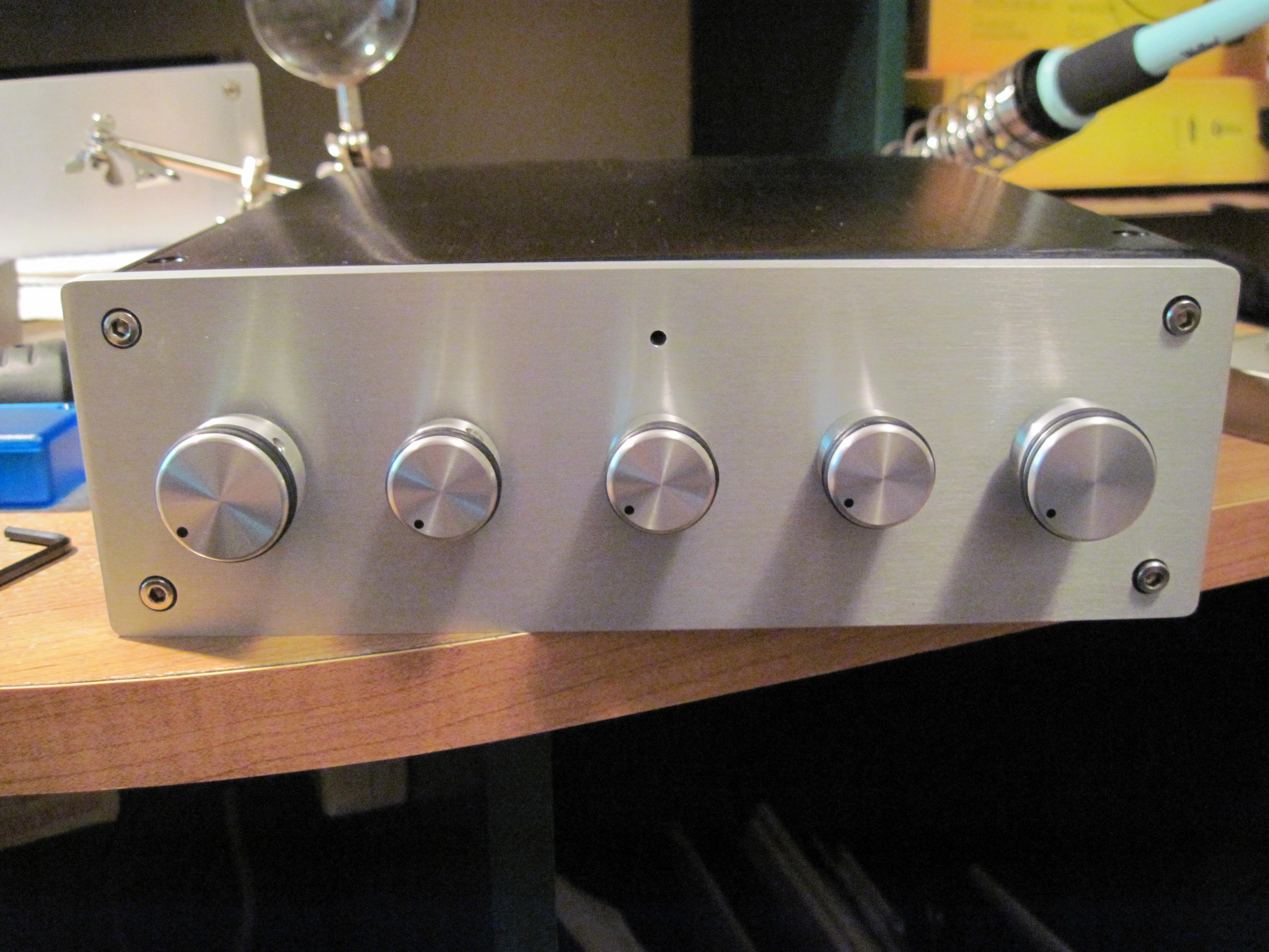

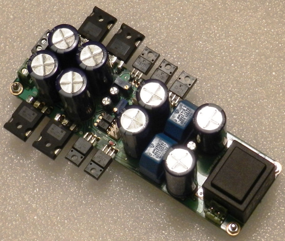

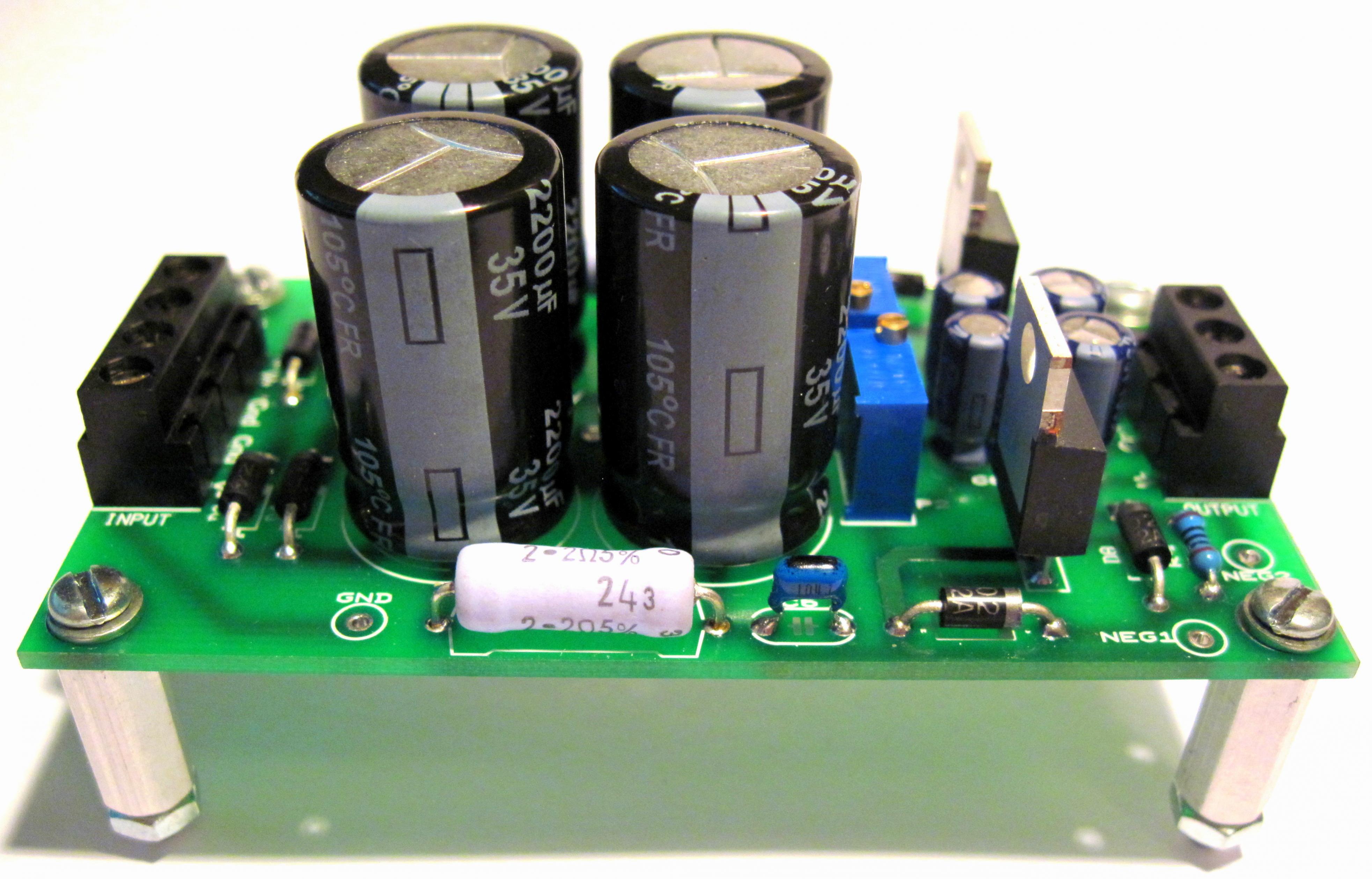

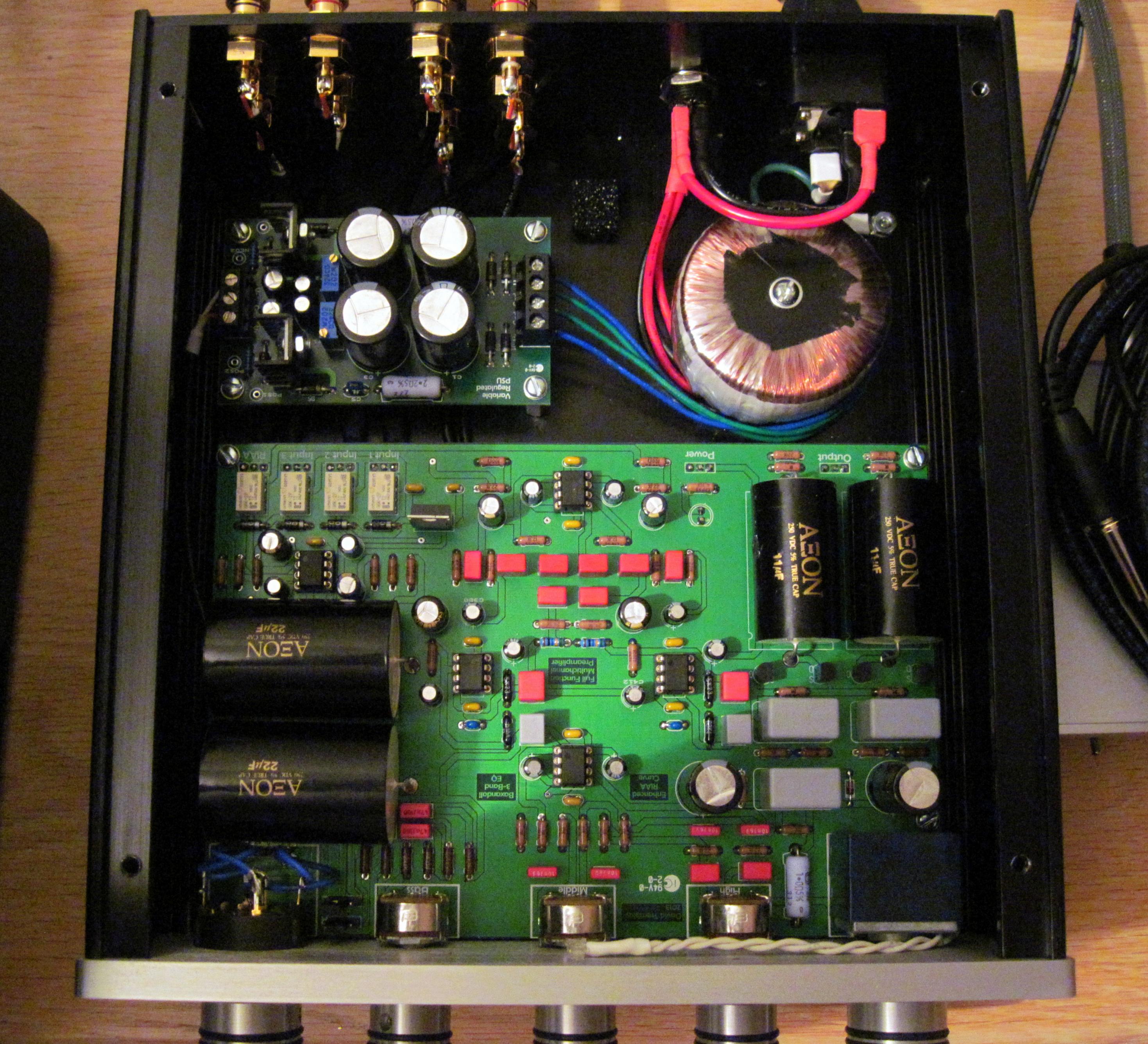

My DIY effort

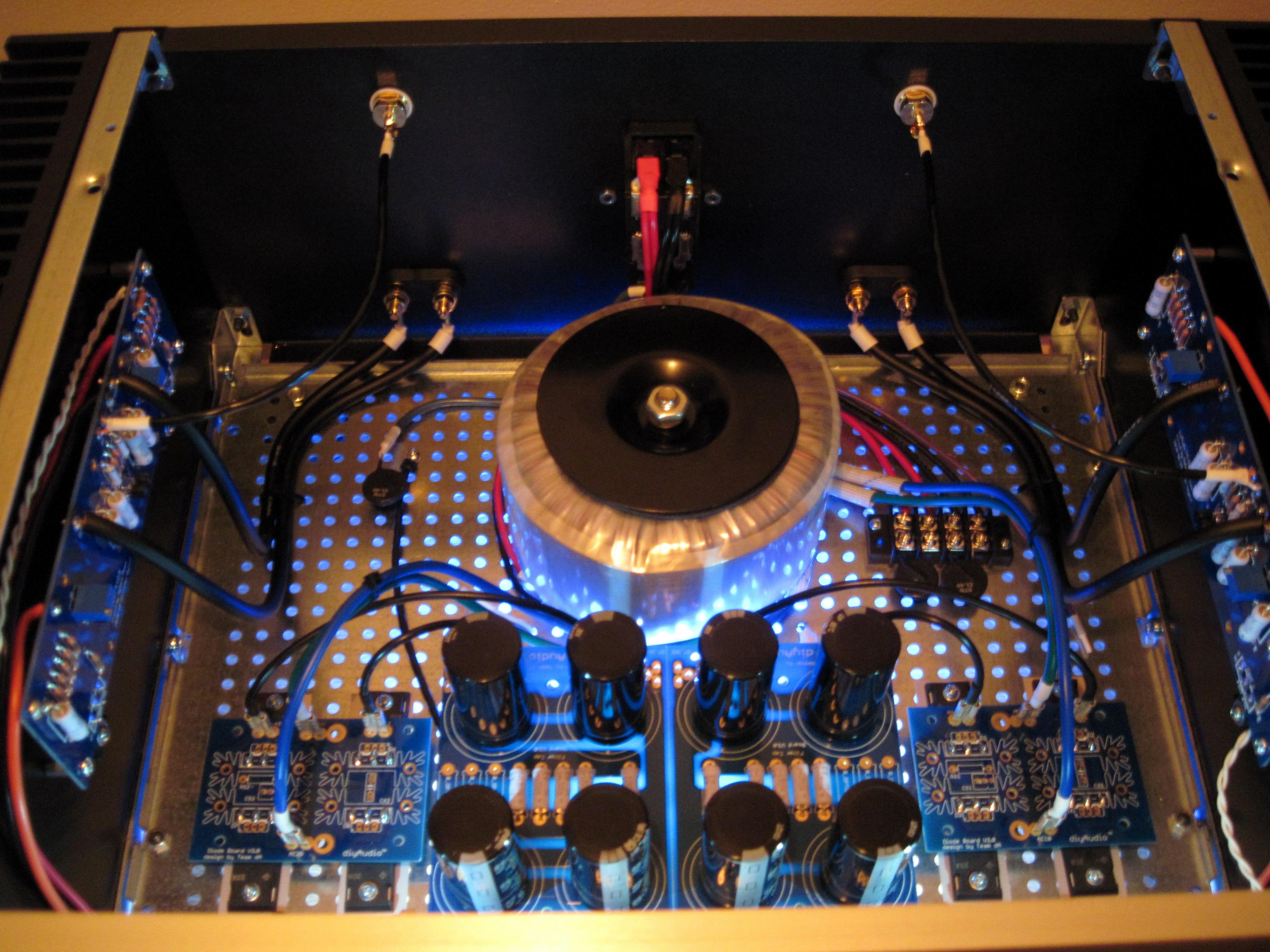

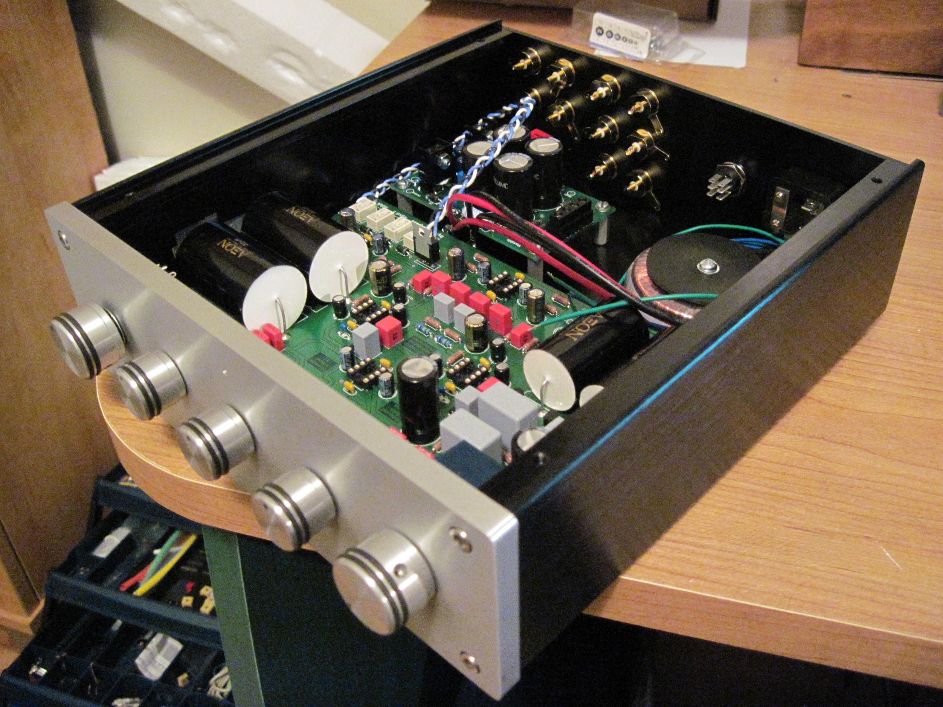

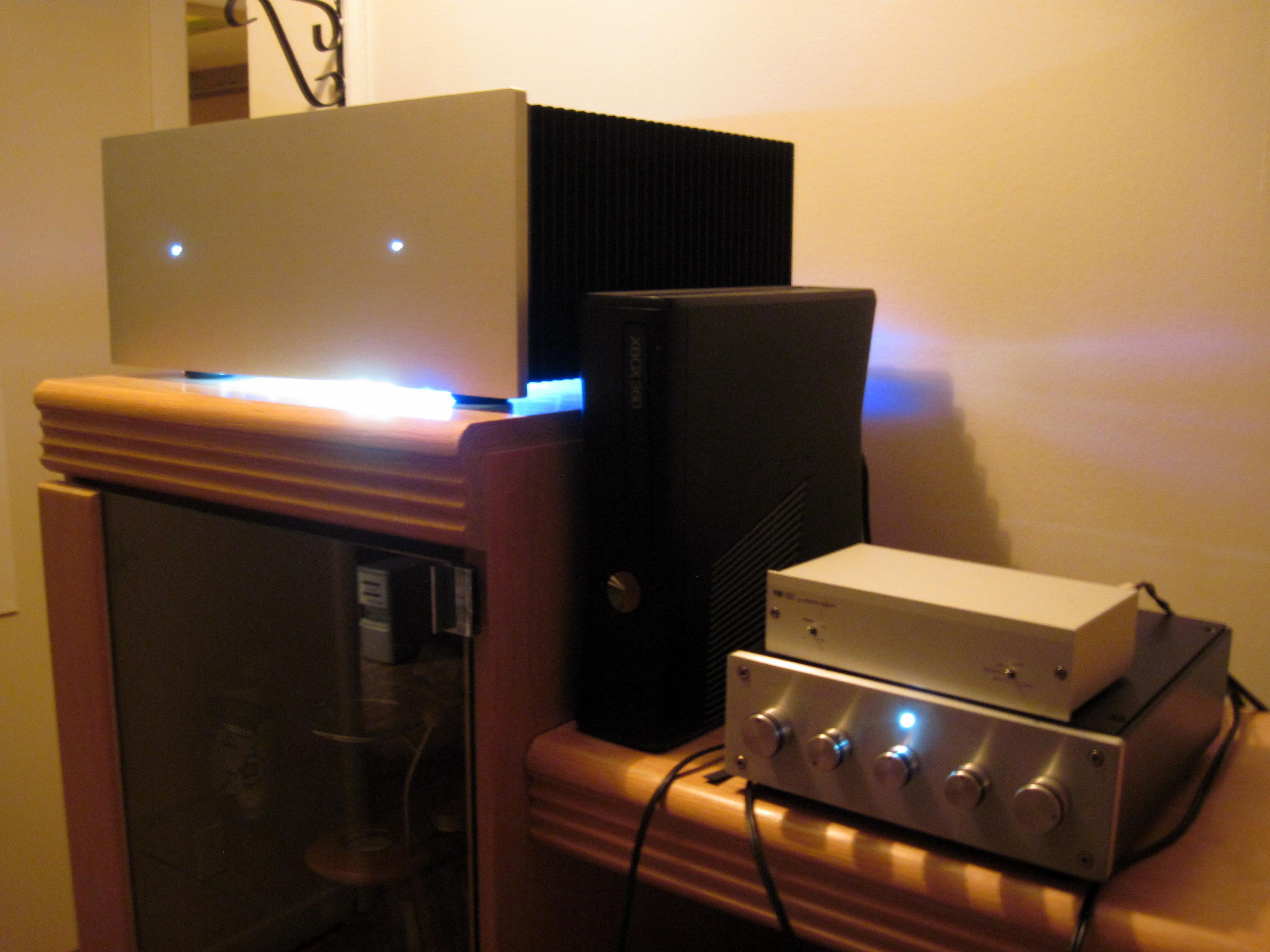

I'm a student in electrical engineering from Quebec, Canada and a few weeks ago, I completed these two projects. The first one is a F-5 from Nelson Pass. That wasn't that difficult given that the building guide on DiyAudio is pretty clear and easy to follow.
The second project is unique. It is a full function multichannel preamp. It has 4 input. A phono stage with enhanced RIAA curve. There is a Baxandall 3-band EQ for bass, mid range and treble adjustments. One input buffer (ne5532) and one output buffer. The output buffer is basically the B1 buffer by Nelson Pass. The input is selected by a rotary switch that activate relays. I also made the variable PSU that can goes from +/- 1.5 V to 37 V (1.5A). It is a typical circuit with just few changes(it has a very good ripple rejection of around 80 dB)...
The two PCBs has been conceived by me and everything is working fine.
The amplifier sound fantastic!!! =P

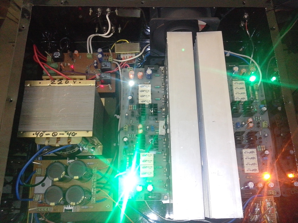

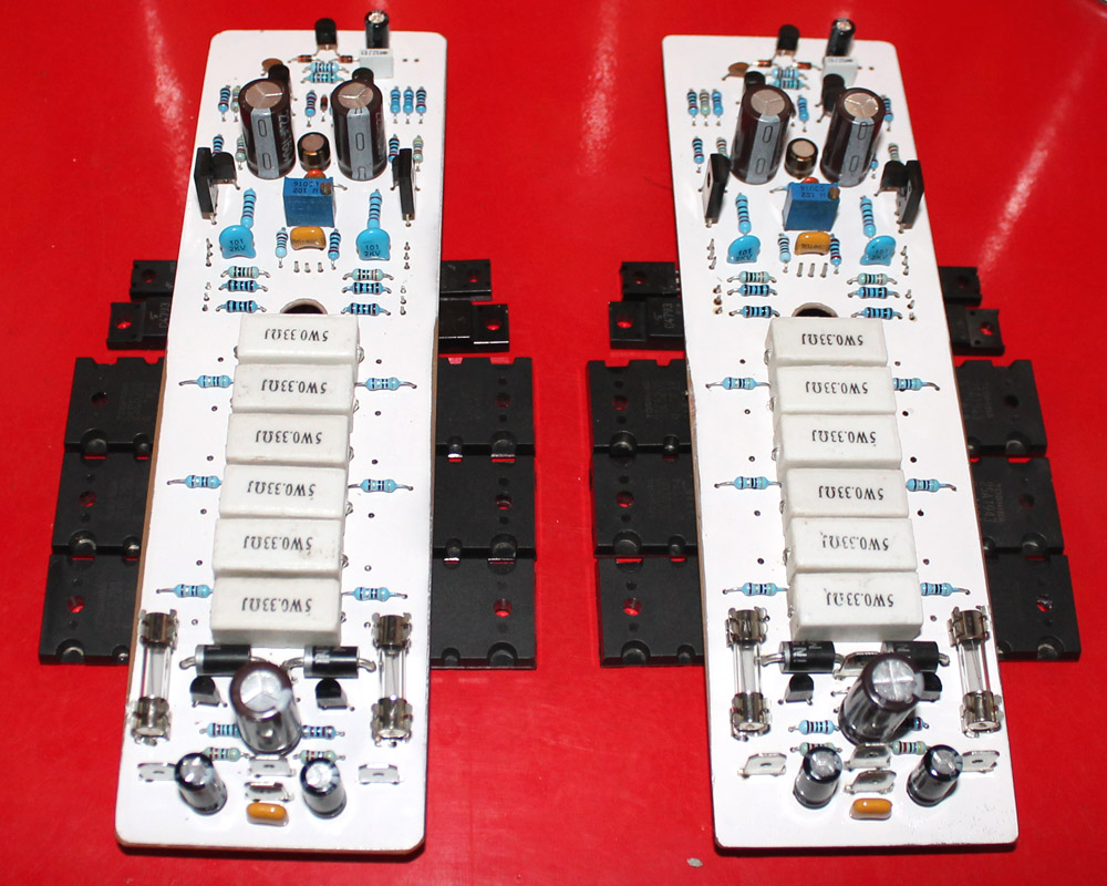

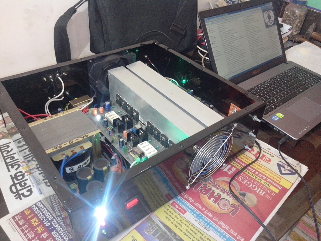

250W+250W integrated amp

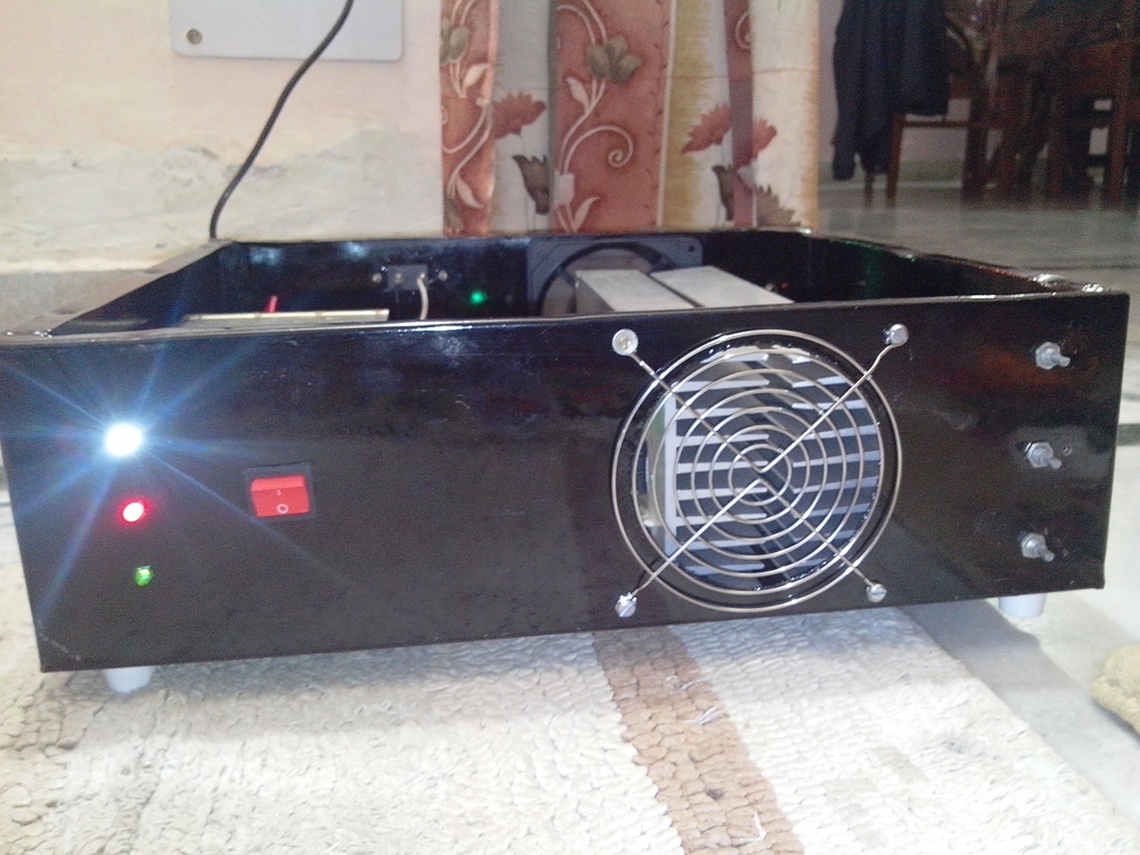

some pics of my new build. a 250+250W @4 ohm integrated amp, the main amp was designed by myself, PCB's designed by AlexMM, a simple soft start designed by me, protection based on Rod Elliott's design and the preamp based on Elliott's P97 preamp. Sounds fantastic. Bass punches in the chest with such an authority over the cone movement. Chassis is made at local sheet metal shop using 1.5mm steel.
