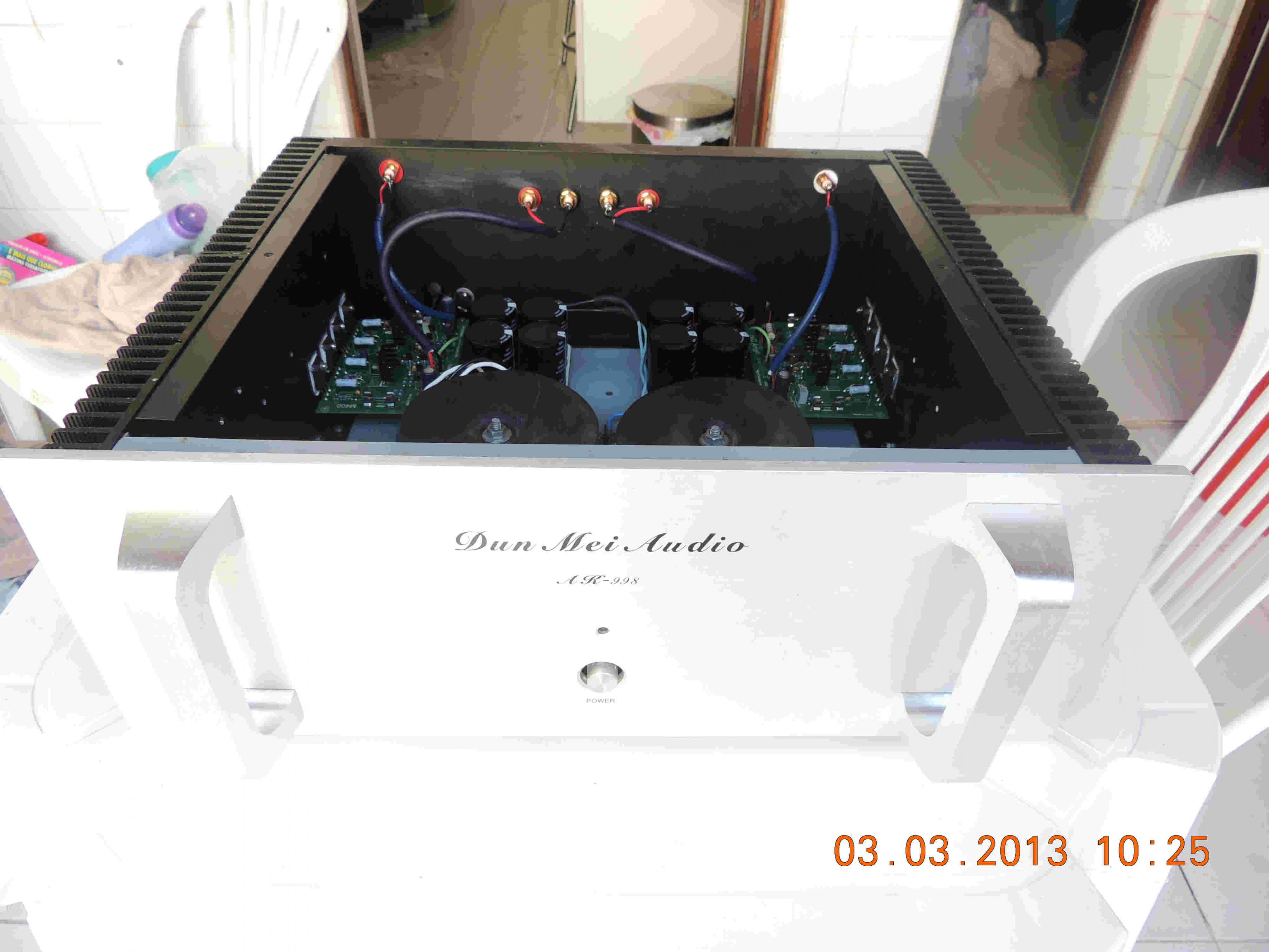

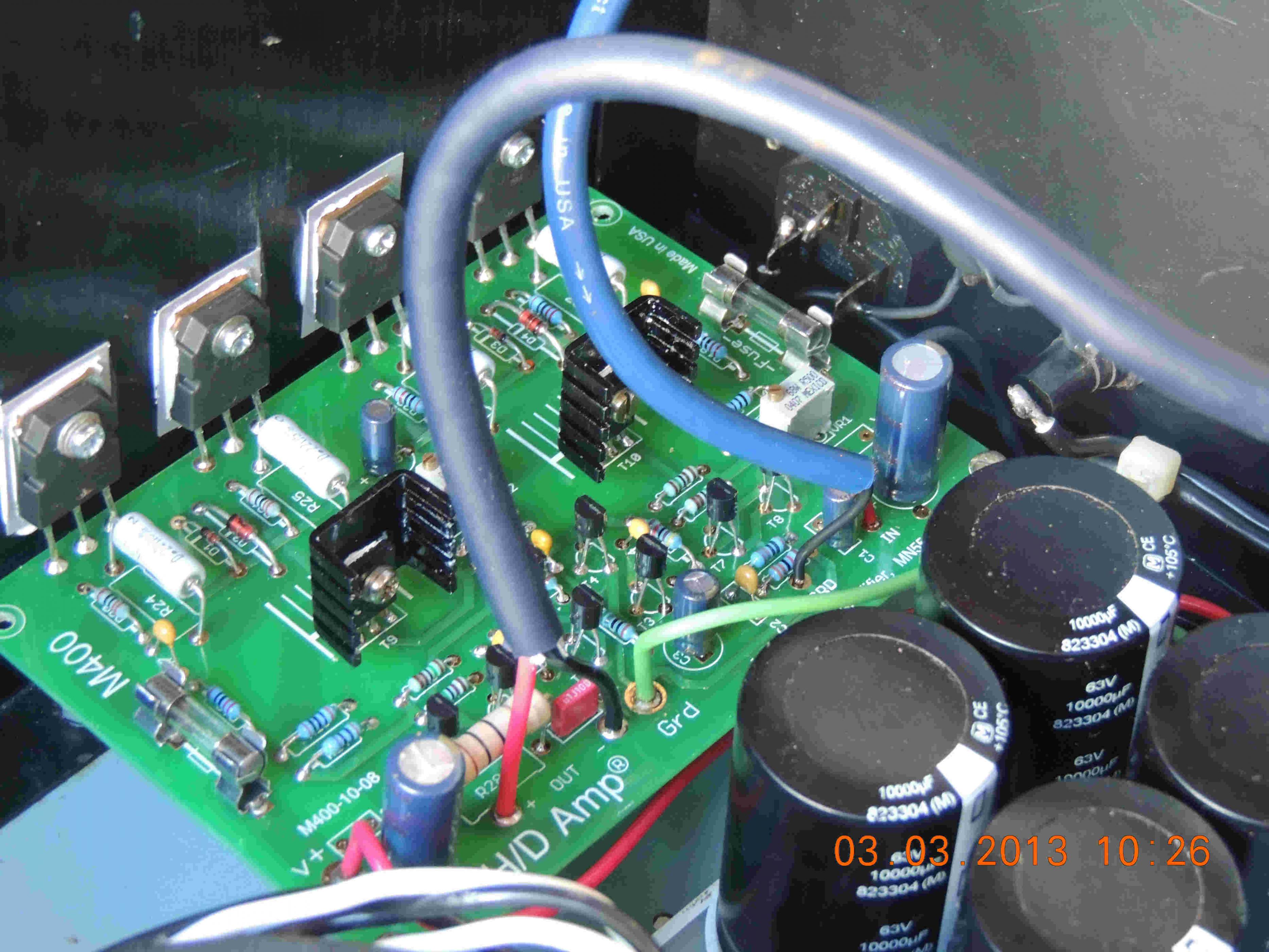

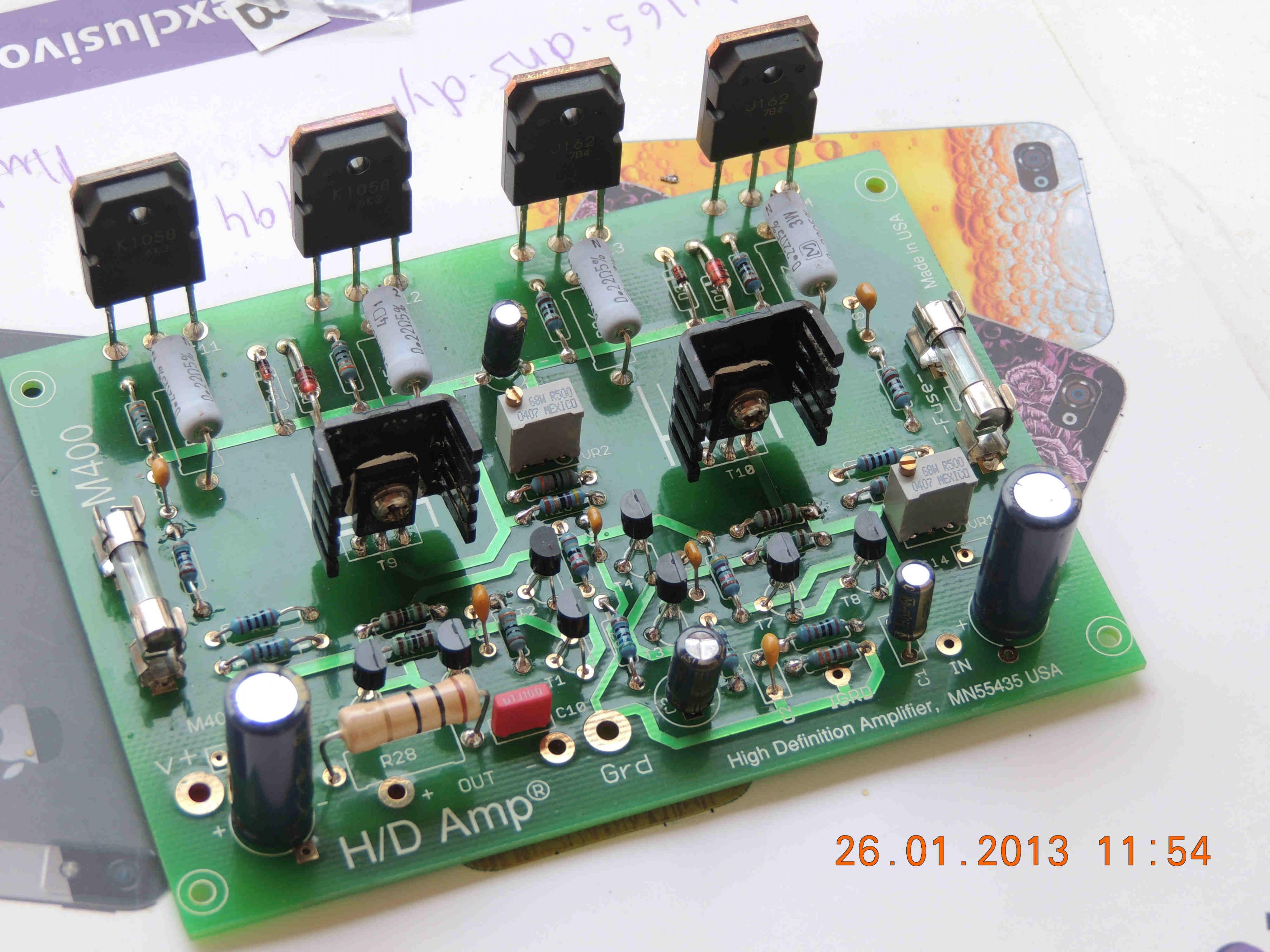

M400
Hi, let me present you my HDAMP M400, wonderful sounding amp (as member lanchile said). lateral mosfets 2sk1058, 2sj62, ps 56vcc, 130w pc. Cheers !!!
Hi, I am glad to see your M400 build!!! These amps are very well design. and they sound awesome!. in my amp I replaced C1 for a Sonicap 4.7uf and I put them at the input terminals (too big to put it on board). I am using a TKD potentiometer connected directly from RCA input to amp as a passive integrated amp...it sounds wonderful;)
PS: These M400 sound so good that it replaced my Bryston B60 that I loved so much!!!...yeah that good!

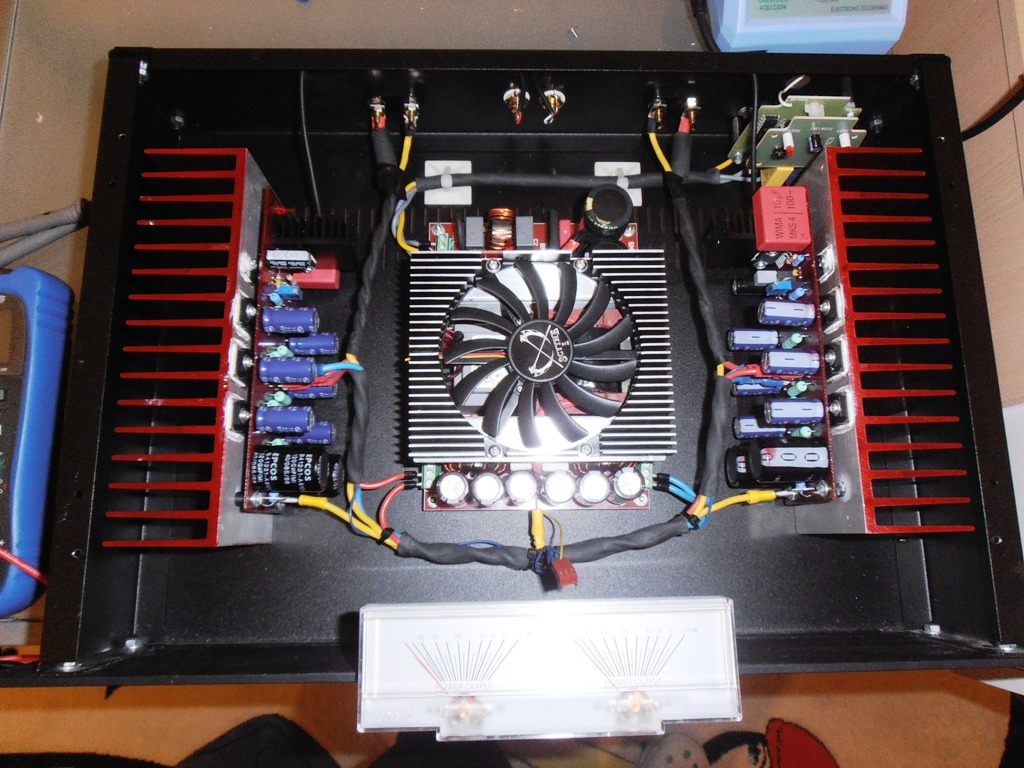

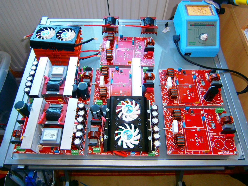

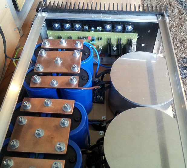

This is a my diy amplifier based on LME49810 power amplifier driver.
Output stage-3 paire matched NJW3281 & NJW1302 ON semi.
The power source is a full-bridge power converter based on ETD49 core.
+/-60Vcc 800W.
Not ready yet but I did some tests and the sound is great.
Red heatsinks - nice! ;)
Any other pics of the power supply without the fan? :rolleyes:
Cheers!

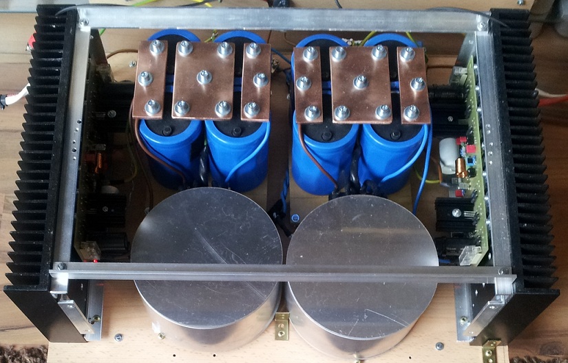

Thank you Lanchile.I am using a Goldmund 27 clone as a preamp (active), I am in heaven here. Dear i have 2 Auricaps 4,7uf , soon i will put then in C1 posistion, they are big also. Mhouston i always use dual mono in my amps. In this case i use 40.000uf per channel. I think it´s enought for a AB CLASS amp.

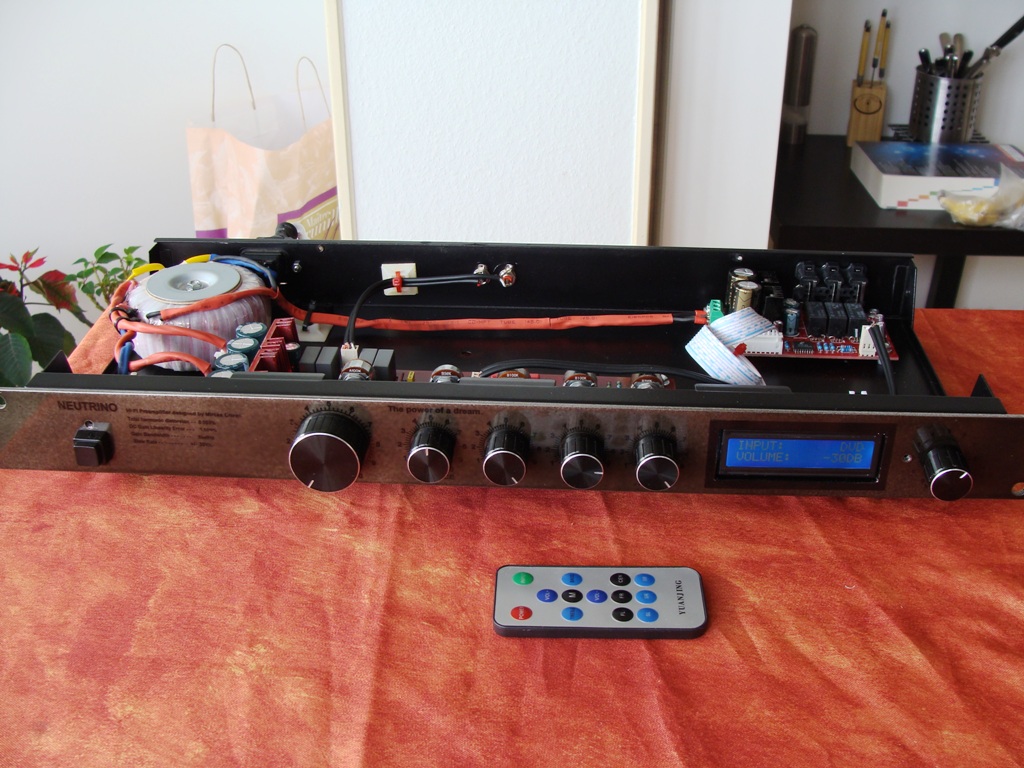

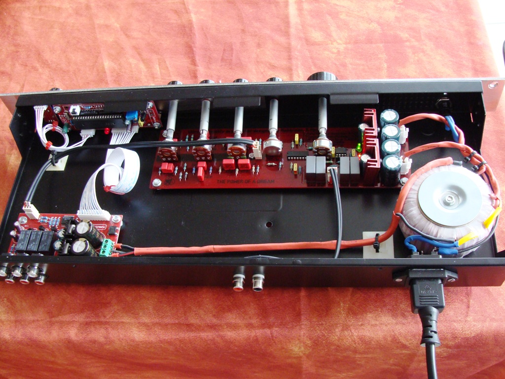

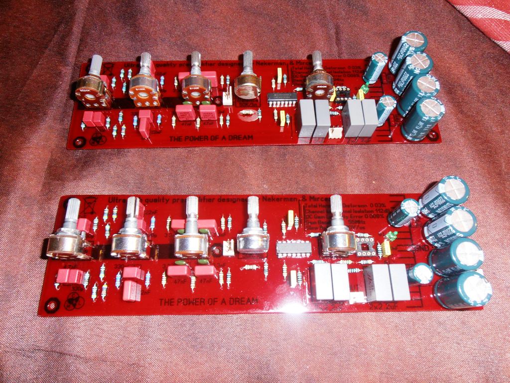

Rod Elliot preamp version with few changes and volume control selection sources Chinese.
I used LME 49720 & LME49740 from TI (National Semi).
Enclosure saved from a broken switch and front panel dummy rack 1U.
The sound is very clean.
