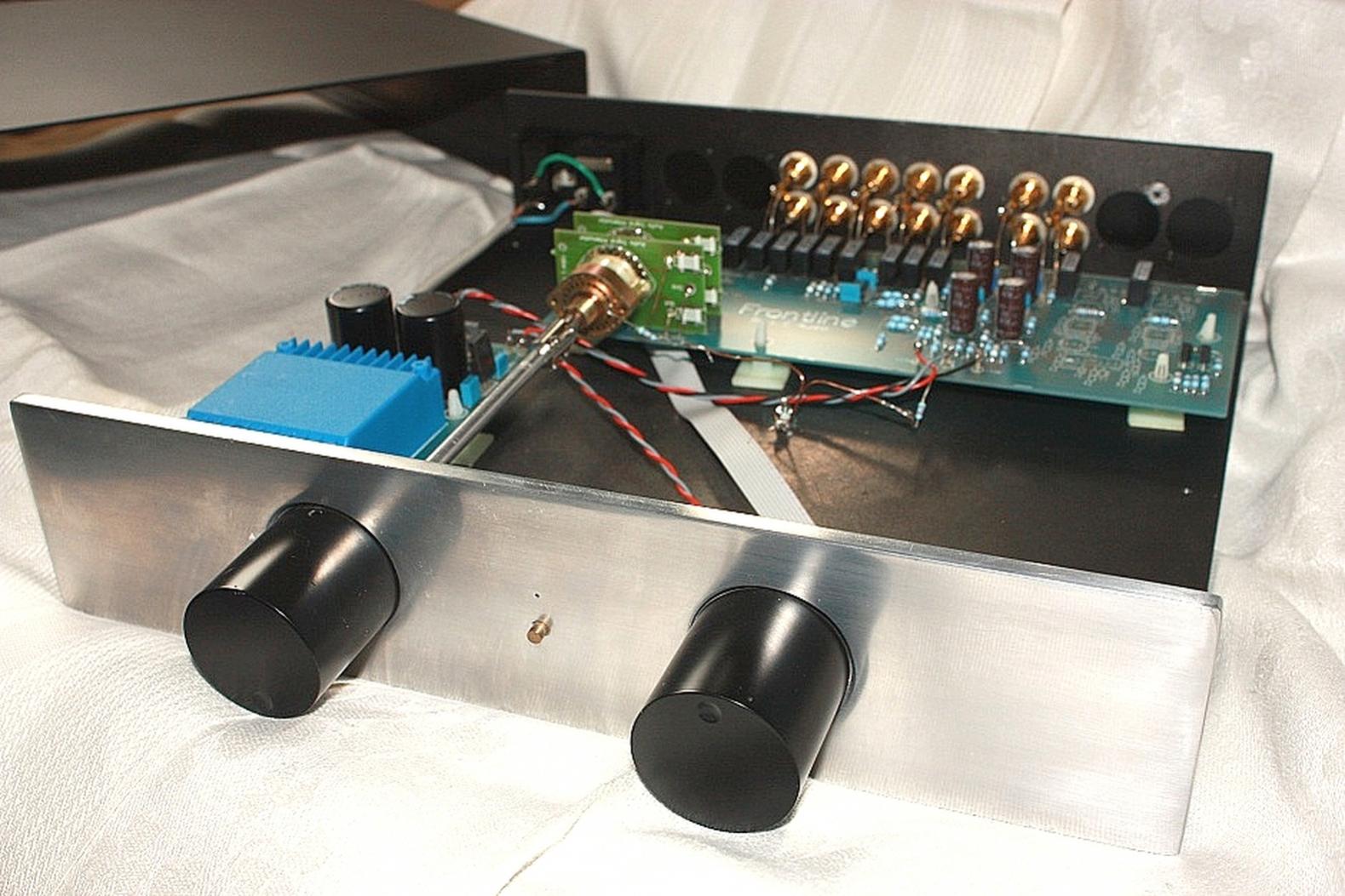

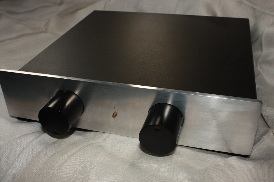

I think it will need a couple of nicer looking control knobs
hell, I dont even know yet if it still works
not really sure yet what I will do
leave it as is, or change it
I should have the schematic, somewhere

I suddenly remember the regulated +/-13V supply also have a +12/0 reg out
it is fore the relay/input control switch
makes it real easy to implement a hi-Z instrument input, with a single jfet
Oh BTW - keep the knobs - find the schematic.
I found the complete kit manual
and there is no schematic, sorry
now Im not even sure if there ever was any
one funny thing
the preamp even have a relay switched 'tape out'
pure luxury, but also tells how old it is

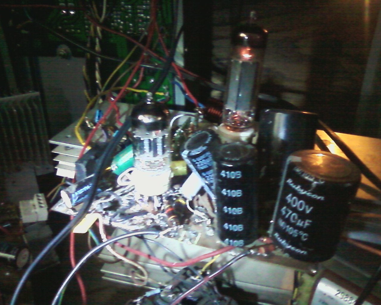

sound of these hybrid, EL84 drive dc coupled to fets, and srpp 6n2p, but video is already blokked on youtube after 2 minutes, but you can see it here.
http://www.youtube.com/watch?v=3FjgtD1x6m0
little child behavior of these people who claim so much, she are already the most rich people on earth, but oke it is kapitalism.
sound truogh youtube is afcourse not so good, and I have no place to post the wav.

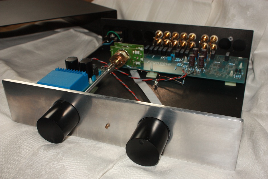

Here is my B1 Buffer with 10dB gain of Pre-amp

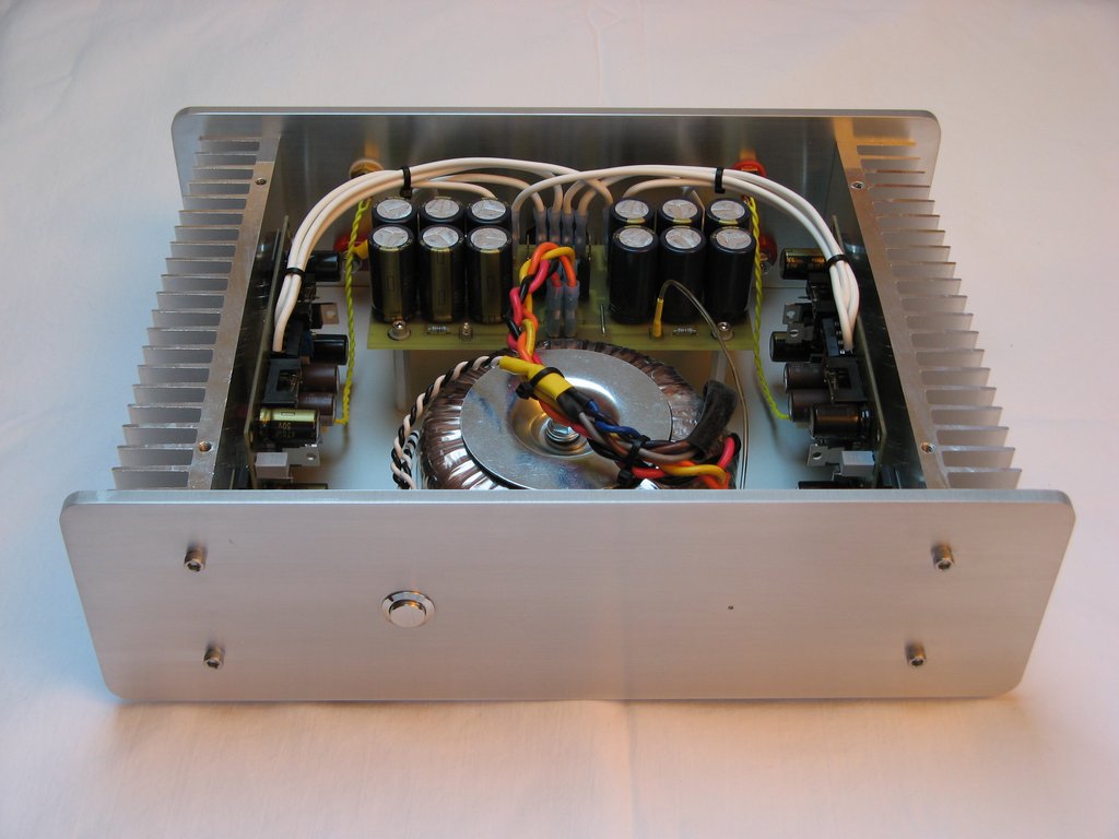

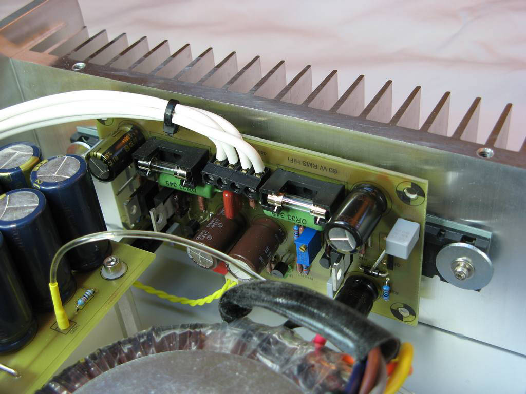

ESP P3A clone. Performing flawless for more than 1 year now.
Case is home-made using anodized 3mm aluminum plate and 100x6mm aluminum flat bar.
Heat sinks are HeatSinkUSA 8.46" model, tapped to hold everything together with 8-32 screws.

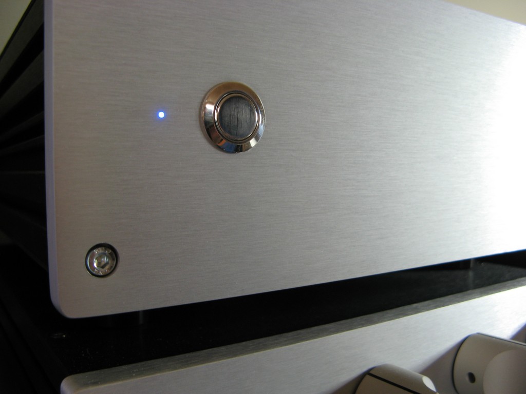

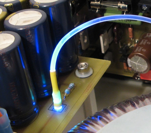

Very nice job discrete!
PS: What is that clear wire there...is that fabric-optic?
Is it a light pipe from a remote LED?
That is it.
I used to use something called 'stretch magic'.
It is a tough elastic available in different diameters, intended for arts and crafts.
Since then I have switched to cheap toslink cable.
Much more efficient and can do any distance.
It does a neat 1mm diameter indicator that fits tightly into a 1mm hole in the faceplate.
It is kept in place on the LED with heat shrink tube.
That is it.
I like it
Super job on the amp by the way, puts many a commercial jobby to shame.
