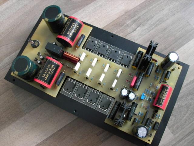

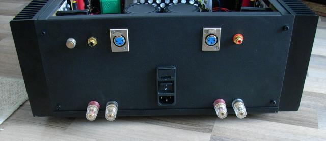

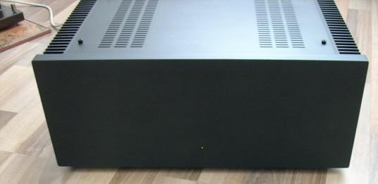

My latest Class-A amp project - the Clamp-III
It is a simple power follower using LM317 as CCS and a IRF450 MosFet
Board - relays are for switching bias (1, 2, or 3A )
Initial testing - power is abt. 15W in 8 Ohm - PSU is C-L-C - 31V DC at the Amp-boards.
