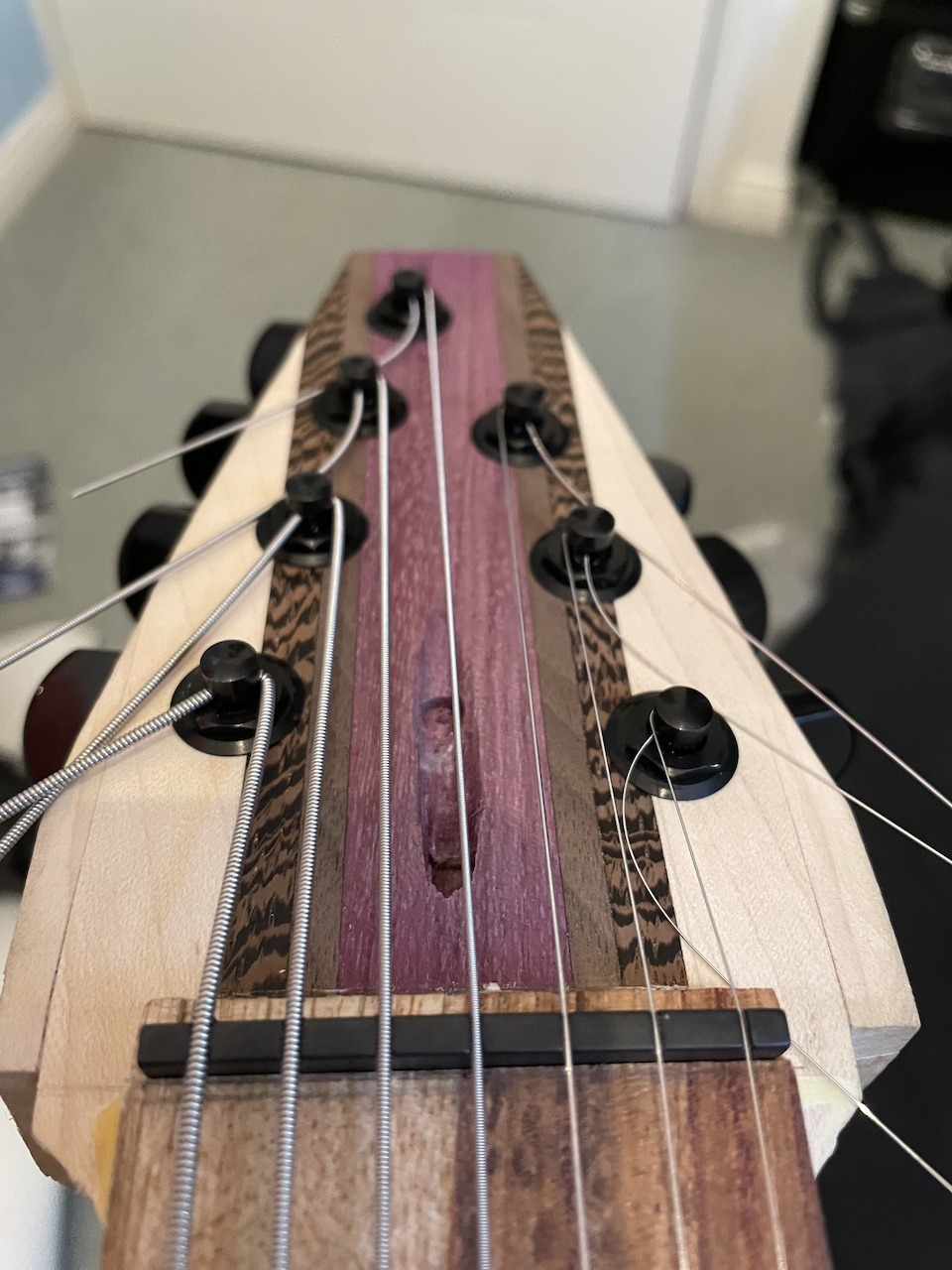

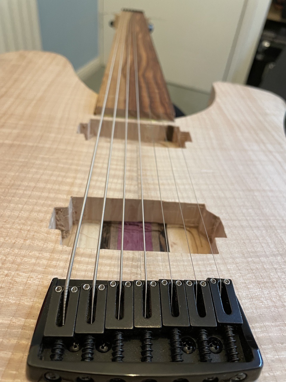

Stil has a little way to go...
I strung this up for the first time (to test the neck). It still needs the neck carved, the fretboard worked on , the nut worked on, the fret fitted, the body carved etc..
28.625" scale 7 string.

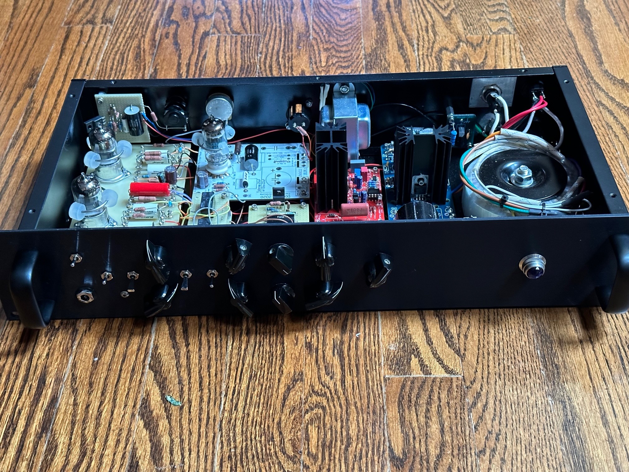

DIY Fender and Ampeg Bass Preamp
I have always wanted a way to compare the 2 preamp styles:
The Fender is the Alembic/Showman/TraceElliot V-type/ style with switchable V1 cathode bypass caps(1uF, 3uF, 47uF)
The Ampeg is the second channel of the B25
The tone stacks are separately assignable.
The choices are:
1- Fender preamp with Fender tone stack
2- Ampeg preamp with Ampeg tone stack
3- Fender preamp with Ampeg tone stack
4- Ampeg preamp with Fender tone stack
Also added is a switchable MOSFET buffer as the first stage (similar to Alembic F1x and V-type) which could be used for an effects loop.
Mid-boost switch on both tone stacks.
The output is done with a mu-follower (5814 tube) driving a Jensen lineout transformer. This feeds a balanced input of a Hypex 2500W power amp.
Another DI output driven by a MOSFET buffer to feed a external Jensen DBE box.
All film cap power supply with Jan Didden’s T-regv5 voltage regulator set to 320V.
Very quiet, NO hum, lots of punch
A lot of fun!
