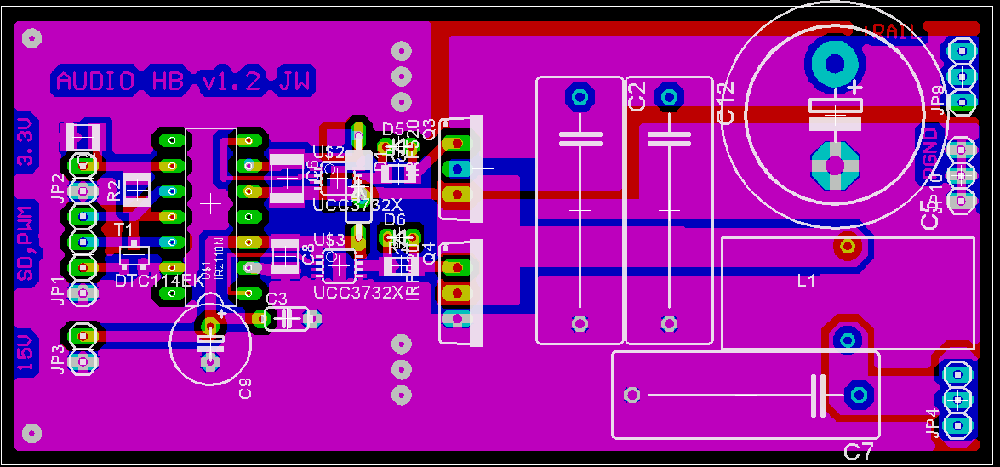

Well here goes my prototype v1.2, IR2110 + 2 x UCC37322 + 2 x IRFB31N20D, single-supply 50..90V, 2-layer PCB (would need 3-layer for dual supply, but 3-layers aren't DIY...). Not so thoroughly tested and scoped yet, there may be some flaws.
