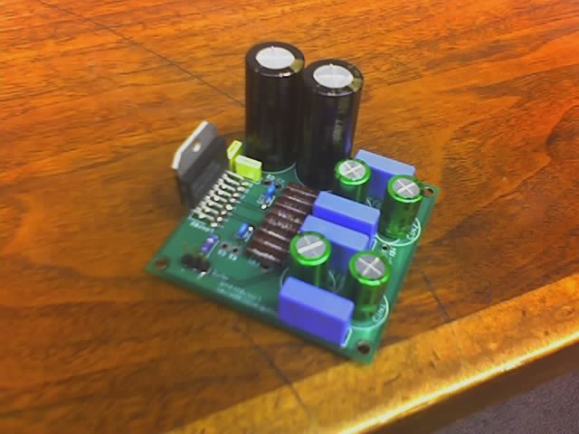

I put one together quickly to make sure everything fits, and it looks like the boards are perfect. I assembled this one using slightly oversized 1/2W resistors for everything, and they were a little cramped, but using 1/4W resistors (as the circuit is designed for) will be perfect. I test fit standard 1/2 and 1/4W resistors and both fit well.
I also try fit a bunch of different electrolytics, and all that I tried seem to do well.

No problem! I am just glad they turned out nicely. There is one silkscreen glitch (my fault:smash: ) but if I didn't really look for it I never would have noticed. Of course I caught the glitch 2 days after I sent the boards in! Still, nothing that will affect how the boards work. I'll see if I can scan in a better picture and post that sometime.

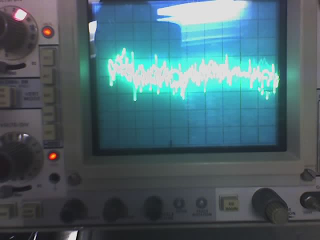

In the mean time, even though a regular waveform would be more diagnostic, the Mighty Mighty Bosstones are more fun to look at on a scope! :D The (bad) picture below is just my iPod going into the LM4702 board with +/-35V unregulated rails, measuring the sink, source, and feedback wires tied together. From the tests I ran last night, the boards seem to work fine, though I did notice some very faint "hum" noise in the background when I cranked the sensitivity of the scope up. I couldn't see it until I really got to some pretty low levels, but it was there. When I grounded the mute pin, the noise did go away, so this is only there when the amp is on. I'm not sure what it was from, but none of the inputs were shielded, and the grounding was awful, so I am betting that once I get everything properly configured that will go away.
