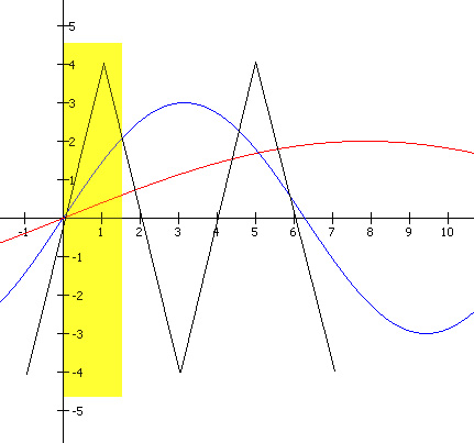

this picture can show where is my question on.
red line: signal 1
blue line: signal 2
black line: triangle wave for compare.
so, what will be happen on the part of the red line in the yellow area?
will this signal be lost?
It is a little dangerous to say one input signal modulates the other one. The term modulation is normally used when one signal is used to influence the other (like control its amplitude, phase or frequency).
The "payload" that is going to the modulator is actually the SUM of both input signals (which in this case haere would be high enough to overmodulate BTW). This is also called linear superposition.

You can't expect such a small fraction of the signal to pass through individually on a sampled system! Your question basically refers to the sampling theory, however in this case the sampling intervals are not uniform. Between two sampling points the datails of the original signal are "lost", but if it was appropriately band-limited, these points can be restored (by a filter) from the other time-points. In case of uniform sampling the bandwidth should be less then half as the sampling frequency to achieve perfect restoration (Shannon-theorem), in case of PWM ("natural sampling"), the restoration always have some error, the higher the fsw/fsignal ratio, the lower the error.
An other question is signal level: the sum of the signals should not exceed the triangle amplitude.
If signal amplitude is OK, and freq of every components are lower then 1/5th...1/20th of the triangle, then the original signal can be restored, but you won't see it in a small time window. (1/5: acceptable, 1/20: almost perfect)
One more thing: one modulating signal (wich can be the sum of two sine wave) goes into the modulator, one PWM signal comes out, and one signal can be restored, the original sine waves cannot be seprated (unless the receiving side knows what was transmitted).
Summary: PWM is approximately a quasy-linear operation, if we assure the neccessary conditions.

I answered the question: "lose red signal?"
do not lose anything. is a different matter if the effect of the modulator (comparator with a triangular signal on pin) in this case, the PWM output will have both the segnali.eg: the pulse width modulation will have 100Hz and at the same time will change width of pulse to frequency of the second signal eg. 20Hz).
Of course there are the proportions for the two signals. amplitude and time domain.
Also,addition or subtraction produces the same result for intermodulation.
Difference is only in reference to a third signal.

I agree with you, "the PWM output will have both the signal", although i unable to do some testing to verify, logically, it can be.
but, the another issue is the FET in class-d amp normally working at the switch status, how can FET differentiate those 2 PWM.
and also, the LPF behind the FET, how can it works.

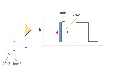

Sorry for very simple pic .
Concept is clare, in this case two modulation is present at output di class D amplifier (100hZ & 20hZ).

Just measure the pin of the comparator to see that there are two signals at carrier frequency.

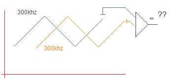

Ops!
Please... do not use simulator for this.
Is that triangle a comparator?
300 kHz square, duty cycle is 40 or 60% depending on the input polarity. Is this a real question? (I don't think so.)
I had no real doubting that you respond appropriately.
Now imagine that a phase change (increase / decrease) from 180 °.
two signals are the same high frequency, but the result (PWM mode) will contain the audio information (audio frequency).
Do you agree on this?
Then is possible apply two high frequency signals.
Sorry, I was wrong, the duty cycle is 50 %, independently from the phase shift.
I don't know where does this "audio information" comes from. You haven't mentioned anything about any audio signal before.
I don't know what do you write about.

Dear Ap2,
on the square wave, it looks it delay the comparision for 20Hz signal, or ......?
still not understand it.
