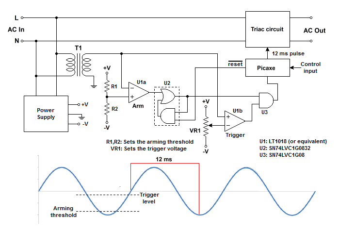

"12ms is approximately 75% of a 60-cycle wavelength, so it holds the TRIAC triggered long enough to get past the 1st zero-crossing point, and then lets the TRIAC shut itself off at the end of the complete cycle"
This seems like a Soft Trigger. I recollect that a SCR/ TRIAC can act in funny ways without a Hard Trigger ?
Hey Art. I'm not sure what you mean by "soft" or "hard" trigger. I would be sending an appropriate voltage pulse to the TRIAC. Do you mean a pulse generated by software, as opposed to being generated by discrete components?
