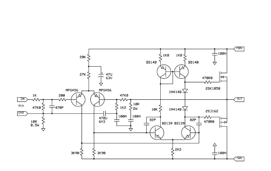

positive rail fuse blowing
What would cause only the positive rail fuse to blow? I've replaced all transistors 3 times.
The only difference between my circuit and this schematic is that I substituted bc558's for the mpsa56's.

50 !!!! volts rails for this schematic ..... without any form of protection like VI limiters or zeners looks kind of too much i thing....
also how do you bias this amplifier ...... is the diodes attached to the heatsink ????? you might allso have thermal drifting.....

On the circuit you've posted -have you got the BC558 the right way around? The pinout is the reverse of the MPSA56.
Same goes for all of the transistors, are the pinouts right?
Are you using the right type of MOSFET at the output ? If they are not lateral MOSFETs, the circuit will not work properly.
What about PCB? Have you made it yourself ? Photographs?
PCB can be an issue.
Especially the ground rails should be done properly.
For example, 10R 2W and 100N link should be be placed across the output terminals.
That is be connected to POWER ground point.
Connecting that output filter close to input ground rail, can cause troubles.
Otherwise, I should check all components values,
and of course Transistor pinnings.
The two 470 Ohm resistors, should be put close to MOSFETs Gate pins.
Should not be put at the PCB, if wires are used to connect MOSFETs.

What I do is not connect the output transistors to start with.
I route the output from the VAS back into the LTP to get feedback.
I then power this up and check for faults.
Only if I find no faults do I consider connecting the output transistors.
This method has saved me many sets of output transistors.
