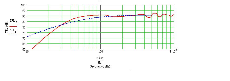

Where did you get the 'complete' T/S parameters, as they are not published?
Yeah, that one doesn't seem to compute. FWIW, I just used PE's additional specs to calc BL and arbitrarily used 7" for its effective diameter as it's close enough for a sim since there's no measured specs:
5.7 ohms Re
0.5 mH Le
7.9583 N/A BL
248.3 cm^2 Sd

Jimmy,
I was unable to duplicate anything near your results using the TL dimensions you posted and the Usher 8955 driver. Where did you get the 'complete' T/S parameters, as they are not published? I derived them from formulas, with a good 'best guess' for Re of 6.5 Ohms, which duplicated the Zres number (from the published Z plot) exactly, so I'm pretty confident in it. I got a BL of 8.1 and Le of .3mH. The rest is all obtained from their data sheet. How do those numbers compare with what you used ?

I either forgot or neglected to mention that, forget which it was. 8955A specs at usheraudio.com don't match partsexpress.com specs on the pdf. Le I got off the partsexpress description not the pdf at the site. I figured the specs at usher were closer to the correct specs for those woofers. It is problem. I was able to measure some specs correctly using speaker workshop on my 21W855-01 drivers recently, but most of the specs were wrong and inconsistent.
Which specs are you going by, other than the ones you mentioned?
FWIW I believe that the published specs are good enough to model a TL as the TL alignment is more forgiving than the bass reflex design. For BR I measure the T/S specs for each driver then average them to work up the box design. I wouldn't rely on the published specs for a BR.

Jimmy,
The important thing is to have a coherent set of specs; mixing and matching from two different sheets is not as reliable as taking a known good, coherent (but incomplete) set of specs and deriving the missing ones from the good data. If you go from two different sheets, you might be looking at a production change. A change to the motor would really throw you off in this way since your two different spec sheets might actually be for two different motors, model number identicality notwithstanding. In this case, the specs would likely be 'incoherent' or mathematically impossible. The DPC program (among others) would alert you to this problem. Changes to suspension compliance or cone mass are not as bad because the specs would likely remain coherent.
I used 235 Cm^2 for Sd as this is what you get when you use the published baffle cutout dimension for effective diameter, which in my experience, is usually pretty close to the real thing. The rest were Fs=25Hz, Vas=133l, Qm=2, Qe=.376, Le=.3mH, Re= 6.5 Ohms, BL=8.1.
At any rate, this is what I got when I modeled it with a 70" tapered line, 2.5 Sd to .3Sd, ~12" driver offset, and lightly stuffed:
That's the same TL as I am using. Mine is folded into a box with outer dimensions of 21" X 11" X 12" or a little less than 50 l gross volume, likely competitive in size with a ported box for that driver.
And look at that F10!

I got the same graph for the Usher TL with your specs as I did with my specs. I modeled it as 80" long tapered from 5 Sd to .5 Sd, with .45 lb/ft^3 stuffing the first 57" and driver offset by 29" and in an odd shaped enclosure, which looks like this:
Also the TL will contain a Scan Speak 21W/8555-01, not an Usher. I shouldn't have posted a picture with the Usher modeled in a TL. My decision is between two 8955a Ushers per ported enclosure or a Scan Speak in the described TL, but actually more like 87" long.
Right now I'm leaning towards a ported enclosure. I mean even Dennis Leary prefers a BR over a TL. While I don't really care for him or his "comedy" or "acting", I do respect him as an audiophile. I might even put a single ScanSpeak per ported enclosure. After all, I am building computer speakers here
I really like the build quality of the ScanSpeaks and I kind of don't want to give that up. But two Ushers per ported enclosure will have much less excursion at a given SPL. And even the posters that like TLs over BR aren't criticizing ported designs as having poor group delay, whatever that means in practice
