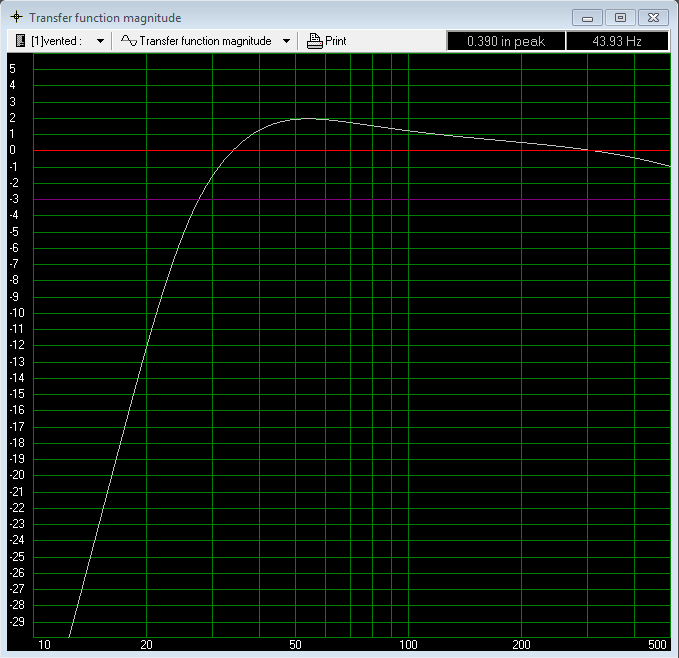

Okay lets start off with some basics of what I hope to do here.
I have a pair Rockvilles Budget $60 18 inch subwoofer's they claim to be 1200w peak / 600w rms and the goal here is to create a dual 18, ported case for them.
Heres what I've come up with so far:
The case's winisd settings:
32ft3
30hz tune
1 square port 10 inch by 29 inch, 15.23 inch deep.
2 drivers
600w
80 feet distance
I am getting this max spl without any pEQ:
127db at 30hz
130db at 40hz
131db at 50hz
131db at 60hz
130db at 127hz
The plan is to cut them at 30hz and 130-150hz depending on how they sound.
I plan on using MDF for the first couple test cases (I assume I'll need at least two prototypes) then when I have a finalized design, using birch.
Played around with the sizes a bit more and I think the 32ft3 gives the best/tightest db spread along those hz bands. I tried 24ft3 and 16ft3 but the loss was 2-3 db and 4-5 db for each one, so the combined difference from 16ft3 to 32ft3 was pretty big. However the difference going past 32ft3 didn't seem to be as effective, 40ft3 only offering a extra 0.5-1db.
I played with the shape a bit more and by making the case 52inch x 30inch by 36inch deep instead of the 2x4x4. I made it roughly the same 32ft3 volume after I take into account my building edits that effect the volume inside such as cutting one of the back corners off for a spot to mount casters, port volume and handle volume ect. This makes it a bit taller, a bit wider in exchange to reducing how deep it is from 4f to 3f so its easier to manage and gives me enough room in the middle for the port, while also keeping the space between the edge of the case and the raw subwoofer mounting ring equal on all 4 sides.
When its already flat like this, should I even be using pEQ?
I'm only hitting 0.39 cone excursion so I'm pretty sure they could bump harder if my uneducated eyes are looking at this properly.
I'm seeing maybe 3 sheets of wood to build this.
While I am not concerned at all about the math convertions and the construction aspect of building the case since I think I can handle those pretty easily. However I am not the most educated person when it comes to winisd so crunching these numbers may look fine to me but I could be missing something. Once I have the correct numbers (volume/port sizes ect) I have no doubt I can easily build it, however I would love some input on this and have someone double check it, since I obviously don't know winisd all that well, but from what I can see this is the best case I've come up with and I feel like any changes I did, either added too much volume/size to be useful or didn't add enough extra db to make the change worth it. So I'm not sure how I could improve this from what I can see.
Open to suggestions that are not telling me to get other things aka to buy other subs or other amps. I already have these, I'd like to play with them and make the best case I can with the speakers I already have. Yes I'm aware there are better subs out there, however I don't own those, so unless your willing to DONATE me new subs, please don't suggest other subs since these are the ones I own and will be using in this build.
I'm going to wait for a bit of feedback and hopefully start construction not this weekend, but the weekend after.
You're not looking at it properly, your drivers only have 5mm(0.19") xmax so you need to reduce box size and raise tuning until you find a combo that will handle rated power without exceeding xmax, or tune it to something normal for a PA sub like 35-40hz and reduce input power. Then play with the port size until you find something that keeps rear port air velocity under 20m/s at whatever that max power ends up being.
What would putting the tune at 35-40 be helping? Wouldn't that lose me db around 30hz?

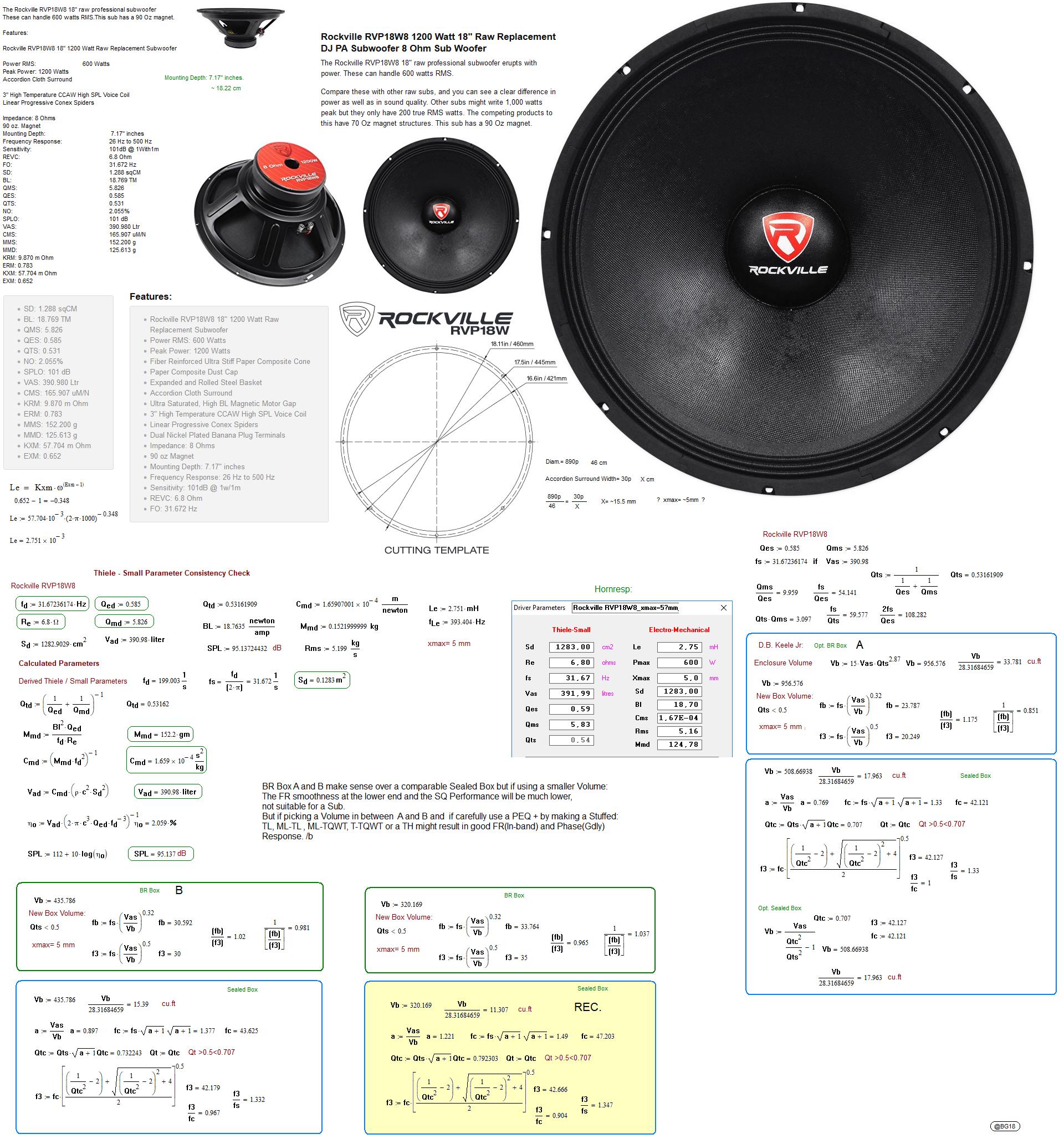

I see the ? 5mm ? in the sheet from a user here on diy audio (thats the one I have included) however I'm not totally sure if thats actually the real xmax since I've already bumped them harder then that in a gsub case, so thats a guess based upon some educated math, but isn't actually from the manufacturer (who refuse to give me the xmax btw cuz its all through audio savings so you get their customer service not a techie)

Yes. The basic rules of reflex sub design is larger boxes and lower tuning reduces power handling, so there are always tradeoffs to make for any given driver.

Check the help files in WinISD. When port air velocity exceeds 17 meters/sec it begins to generate audible noise, so the more power you throw at a design the bigger the ports need to be.
I have no idea how to change over to that in winisd, clicking it didnt change it.
Click on the wrench(go into settings), all graph parameters can be changed there.
Those specs look believable and potentially appropriate, did that other member run tests to come up with those specs? I have never seen any manufacturer specs for this far east gear so that would be the only way to come up with them. How much power have you pushed through these in the Gsub enclosure? There is no free lunch, you can't get more output and lower response in a bigger enclosure without an increase in driver excusrion and every driver has it's limits.
It's highly unlikely these drivers have more than about 5mm xmax just based on their construction, look at any modern high excursion sub driver and you will see a bumped back plate not the flat plate that this driver has. Xmax is the one way linear excursion the driver can handle and maintain control of the cone. The cone can usually move more than this(sometimes only a few mm more, sometimes much further) but distortion increases dramatically and the relationship between increased power and increased excursion degrades such that it usually only takes a relatively small amount of extra power to reach xlim.. which is where the voice coil hits the back plate. This will be a metallic POP sound on dynamic bass hits, if a driver is pushed this hard repeatedly the voice coil will be damaged and the driver destroyed very quickly.

First off thanks for taking the time to explain things to me instead of just telling me not to do something.
I found the option to change it so now I have rear port air velocity on m/s and its nowhere near 20, tops out at 8.3m/s at 25hz.
So this means the only issue is the xmax then? Is cone excursion and xmax measuring the same thing or is there a calculation I'm missing here?

Xmax is maximum cone excursion.

Your drivers are somewhat of an oxymoron in themselves. The high Qes (weak motor) and high Vas, demand a very large cabinet with a low tuning to give a nice frequency response. But as far as Xmax goes, they are made for small cabinets (10 - 15 ft^3 for the pair) with a tuning at or above 40 Hz.
Your approach is going for quality at the cost of quantity (output) so don't stretch it there. Not even going down hill, with the wind in your back that's a 600 Wrms driver, so don't treat it like one. So it's really about finding a balance between quality and quantity. Your current enclosure, with 300 W per driver and a steep high pass at 30 Hz, is probably somewhere around the edge of what they're capable of.
Your port is roughly 4 times as large as it needs to be, so it is well below 20 meters per second.

Heres their spec page:
Rockville RVP18W8 1200 Watt 18" Raw Replacement DJ PA Subwoofer 8 Ohm Sub Woofer - Rockville Audio
The spec I included was a diy member double checking their specs.

A loudspeaker has 2 excursion limits, one is called Xmax, the other Xmech.
Xmax is maximum linear excursion, beyond this point the cone moves increasingly non-linear (so not just back and forth anymore), increasing distortion while the driver looses control of the cone.
Xmech is maximum physical excursion before damage, either hitting the voice coil against the back plate (destroying itself in the process), or launching itself out of the gap on the other side, move side ways and then get stuck.
