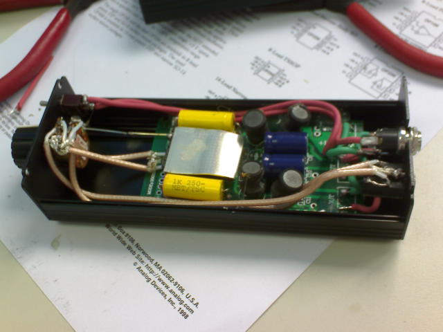

Here are the Photo's of the per-posed boards, it uses several low cost IC's for several tasks,
CN1185 for battery check
CN5136 for the DC-DC bit
CN3063 for the solar charging
PAM8303D for the amplifier ( 2X )
i will sell the board if it lives up to my expectations.
and then i want to sell it in combination with flexible solar panels of 1mm thick and Ive found some 3" Vifa speakers with neodymium magnets, that are light weight, i also have 2" Aura speakers for this.
I think Polymer cells are best, with solar you can hardly overcharge them, and they come with protection board for under and over voltage.

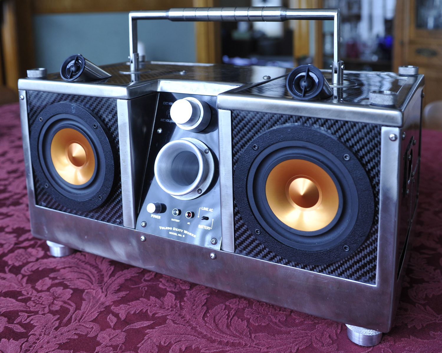

I hope that this thread is still getting a little attention...I've been working on a setup with pretty good success. I'm using the ta2024 board with the liions and getting really great results. I'm just putting them into a center channel speaker and screwing a handle to the whole thing...
