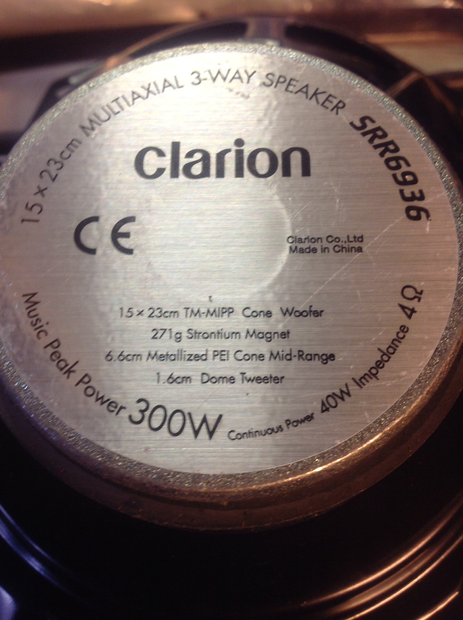

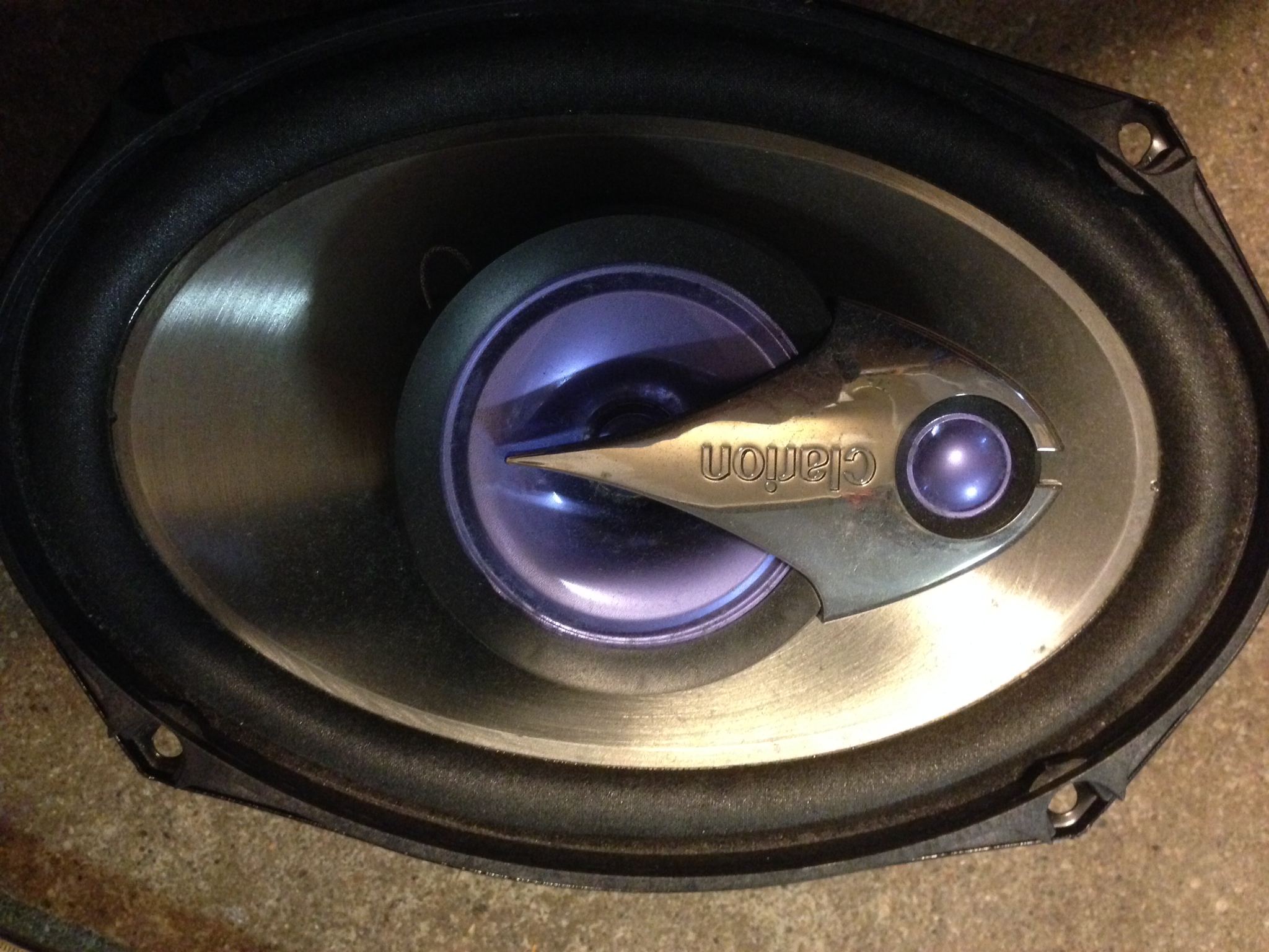

I have searched and read a lot on this forum and i want to try and build myself a portable boombox based on the lepai 2020a+ Amp
As i am a student i dont have a 1000$ to fund and build the boominator (unfortunately)
my budget is more or less 200$ more if its justifiable to meet my needs .
I am not expecting this thing to entertain 200 people - but would like it to be able to entertain 8-12 people if you understand what i mean.
I have bought the amp on ebay and expect it to arrive in a month or so.
I would therefore like to have all other parts sorted out before that.
I have 2 decent car speakers laying around that i was thinking about using those. I will attach a picture so you can see what i am talking about.
If those speakers are stupid to use i would love if somebody could give me advice for what to use then.
Battery wise i was thinking about one or 2 of these - the 12v 12Ah weighing 4,39kg

Have you tried contacting Canopy Sound kontakt@canopysound.dk and ask if they still have the Aura NS525 driver for the Boominator MINI? If not do so quickly as they're only DKK89 each so you can easily build a MINI for around $200. They ship to all nordic countries.
If you want anything sounding good you'd have to dump the carspeakers idea. It's possible if you just want sound for not that much money. You'd have to have a battery, amp and speakers. That's it. USB charger can be made with a simple car cigarette lighter 12->5v usb converter. You want one that is as efficient as possible.
If you want anything sounding good you could build a halfinator, mini boominator or wait untill Saturnus releases the Micro design next week.
