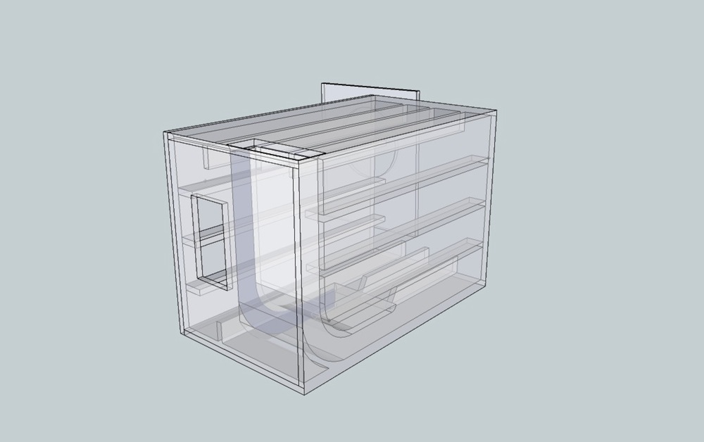

As long as the port is not designed to have high velocity (faster than 15m/s) a bend will not do much to the wave flow.
the pic is a design for a 12" sub with 14mm Xmax that is tuned to ~15hz and 14m/s max at full output. the bend does nothing to the output when compared to a strait port of the same dimensions.
design the port right and it won't matter.

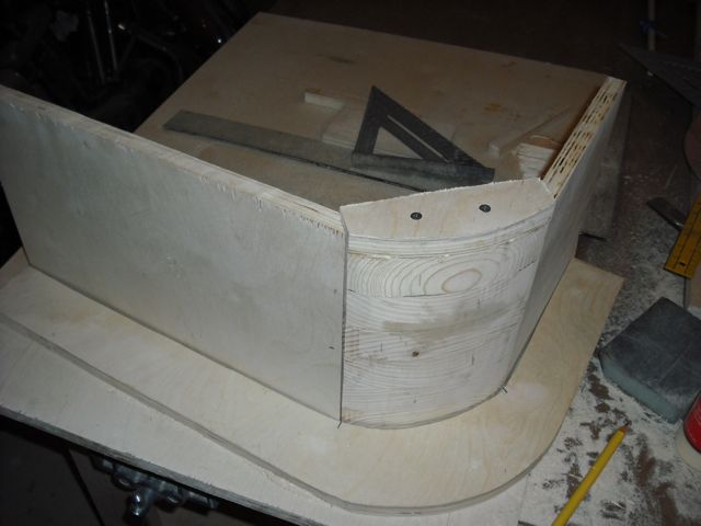

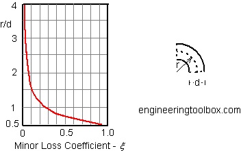

I'd much rather have 90 or even 180 degree bends to make up a port, ideally with some mild treatments to "smooth" out harsh angles, than a port that is too small.
