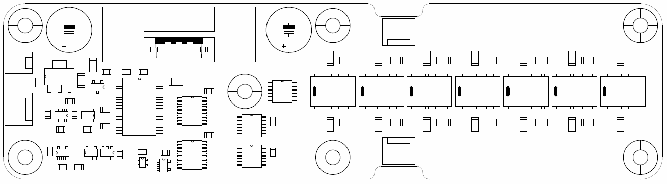

It is almost 3 years since I released V1 of this attenuator and 2 years since I mentioned making a V2 of it.
V2 will be ready in 3-4 weeks, I am done doing the layout, just need to make the Gerbers, order PCB's, components, assemble a board and do some testing.
The design is very close to the original but with some necessary changes/improvements.
Some info :
127 x 0.6 dB steps for an attenuation range of 0 to -76dB
10K impedance.
Onboard regulators, 5VDC for the digital logic and 5VDC for the relays.
A size of 150mm x 40mm.
Made a few improvements to the digital logic and a few bug fixes.

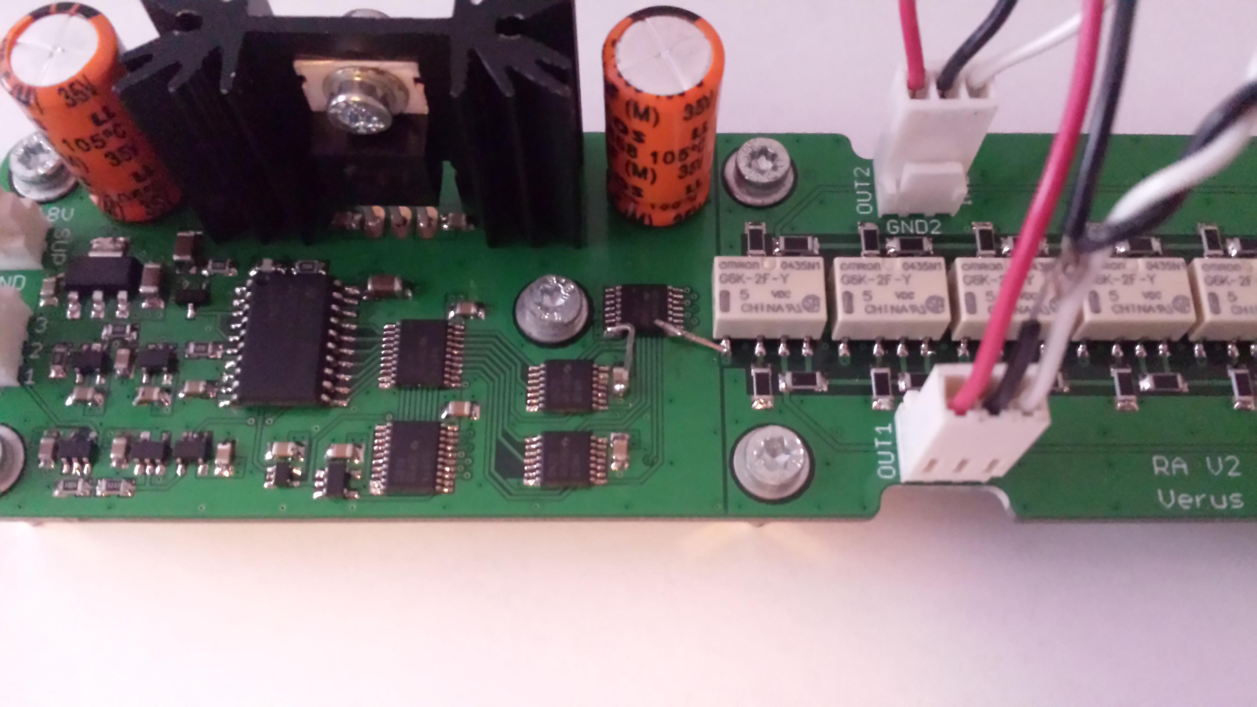

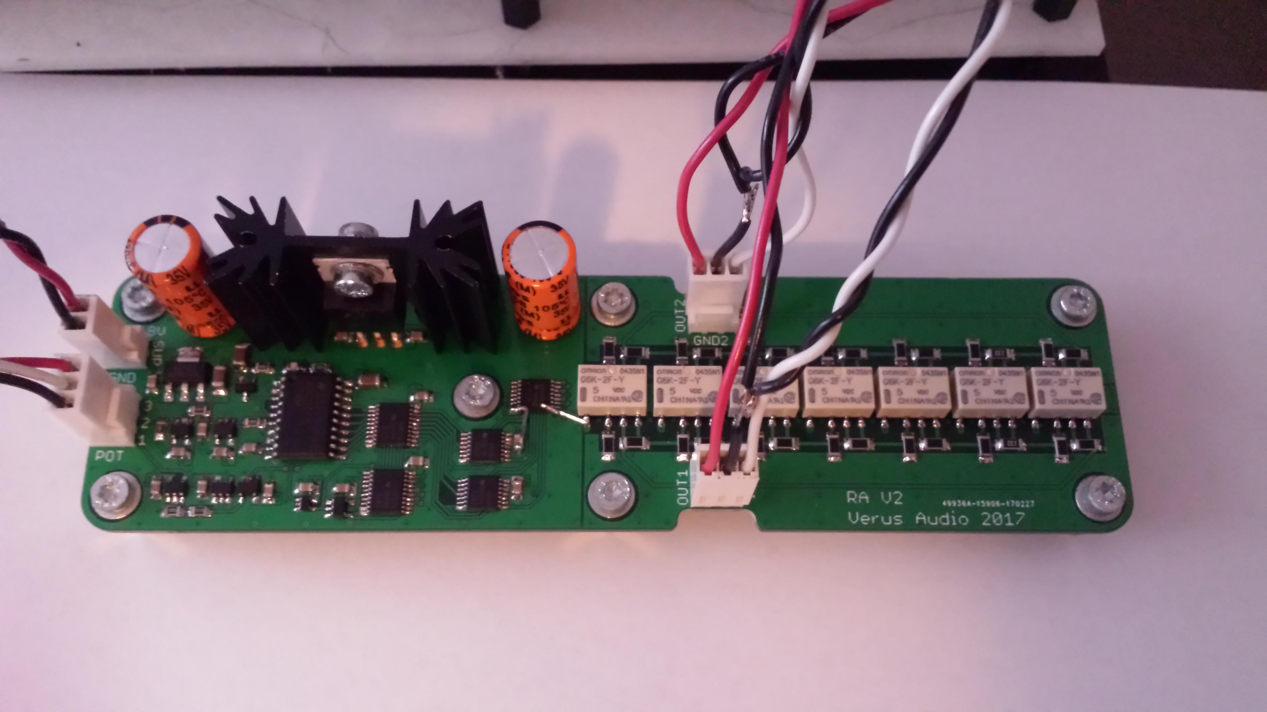

It took some time but it is finally done!
It had just 1 problem first time I turned it on, it didn't bloody work.
However the ULN2003 relay driver was getting pretty hot and there was 5 Volt at all outputs with the volume turned all the way down or all the way up. Turned out I made a schematic error, the ULN2003 Relay Driver should have PIN 8 GND connected to GND and PIN 9 COMMON connected 5V used for the relays. I had them switched on the schematic and therefore also on the board.
Luckily I just had to lift the PIN 8 GND and PIN 9 Common legs and sold them to the right connections, by using 2 clipped off and correctly bent legs from a LED and it worked.
Anyway now that it works I can safely say everything I wanted to achieve with V2 has been achieved. V1 could be a little unstable at times, relays going into constant chatter mode requiring you to turn the pot a little.
The changes I made in V2 removes this error mode, if it does happen and the POT voltage is just between 2 steps the relays stop changing state after between 1 or 2 relay cycles, that is 10 ms and 20 ms respectively and then it will stay 100% stable until you touch the volume control again.
All in all, I am very happy.
Did you consider right - left balance?
As it is now, with 0.1% resistors in the attenuator, channels should be better matched than 0.1dB at ALL volume levels.
EDIT : Just calculated it, the channels should be better matched than 0.02dB which should be plenty.
