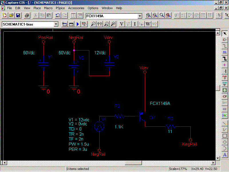

The load: IRFP250
I calculated 1 amp drive current based on 100nC gate charge for 10Mhz. Yes? This is for a PWM application.
That should turn the sucker on nice and fast in the worst case I thought.
Now then..for the driver transistor...
After many hours of searching, I came up with the zetex FCX1149A, which is identical to their ZTX1149A, different case, handles twice the dissipation, slightly better Hfe.
I chose this one for it's ultra high beta and current rating, I can't go with a darlington as it would leave me with too high a base current requirement.
I couldnt' get it to work very well at all....couldn't figure out why it was switching so poorly..
So I stripped everything else away (I'm in spice land), and just tried switching the driver transistor through a 1 amp resistive load of 11ohms.
It switches so slowly the best I get is a sort of triangle wave out of it, even though I get the current I want, it's useless switching so slowly.
Ft is 135Mhz according to the data sheet, Ton=150ns Toff=270ns. Output capacitance 50pF. It should be able to handle a 1Mhz frequency I thought....it doesn't.....it doesnt' even handle half of that well.
What did I do wrong in the selection process, I thought this would work great.
I need some input here because if I can't select them better than that....may as well give up now.
Chris

OK, question: you are assuming that the puls generator floats atop the negrail. Did you check that? Many simulators *automagically* assume that any source is sitting on ground. Try to do it with all those voltage sources deleted, the puls generator against ground, the collector resistor to ground, just a pos battery for the emitter supply. And that 1.1k in the base lead doesn't help either, 50 ohms is better if you want just to test the transistor.

- At fT transistors has 0dB current gain.
- BJT's switches off veeery slow, if they were saturated. Saturation must be avoided. Check out shottky-transistor!
- 1 A is not enough for 10MHz, since it has to turn on, and turn off during a period! 1/(100ns+100ns)=5 MHz.
- The charge must be loaded to, or sinked from gate at Ugs=4...5V. At this voltage only 0,4A flows on 11 ohm.

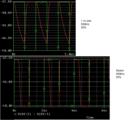

Yes, that's a very fair question, and a good one...I saw it comming. I know multisim would never accept that ..this program does, I of course, did check that.
The reason I chose 1.1k..
Under these conditions I reasoned min Hfe according to the data sheet graph =200.
I used 100 for calculation...more than safe I thought.
so for the 10mA required at the base=1.1k....half of what "should" work. IRL...I'd take required base current X3..but this is spice, and I reasoned I had already left enough of a margin of error by using Hfe 100 instead of the 200 it actually should be.
Am I wrong? Looks like it..but why?
50Ohm or 1.1k ohm ....still gives me my 1 amp of course. I think the 1.1k should do a far better job of switching it though. I will attach a pic of the results given the same circuit with the two different base resistors driven at 500Khz and an easy duty cycle of 50%, I think you'll agree it's useless for PWM at even that slow a speed, even with the 50ohm.
At 50Ohm it measures 325n off delay, worse than the 270n it's rated at. It will have a baker clamp ...should I really have to overdrive it like this just to get it to fully switch? I would think not.

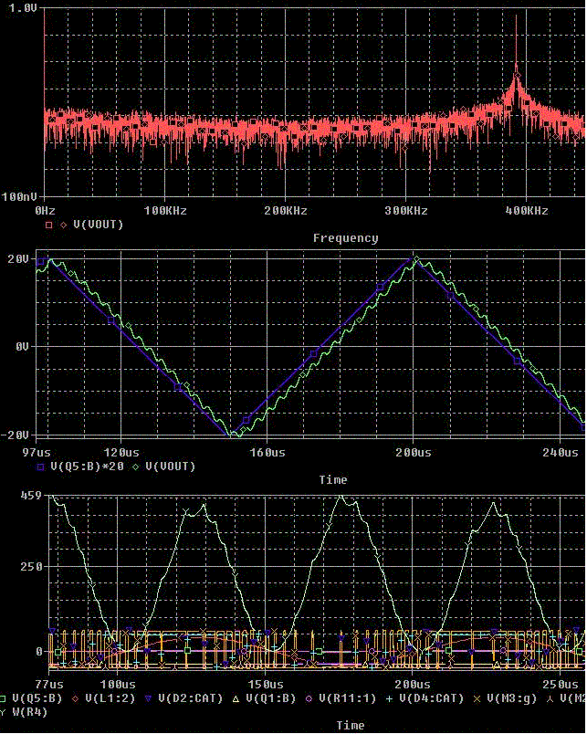

Regarding the 10Mhz, working frequency of this circuit will be around 350k PWM full modulation. So again it seemed to me that 10Mhz was enough of a margin to calculate required drive current with, to allow it to swith on /off in 100ns.
Pafi, You are correct Sir, the gate resistor calculates to 5ohms in my actual circuit, the reason it's 11 ohms here is because it's not the actual circuit. 11V/1amp load =11ohm..just to see how good it can switch this current.
Jan, that's a respectable looking wave, do you only get 200 to 500mA out of it? Too bad..Guess that's not my transistor either.

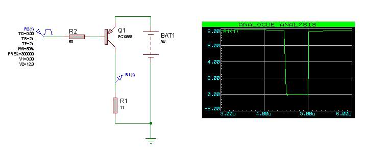

Well, my graph showes 8V across 11 ohms from a 9V battery, which for a small signal transistor is good (VCEsat=1V), and the switching speeds show that it works. It's really a trivial cct of course. If it doesn't work in your case, it's not the transistor, believe me.
Did you try with the puls gen against ground? How did you check that the floating puls gen works?

The problem is saturation (at 50 ohm drive), and insufficient basis current (at 1k).
Look at this: http://www.hszk.bme.hu/~sp215/elektro/stuff.gif
Or this one: http://www.hszk.bme.hu/~sp215/elektro/stuff2.gif
The 10 nF is simulating the gate capacitance.

janneman said:Well, my graph showes 8V across 11 ohms from a 9V battery, which for a small signal transistor is good (VCEsat=1V), and the switching speeds show that it works. It's really a trivial cct of course. If it doesn't work in your case, it's not the transistor, believe me.
Jan Didden
Yeah I said it looks good, but it doesn't get the job of sourcing an amp done, is all that I meant. This isn't government work According to my simulation, you only get 375mA out of it.
The floating pulse gen. works..it's the green line in the graphs I posted.

Pafi said:The problem is saturation (at 50 ohm drive), and insufficient basis current (at 1k).
But why don't You use driver IC?
Two good reasons, my lab consists of my computer..they're impossible to simulate, and rarely find models of them, the driver you mentioned isn't one I've seen before, but it sure looks promissing.
The main reason is...it goes against the UCD design..of symetrical non saturated very fast transistors. I don't think a driver chip would be an improvement on that...even if I could get a working simulation going of it.
Once I get the simulations as perfect as I can, I plan on just prototyping it up and watching it smoke

Hi Chris,
now that I know your intentions you have my best wishes. I have been doing SMPS design professionally for many years, but I would not dare to design anything switching without a scope, unless using a previously proven design or blocks. It might be a professional deformation, but I feel naked without a scope. On the other hand I know a very bright guy (he is now a university professor, but he could teach some professors when he was still a student) that can do gigahertz ham radio designs only with theory and analog multimeter. Maybe you could post your schematics for comment before you actually start building?
Best regards,
Jaka Racman
Best regards,
Jaka Racman

I draw this some time ago thinking in fast MOSFET drive for low voltage SMPS, but I think there are also some useful ideas for class D
This shows the latter circuit in action, driving an IRFZ48V from simple BC337/327 bipolars and 10ohm Rg in a push-pull circuit [turn-off from conducting 60A or so]. Leftmost trace is Vgs at 5V/div [I use 18V drive], rightmost trace is Vds at 10V/div, time is 200ns/div and gate is discharged in less than 120ns. This also shows that high current MOSFETs are not perfect and suffer some degree of 'current tail' and 'storage time' effects as opposed to what common wisdom says
In the other hand, with ZTX851/951 bipolars configured as a simple class-B buffer driven from paralell CMOS buffers I've got performances as good as 50ns or less charge/discharge times for an IRFP460 switching 300V [including 'miller' capacitance effects, very noticeable at these high voltages]
