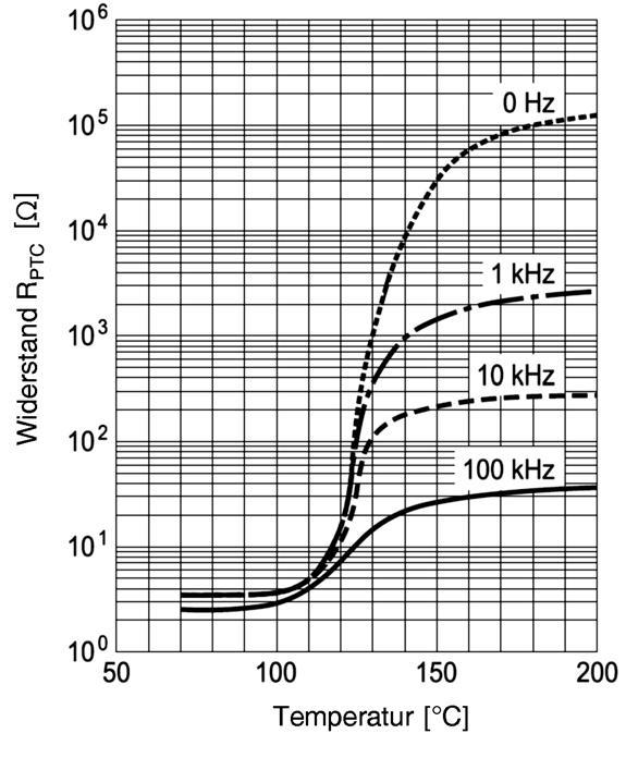

Thank you Wolf,
i found some information on characteristics
of PTC resetable fuses, unfortunately the
text is in german language only:
http://www.controllersandpcs.de/lehrarchiv/pdfs/elektronik/pass01_04x.pdf
The rise in resistance between "normal" and "tripped"
state seems to be highly frequency dependent.
Especially in the tripped state, there is a capacitive
component.
Nevertheless the elements seem to be usable quite
well for the purpose, see attached picture ...
