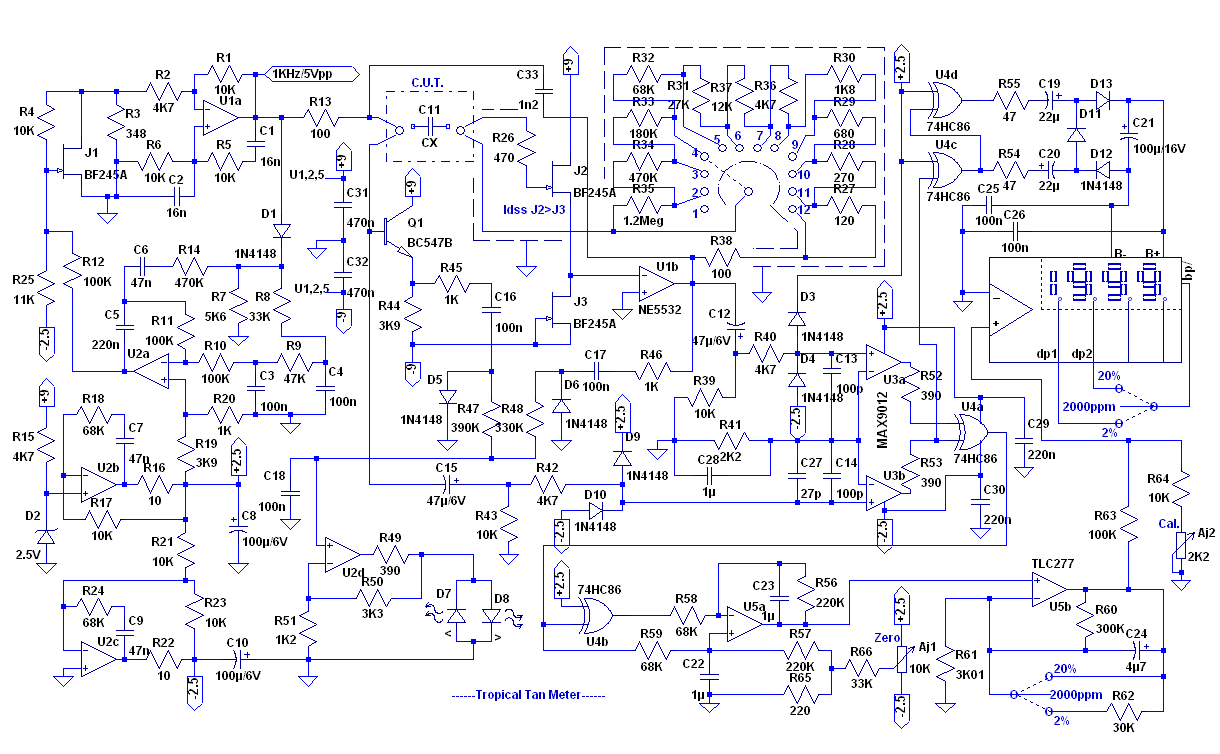

PFE210 caps have both excellent accuracy and near record tan-δ (62ppm for a 100nF), but so very long out of production that only the lucky few have practicable values left.

41Hz Audio:Cap 63V Film 215pF Polystyene

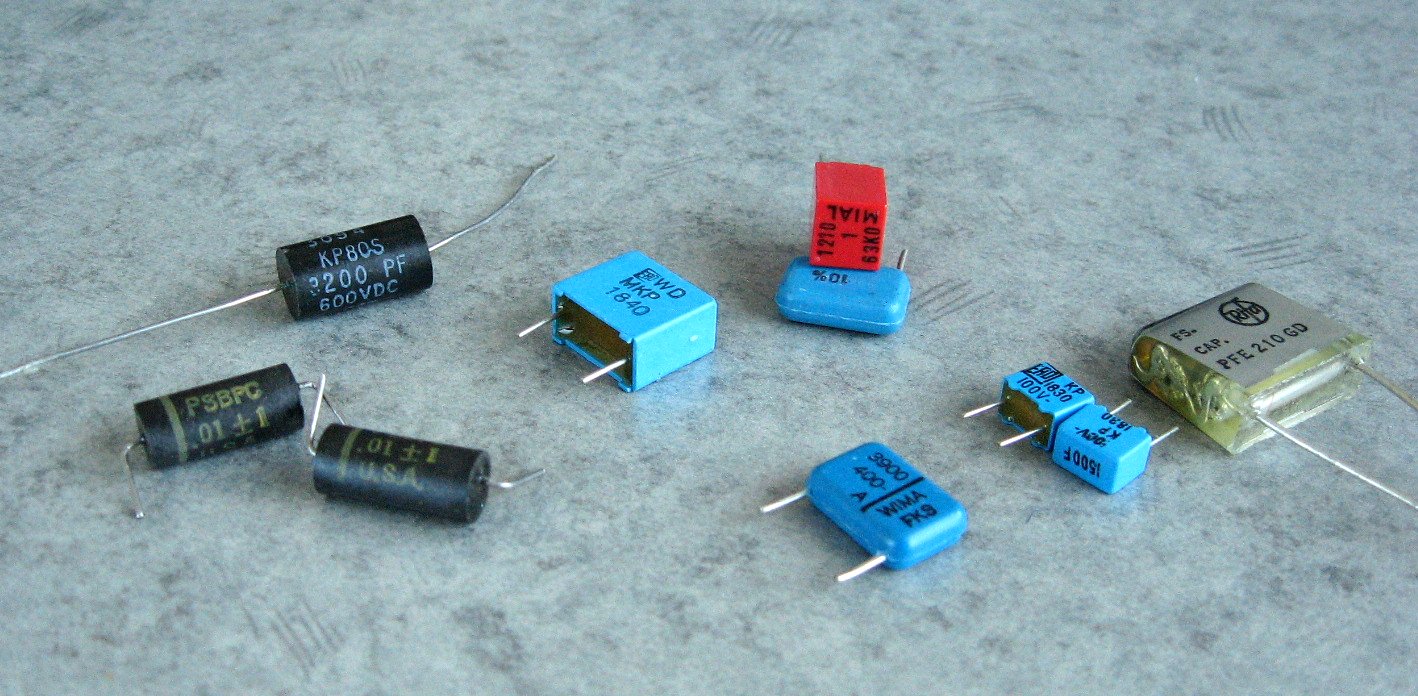

Here are some of the caps I've picked up via Ebay/local surplus. The two black caps in the lower left hand corner are PSBPC caps froom American Radionics. I suspect they are polystyrene, but I'll have to crack one open to make sure. The black, long leaded cap above them is a STK KP80S polypropylene film/foil. The largish blue cap in the middle is a Roederstein MKP1840 metallized polypropylene. The red cap propped up on the blue one is the Mallory polystyrene box cap I mentioned. The blue cap in the foreground below it is an old Wima FKS series film/foil. I just looked it up, and its polyester film/foil - too bad. The two tiny caps to the right of it are Roederstein KP1830 polypropylene film foil - these are what I'm using in my jfet active crossover.. The cap to the far right is a Rifa PFE210. It's one I'm considering for a tube-based RIAA amp. It's 7.41 nF, which is right near the value I need for the upper break point. I'm thinking of using an STK KP80S 22nF cap for the lower break point.

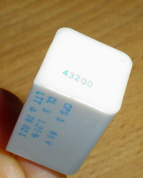

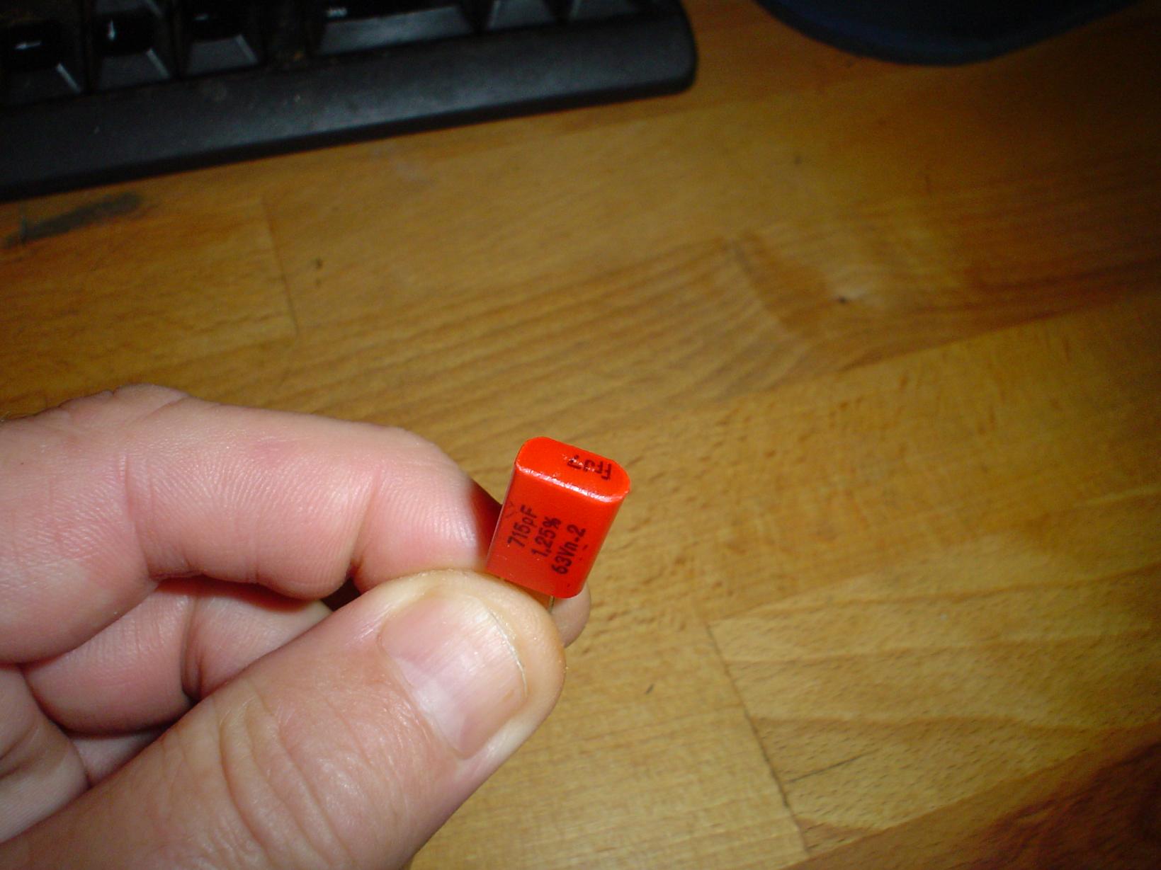

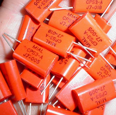

MIAL was Mallory owned ? Didn't know that.
I've got a whole bunch of MIAL CPS3 caps, CPS is the French abbreviation for Condensateur Poly-Styrene.(or Plastique Styrene)
(i'll post a picture of a Precis CPS3 cap tomorrow, a Frenchie too)
Got the straight scoop after some searching - Mial was a German capacitor company that was acquired by TRW. TRW capacitors were acquired by Shizuki, and are now American Shizuki/ASC. I should drag out some of the various polystyre caps I have and sort out who made what. If you have Mial capacitors, they are pretty old, as apparently the company was acquired by TRW in 1978.

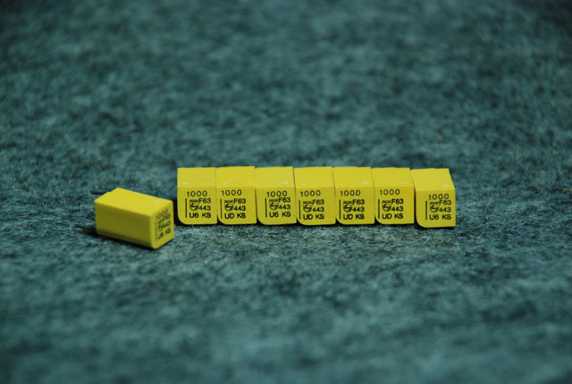

The fun part of being an old and less hairy fckr nowadays is that most know JS about old production parts, not even traders, example is a Philips (label) KS443 box type cap.
Those are excellent polystyrenes (quite popular in DIY Japan btw), but funny enough harder to obtain here in the g.o.d than the ones described earlier.
TEDSS in South Carolina offers a couple of KS443 values for $0.05 each, for 500 minimum. (hasn't been interesting for me due to the high foreign mail/handling cost)

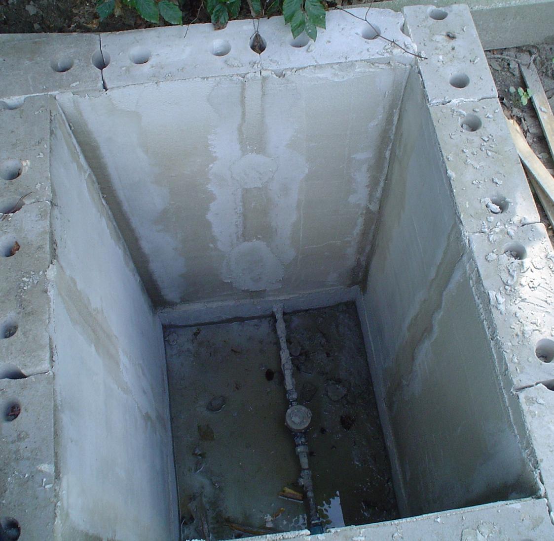

(i turn jello when i talk epoxy resin, made all kinds of composite stuff with it, from home construction to a 40ft sail yacht.
My hands-on experience with it ranges from navy vessel sonar domes to commercial airplane parts, from automobile body filler to garage floor epoxy coating. I'm currently working on an all-new pit for the water meter, 5ft deep, will also receive an all-side epoxy coating.
Manufacture date of resin sealed/filled foil caps doesn't bother me. )
