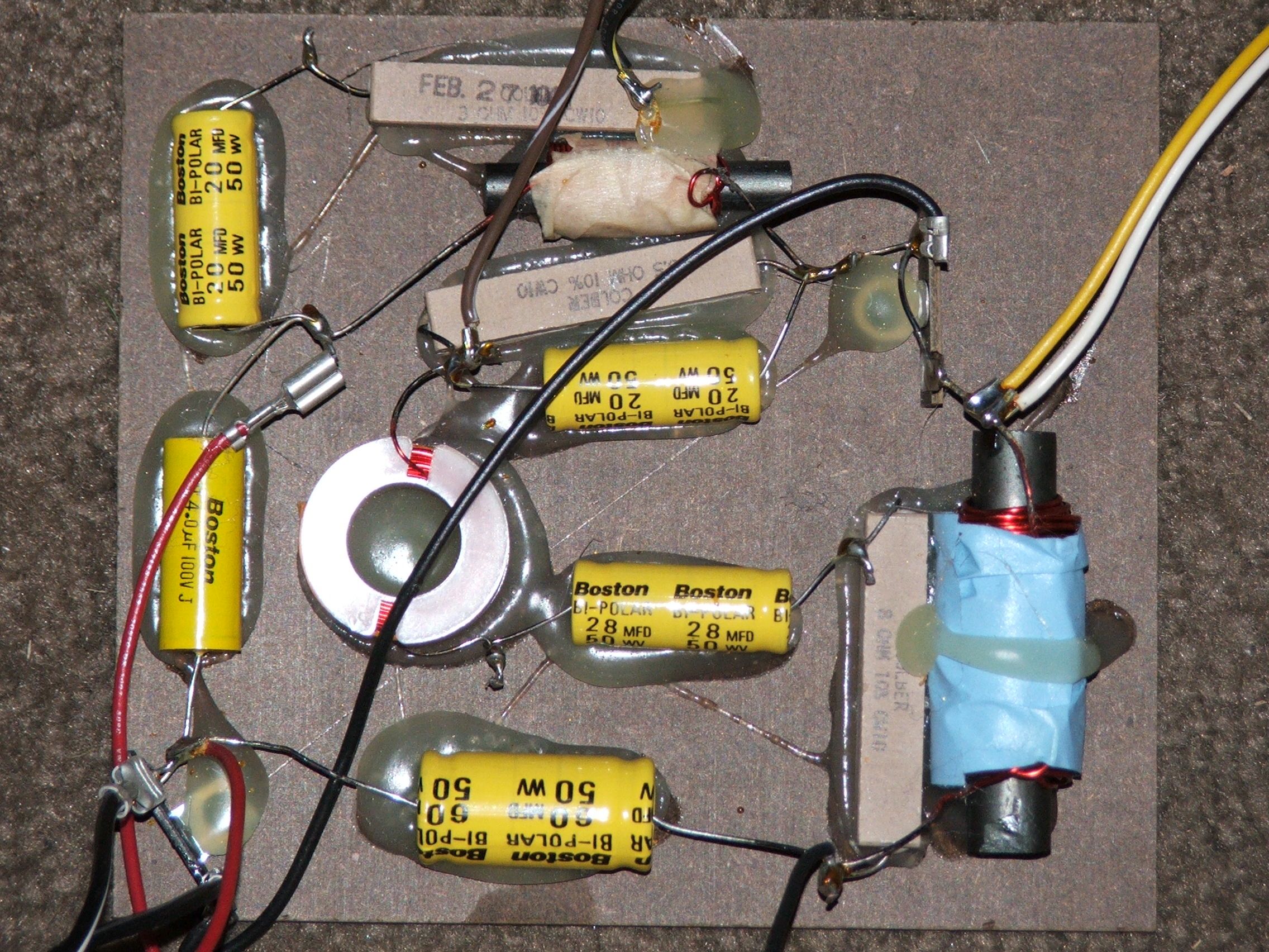

Engineers aren't always in charge of those decisions and some designers don't know any better anyway. I've seen the insides of some NHT, they definitely cut corners when and where they could.
Pictures of two different crossovers. The very sloppy one is from a large very well known company.
I'm sorry, I seriously doubt that parts selection corners were cut in NHT's $4000 speakers. And where good speaker companies DO cut costs, the engineers are smart enough to optimize the designs for the parts they're going to use- that's why those are good speaker companies! Simple one for one parts replacements might make you feel good and make you feel like you're improving the designs without having to go through the hard work of getting a design optimized within constraints, but that's often not the case. And in the case of solid, smart engineering like at NHT of yore, it's almost certainly not the case.

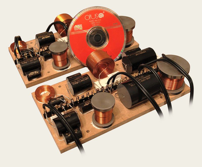

A crossover can be designed by a clever and thorough engineer or by a hack. In either case, the layout can look "sloppy" or have beautiful eye appeal. The bottom line is, how does it perform as part of a system design? Photos of eye candy don't reveal the answer.

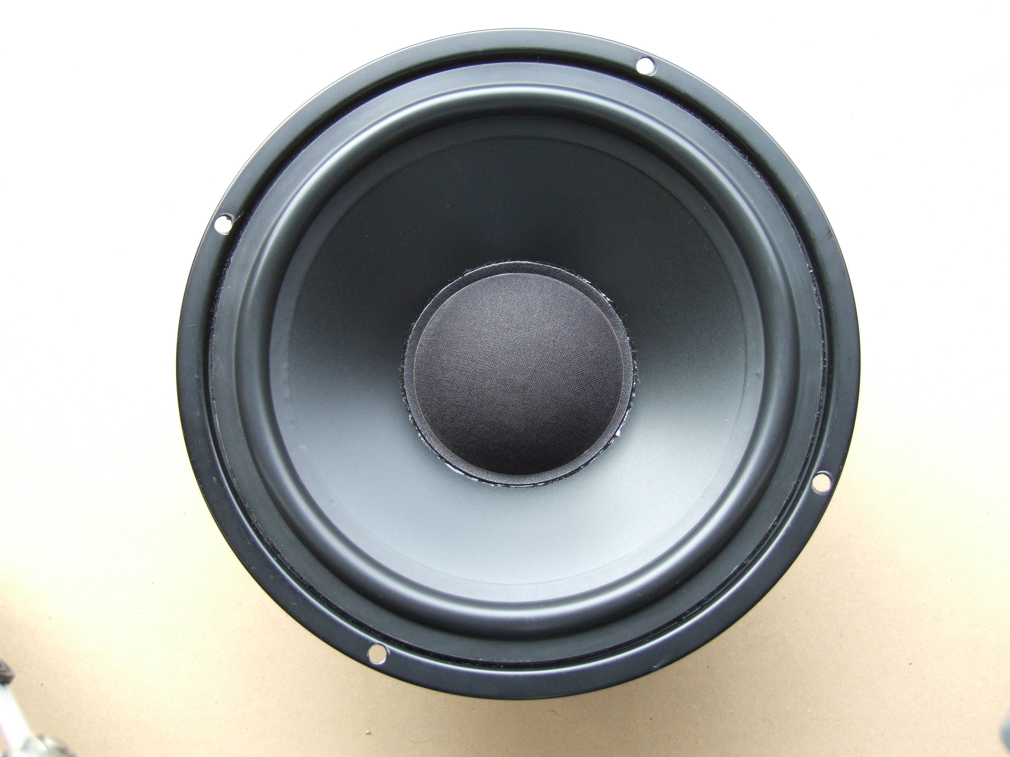

Most of the drivers are run of the mill with stamped frames, nothing exceptional. Various offerings made by Peerless or Foster. I actually have some 8" NHT surplus in my garage (and some Klipsch stuff too) Not bad components, not top shelf either. There are a few standouts, you just have to love that NHT 1259 woofer.
