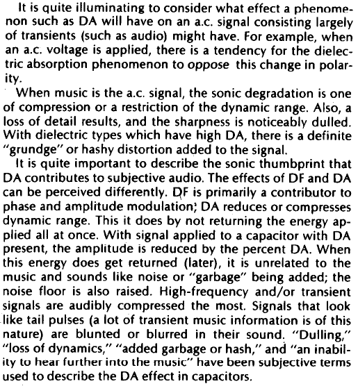

Walt jung's article Picking Capacitors part II has a description of how DA causes "distortion" of audio signals. Certainly to a layman like me it seems to be plausible. The attachment is just a small extract from the article. Both part one and part two are available on Walts site, where he gives quite a thorough (I thought) coverage of why you would want to use various types of capacitors in preference to others.

DA doesn't give additional frequencies - its an entirely linear form of distortion. A capacitor with high DA can be modelled by adding long time-constant series RC networks in parallel with the original. Ceramics on the other hand can add distortion, but this is due to the dielectric having a voltage coefficient, not DA.

This is a purely subjective interpretation, and is totally unsupported by "hard" measurements.
Walt sort of implies that DA behaves like an audio delay line, which is not at all the case (in objectivist terms, again).
The actual representation of DA consists of distributed RC circuits.
That said, dielectrics having a high DA often have other types of imperfections, including non-linearity, which could explain a number of confusions.
Well yes Walt doesn't present any test that specifically demonstrates the effect of the DA on the transients in a music signal as he hypothesises (I imagine that with the measurement equipment available today this should be possible to prove or disprove). The only objective measurements are of the actual DA of various capacitor types using a test based on the mil standard test for DA.
