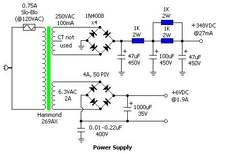

Bas Horneman said:
That all depends on how one likes to build their psu's..some like to have reserve current or full dual mono psu's ..in that case get 2 transformers...
So far I've just used one. And have gone psuedo mono by splitting of after the first rc or lc network and having a seperate rc for each channel.
The 2 transformers that i have pasted here are those the correct valuse ? Ill order 2 : O ) but what one ?
I'll have to answer you tomorrow..this is the second night in a row that I've gone to bed 2:30 am...I think I might give you a wrong answer......ok... I'll try anyway..probably can't fall asleep anyway..The 2 transformers that i have pasted here are those the correct valuse ? Ill order 2 : O ) but what one ?
I think the 269AX looks suitable with its 125-0-125 you will need to connect the tube rectifier (if you are going to use one) to 125 and 125 (leave 0 disconnected...) to give you around 250VAC (use hybrid graetz bridge to derive a 0) to arrive at around 220DC as suggested by John Broskie. Tune the voltage with the first cap...

What transfomer should i buy. ? I need to buy 2 of them one per channel.
I just had a search for the 269AX..and it fits the job like a glove.
here is another example of a psu for the Aikido...although the voltage b+ is too high..(you can "dial" in to the right voltage by using a smaller first cap
