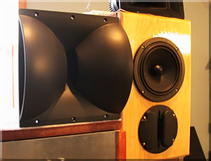

I don't normally use this PSW10. I actually bought it for evaluation. I wanted to see what a budget sub is capable of. A few of my subs are in the picture. A Push/Pull, a BandPass and a Sealed. There are more speakers and subs out of frame. I really need a bigger space.
Should it decide to die on me, it's not a problem. I've got plenty of backups. There are at least 5 electronic crossovers on my shelf. And being a designer, there are a lot of high powered amps in my lab.
