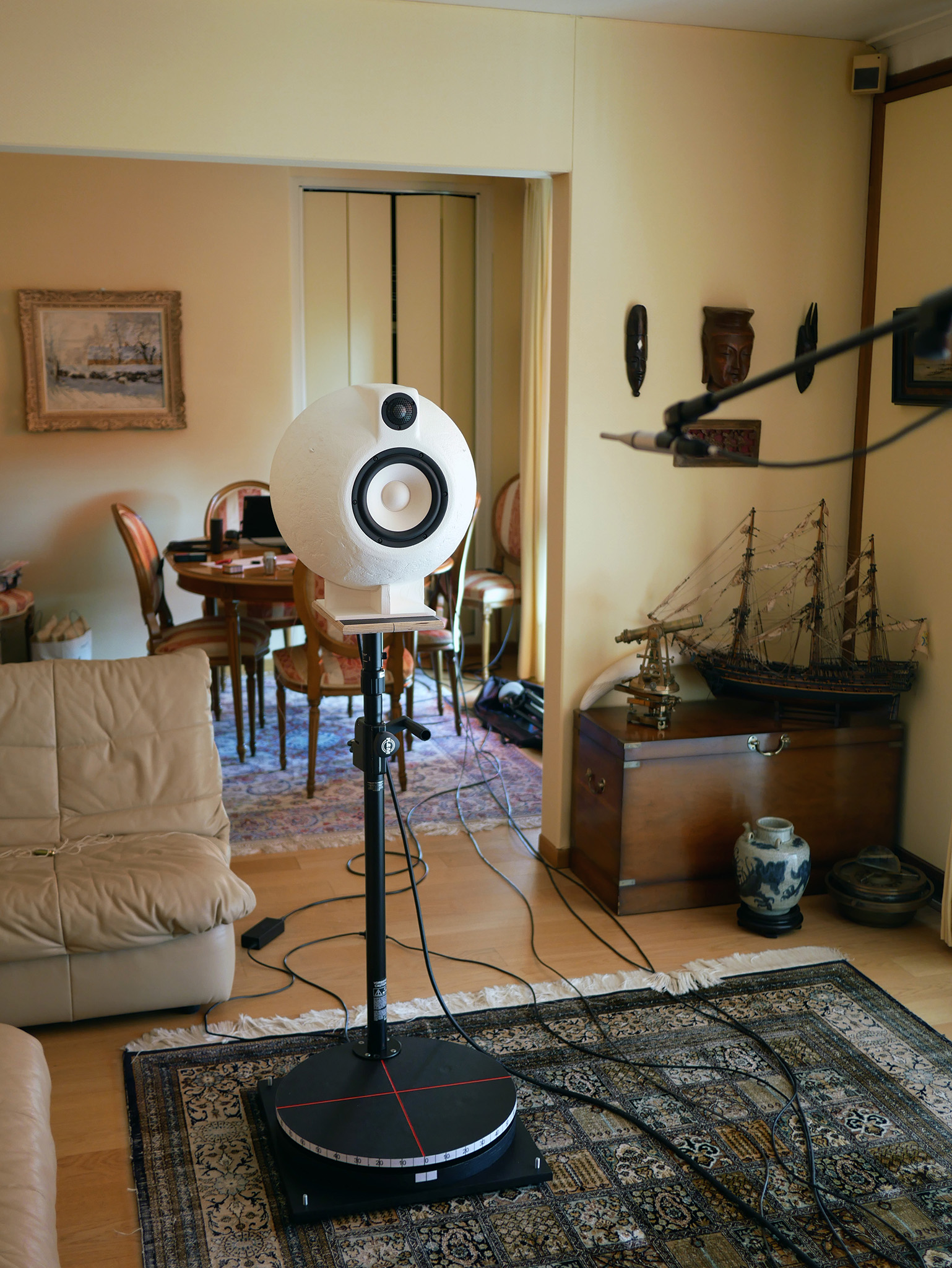

Polar measurements with automatic turntable

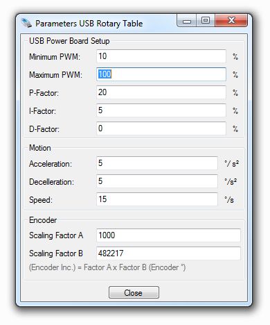

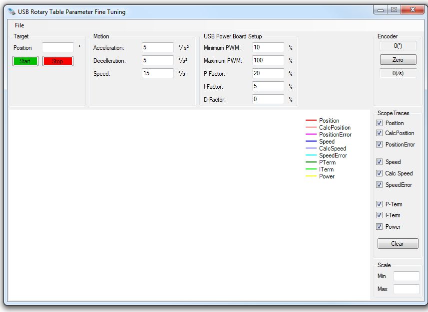

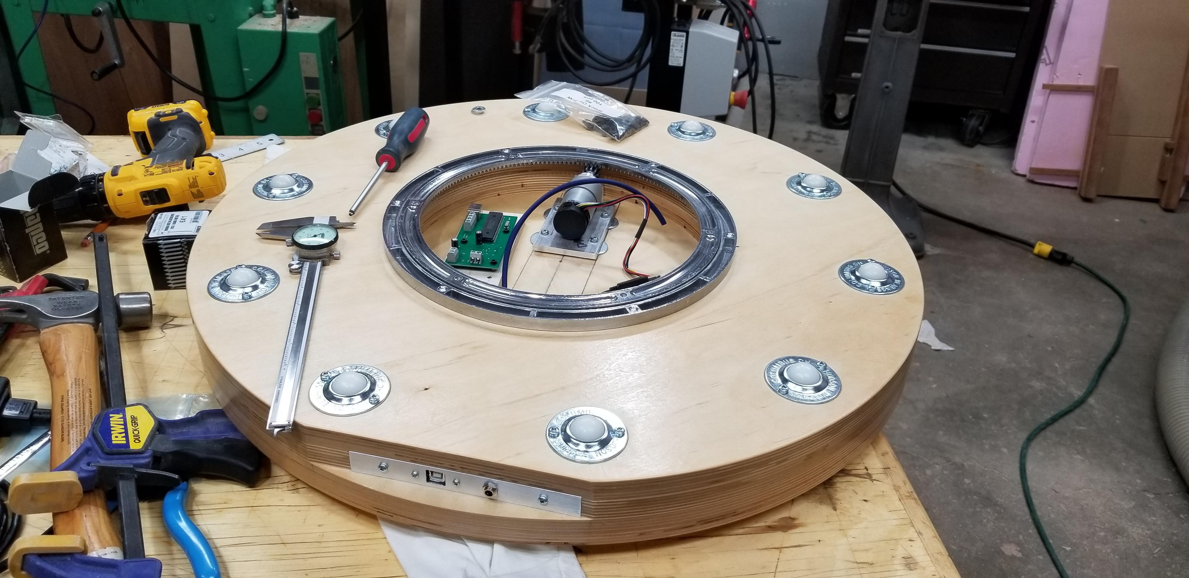

I will be doing the final wiring on my Arta turntable tomorrow and giving it a spin, but I could use some help with setting it up.
I am using,
- Hefter 330mm slewing ring
- Mädler 11 tooth gear
As shown in the Arta table documentation, but for a motor I am using the,
- Pololu 150:1 Metal Gearmotor 37Dx73L mm 12V with 64 CPR Encoder.
What parameters will I need to adjust in the following two windows?
- Parameters USB Rotary Table
- USB Rotary Table Parameter Fine Tuning
I expect Scaling Factor A and Scaling Factor B will need to be adjusted?
Any help would be appreciated.
Thank you, David.

I have a motor with 131:1 / 64 CPR, so the scaling factor will be different with your.
I played around a bit with the Acceleration, Decelleration and Speed to get the turntable to behave as it should with the load i put on it.
Here's my config:

Hi David,
the calculation for the Polulo 150:1 gear motor is as follows:
Scaling Factor B = N/n ∙ U ∙ I/360 = Impulse/°
N = 176
n = 11
U = 150
I = 64
B = 426.666
If A = 1000 --> B = 426000
Regards
Heinrich

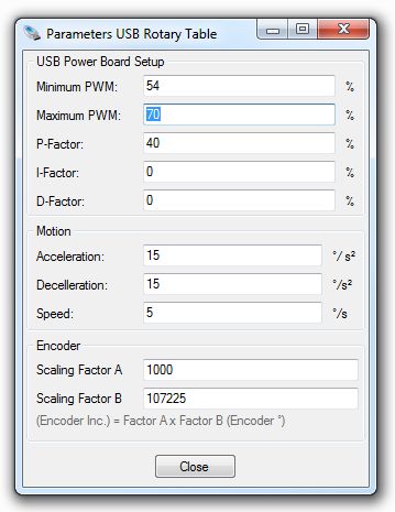

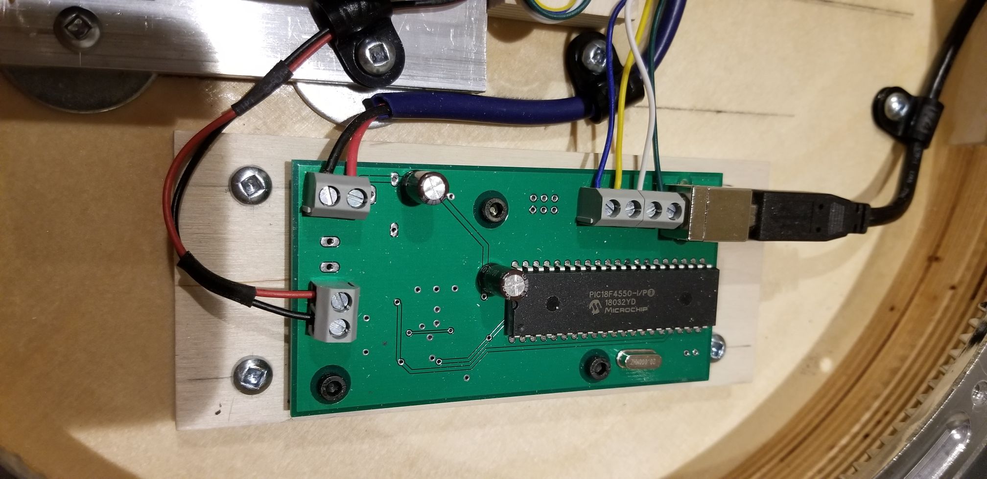

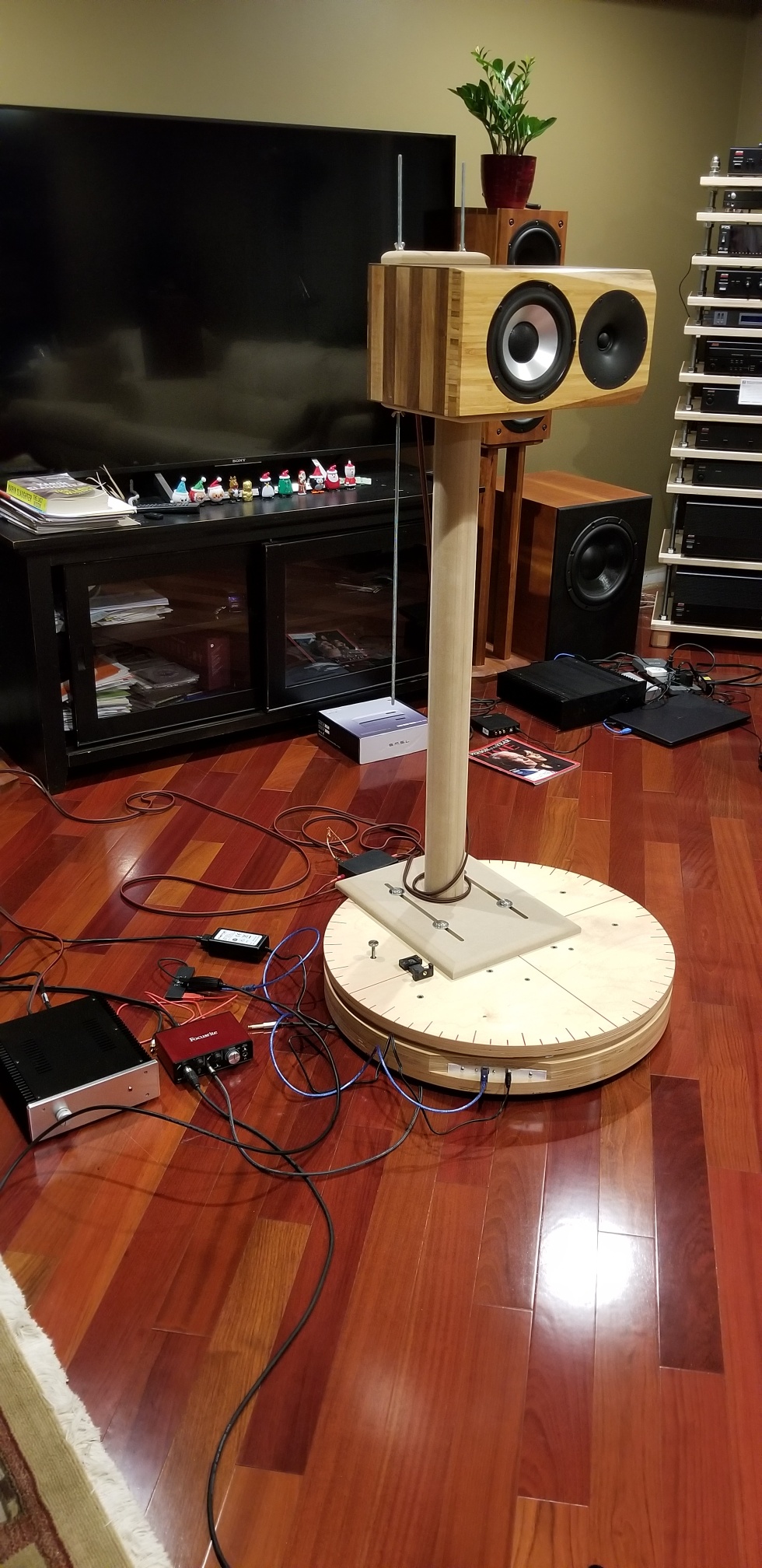

My ring gear is 178 tooth (both my wife and I counted it :) ) and here is the math I came up with,
N = 178
n = 11
U = 150
I = 64
B = 431.515
If A = 1000 --> B = 431515

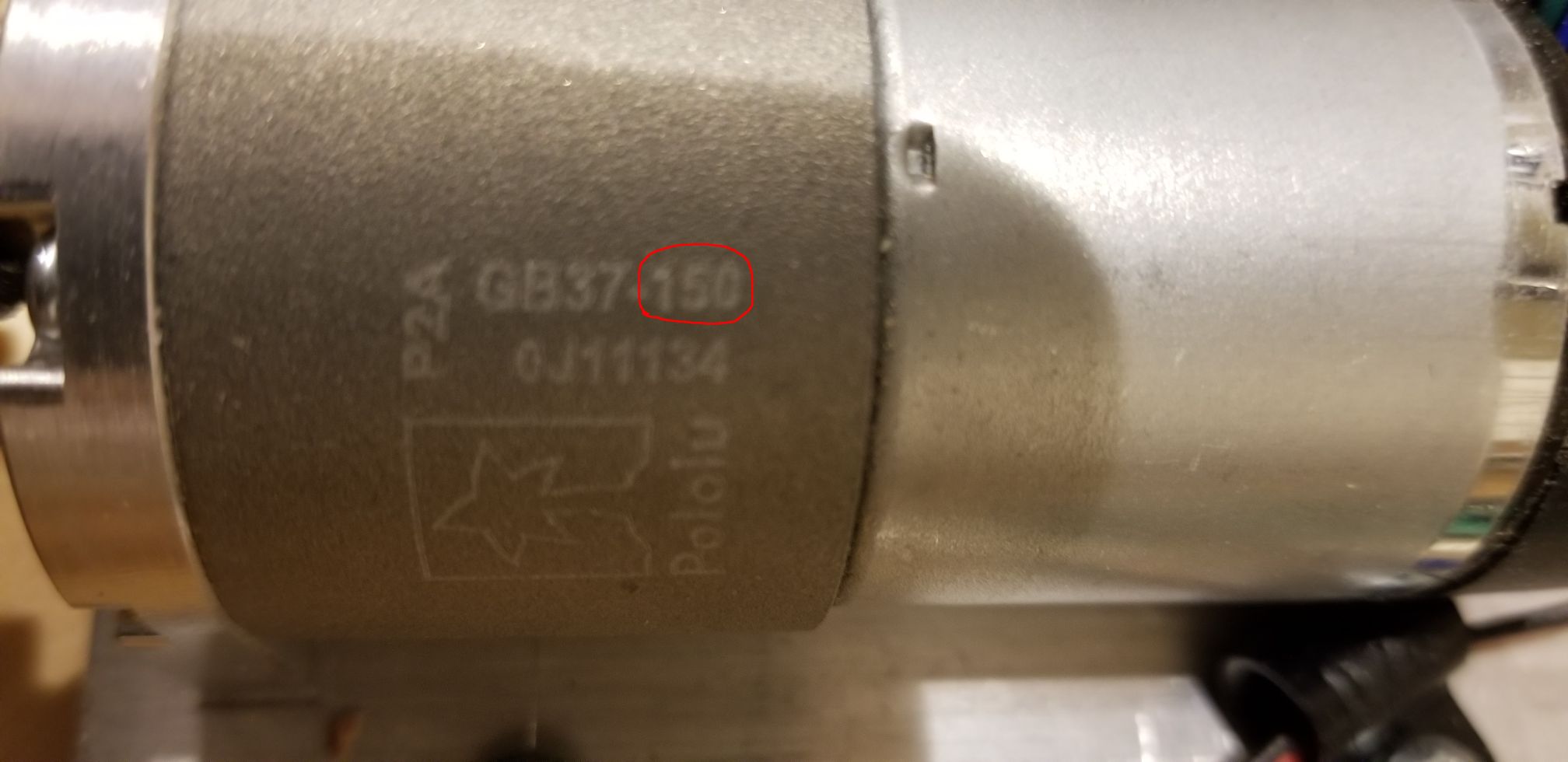

Here is the thing, that number does not work!
For some reason, it is off by a factor of four.
Through trial and error, I am using B=107225.
I double checked that I received the motor I ordered, and it is indeed the correct one, as well as all the connections.
Pololu - 150:1 Metal Gearmotor 37Dx73L mm 12V with 64 CPR Encoder (Helical Pinion)
^This one.
Here is a short vid of the table moving from 0º-180º-0º
Arta Turntable 0 to 180 to 0 - YouTube
And some pictures of the motor, connections and software settings.
Any thoughts as to why Scaling Factor B is so wrong?
Thank you,
David.

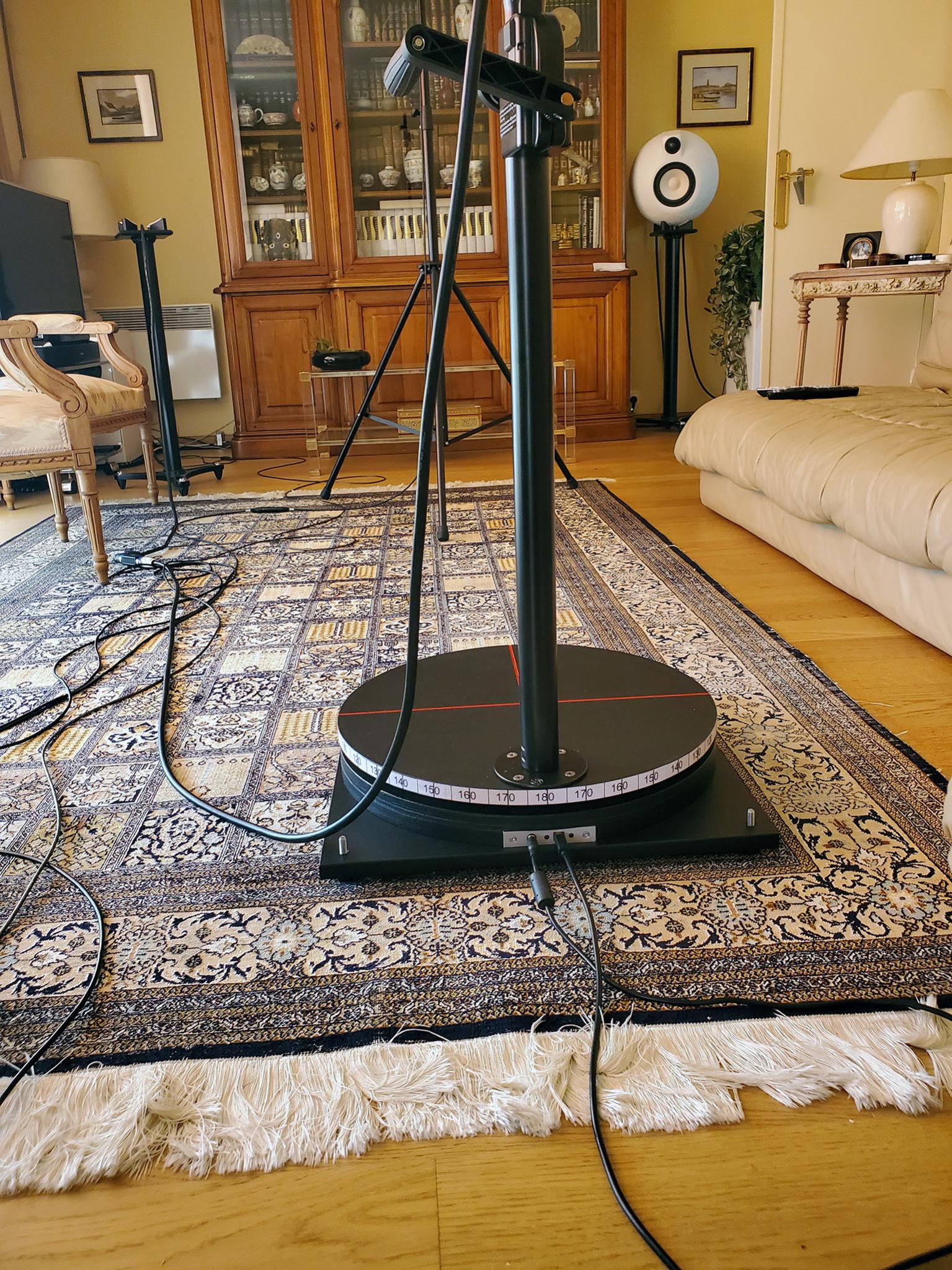

David,
I have just finished my table using the same Polulu motor as you (Polulu ref 2828 ) and I have the same problem : I have to divide by a factor of 4 to get the correct rotation.
I would really like to understand !
Any idea Heindrich ?
Jean Claude

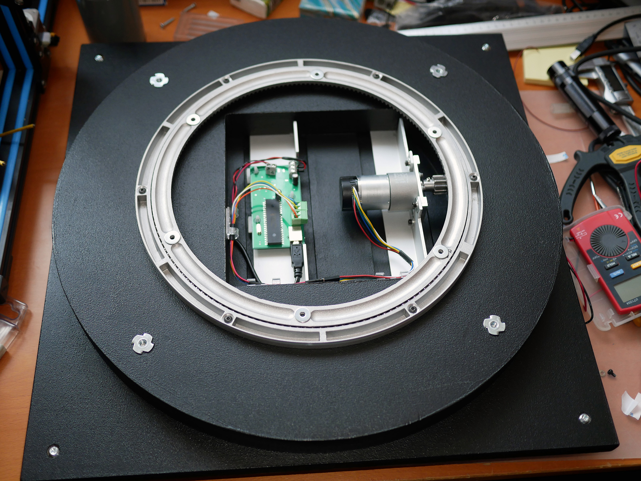

For sure,
I use 30 x 50 mm aluminum corner with 3 mm thickness. I make my motor support in two parts to allow easy final adjustment and also add adjustable feet at the bottom.
I also place a 40 cm x 40 cm sheet of lead (7 mm thick) below the base plate to incease stability.
Here is the gear in situation

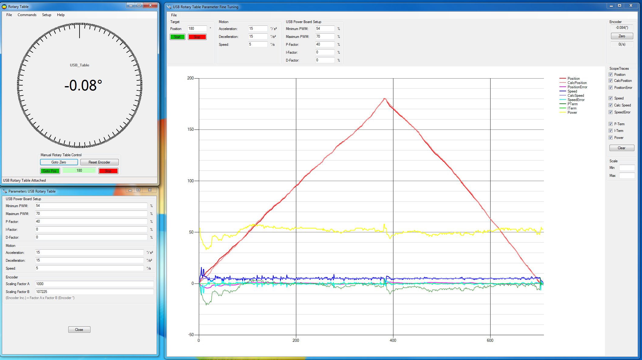

Hi Heinrich,
Thanks for the answer, unfortunately the Phidgets motor is now discontinued !
And you are right, it seems related to the way the interface interpret the CPR
Hopefully, a solution could be found.
In the meantime, when the table rotate let's say from 0° to 180°, it accelerate, then slow down, then accelerate again and so on until it reach it's final position. It can be seen in the you tube link Davefred just posted a few post above:
