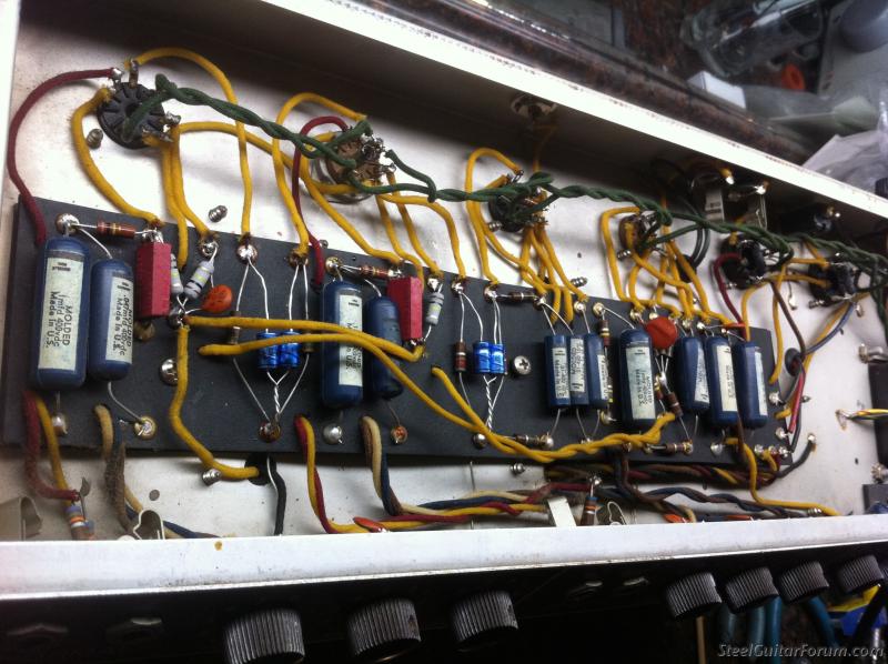

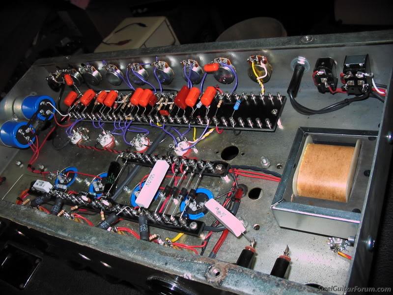

Dotneck, those are nice photos, but the two examples are not point to point. Those are using turret boards. The parts are on boards, with flying leads to the controls and sockets. Point to point means components are soldered directly to socket pins, control pins, and terminal strips.

PTP encompasses the use of terminal strips, tag strips, eyelet boards (circuit cards) and turret boards, along with hair-ball wiring right on the tube socket or controls and jacks. Each method has its pros and cons with respect to how quickly it goes together and how easily it can be serviced.
Of all the PTP assembly methods, circuit cards are the easiest to service and hair-balls are the worst.
Terminal strips assembly is one of the fastest but can be difficult to change or service.
Using the tube sockets for component mounting is pretty quick but leads to unreliable circuits due to the mechanical stresses of tube insertion and extraction.
Everyone will have their own preferences for assembly and will agree or disagree with the above, but generally the above represents industry norms.
