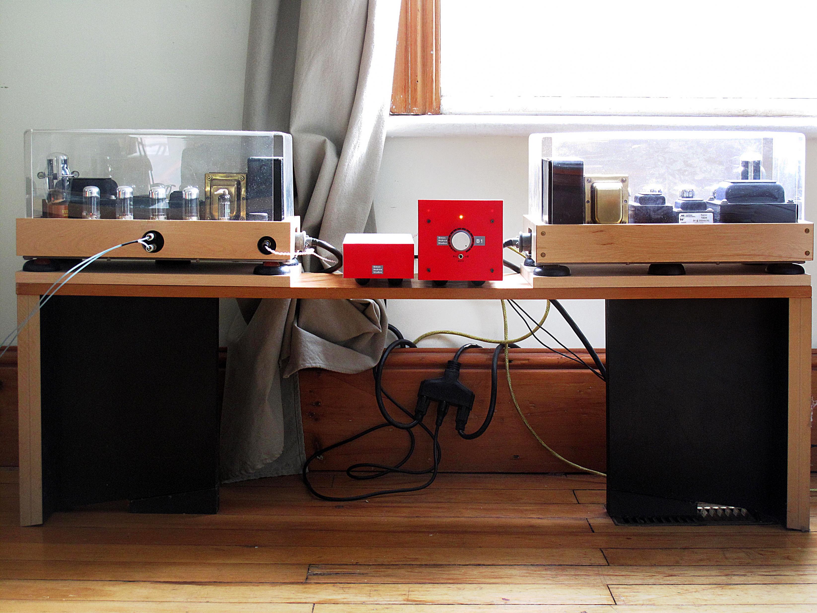

I built the 'poinz' design amps with tube rectifiers (monoblocks) with a LCLC filtered power supply (converted Hammond 'G' amps). Different manufacture 5U4 & 5R4 rectifier tubes did sound different. I did use a dropping resistor on the 5U4 to maintain the same B+ voltage as the 5R4.
Anyways, this does not make any sense to me. Why would different rectifier tubes make a sonic difference? It does.
I can state the Sylvania 5R4GYB black plate with a 1/8" gap in-between plates was superior out of eight different rectifier tubes I auditioned. The Sylvania 5R4GYB with the 1/2" space in-between plates was slightly softer sounding, but still accurate. Perhaps the better rectifier if an amp sounds too bright on the top end.
BTW- I used four (parallel push-pull) 7C5 that is the same as a 6V6 in a loctal base. Phase splitter are the rare Raytheon 6CG7. The Siemens 6922 A0 code was very close in performance & much higher gain. The Siemens sonically outperformed the 5965 per our ears.

Cool amp. Wish i could lay my hands on a chassis like that, i mean with that finish. Love it.
Parallel push pull ...umm, guess you were not happy with only 7 watts. I forgot to mention that my friend also needs good speakers and i am looking for a 93 dB driver so 7 watts for me is enough. Anyway once finished i already know it's not going to look as good as yours. :)
