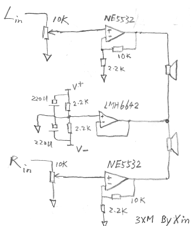

Hi Ozgur,
check out this thread. The headphone amp is based on Hiagra's design. I simulates very nicely. I am doing a PCB and will probably build it after New Year.
http://www.diyaudio.com/forums/showthread.php?s=&postid=1386863#post1386863

In the other hand; I have never listened Earbuds and generally doesnt listen iPod via anykind of headphones. Because I dont like its sound even with my other headphones. However, iMod guy (Vinnie) says a lot of good thinks about modding on iPod. So Id like to try a iMod. And after this modding I'll need a portable amplifier. In fact I have designed a Class A headphone amplifier in the past. However it sucks a lot of current so not suitable for this position.
