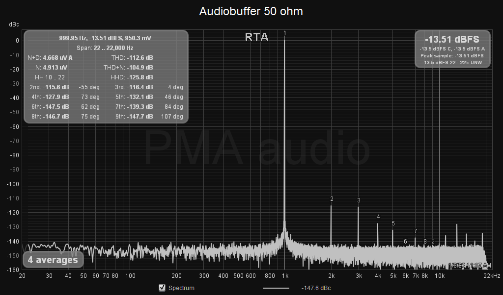

If you want to use an IC for an output buffer, the TPA6120A2 also has very impressive specs with 700mA max current, 1300V/usec slew rate, and similar 36V supply. It is used on some very high performing headphone amps from Topping as a nested composite amp. I use it in my HyperDrive-2 headphone amp. But I find the harmonic signature of Jhofland’s Diamond Buffer to be more pleasing with similar low distortion figures.

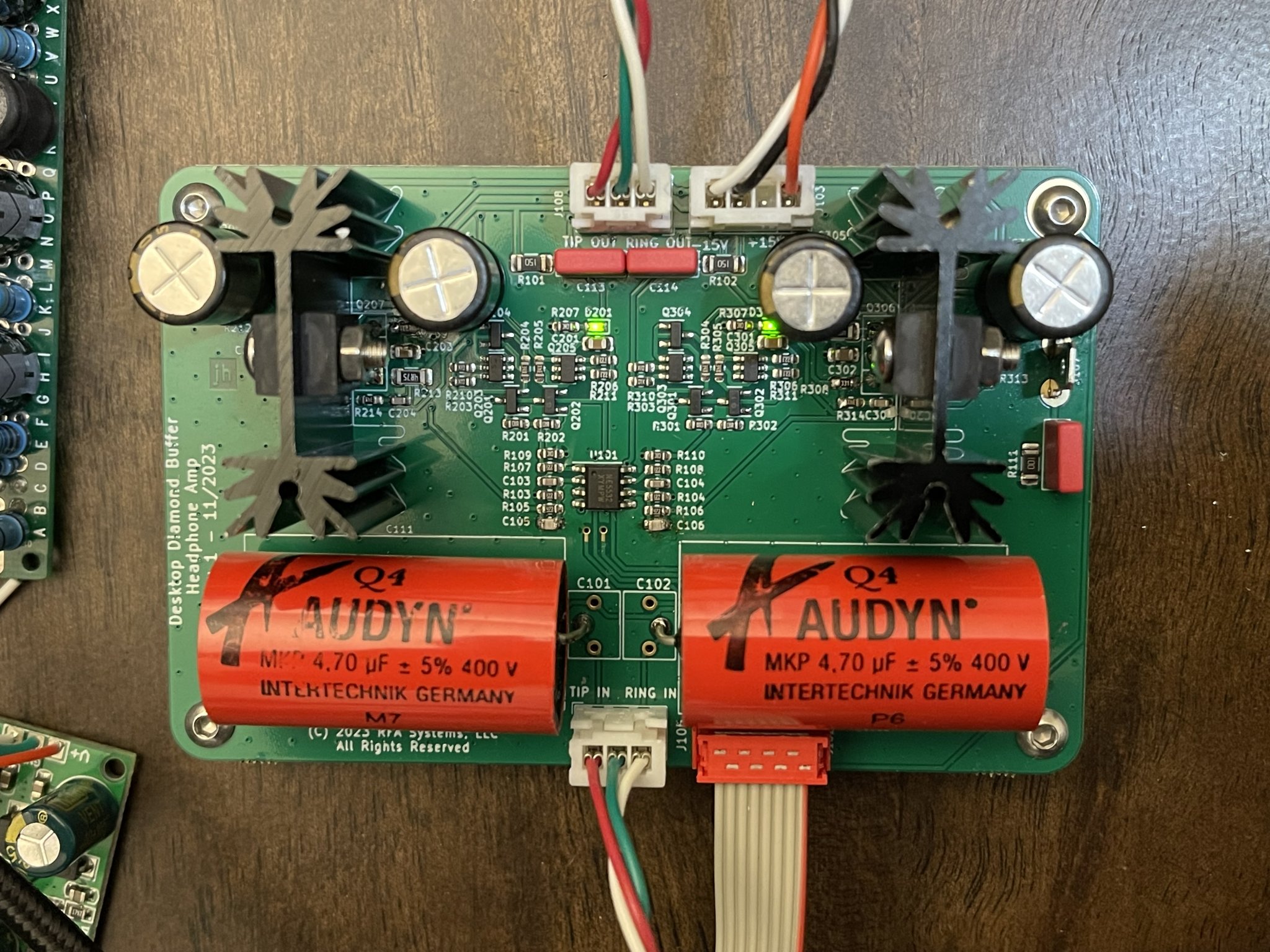

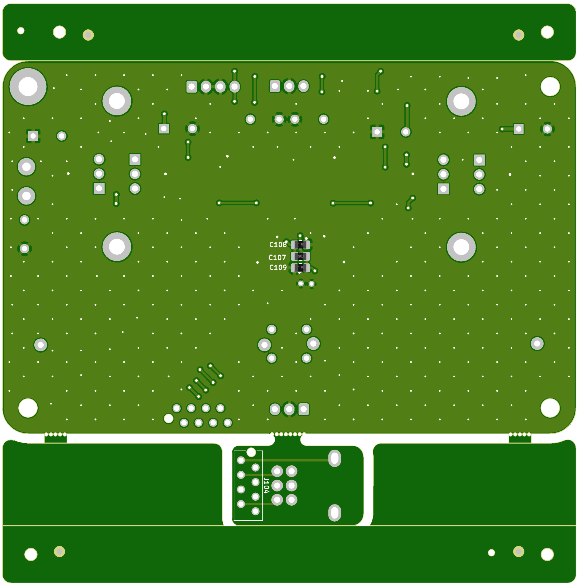

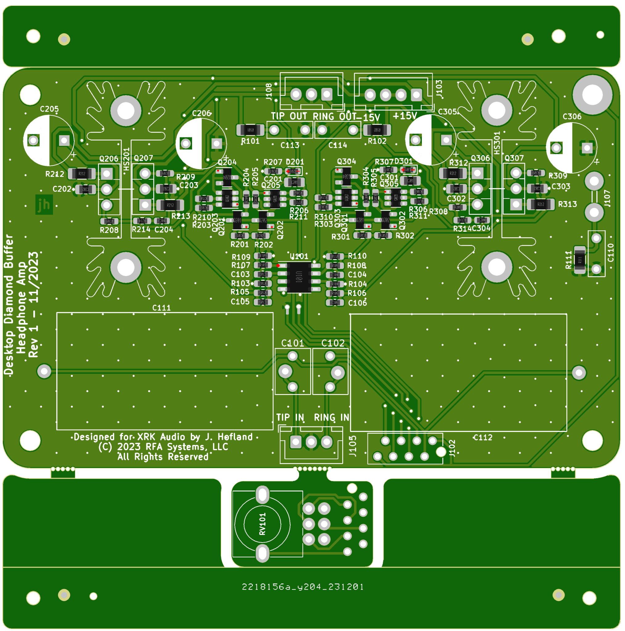

The final production data files for the Desktop Diamond Buffer headphone amp have just been finalized and they boards are starting to get made, finally. The board house had so many questions for me this time - back and forth 5 times at least.
But here is what the parts placement (SMT) is going to look like.

Here is the BOM. Bold items are the through hole parts that need to be purchased and installed by the user. Feel free to boost 47uF caps up to 100uF.

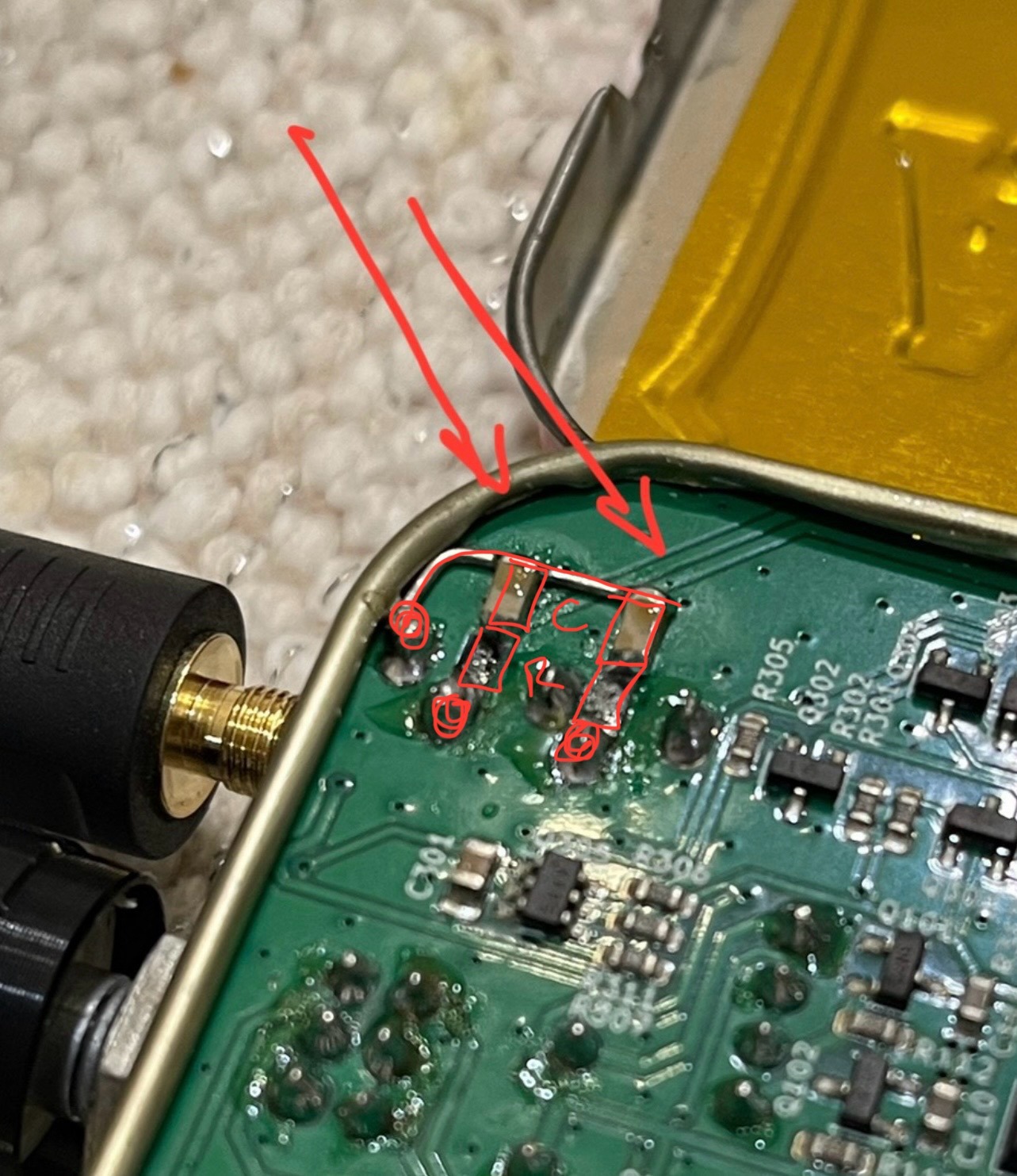

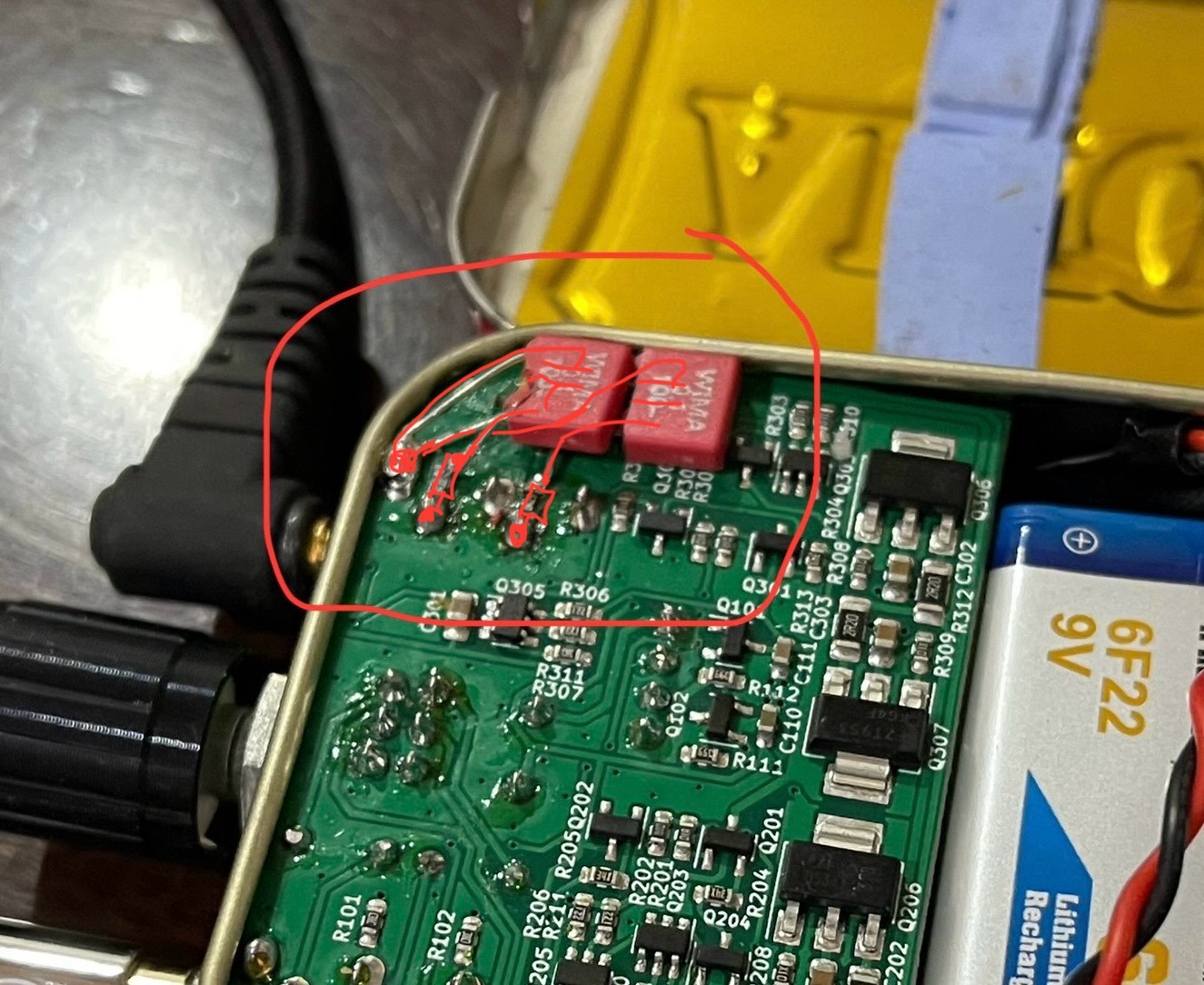

Note that you will need to add a snubber at the output TRS jack solder pins as shown above. A 4.7/6.8/8.2/10R are all values that should work. Plus a 100nF film cap. The little Wima 100v MKS ones are nice and small. A 100nF X7R ceramic cap can work too and is much more compact but some people don’t like ceramic caps in the signal path.
For C101/102 the input coupling caps, I used Elna Silmic 10uF 35v electrolytic caps. I faced the +ve end into the opamp - although I don’t think it matters. The DC levels are so small that the caps won’t have any issue.

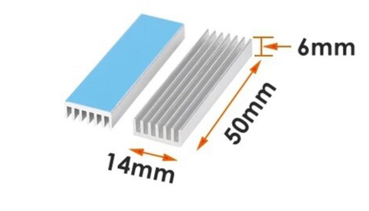

I was thinking that these might be the perfect stick on heatsinks.

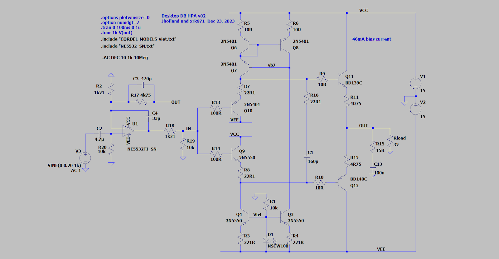

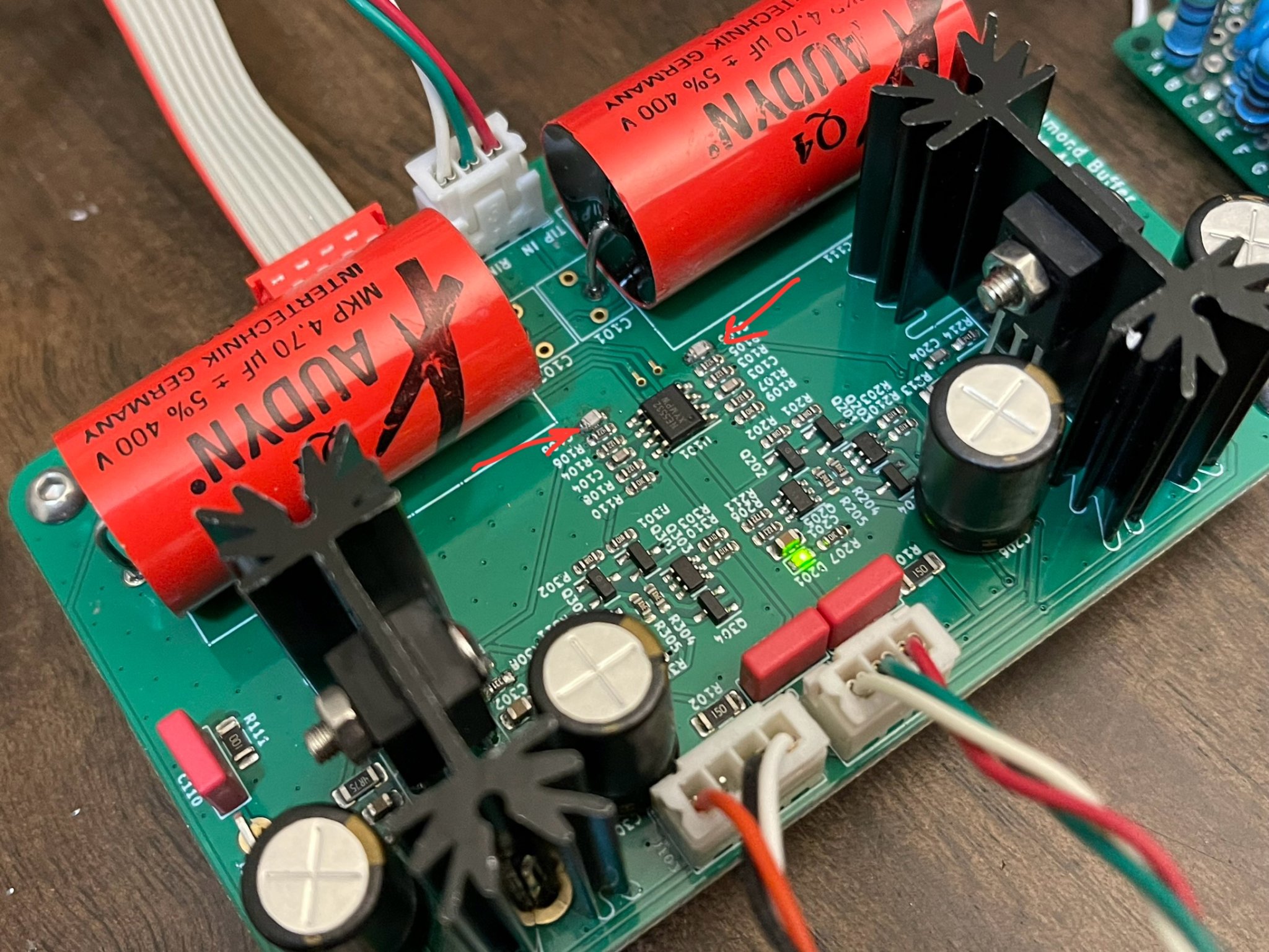

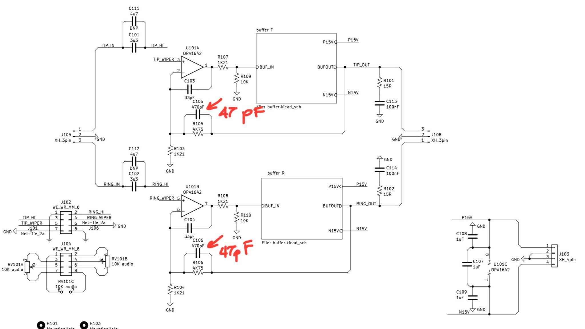

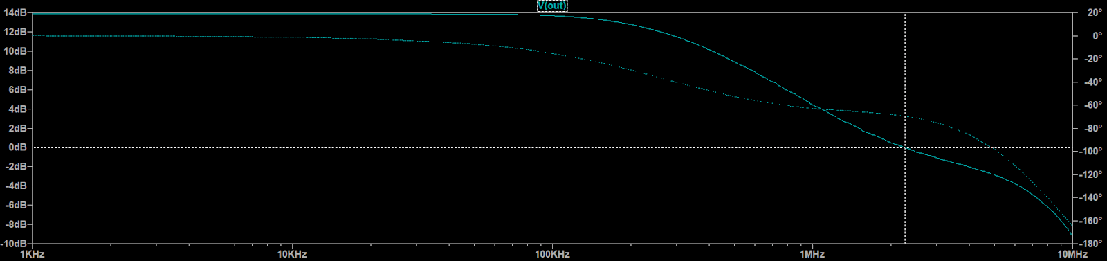

After trying a bunch of things to tame the instability in the Desktop Diamond Buffer without success, I looked the circuit on LTspice and did an .AC simulation to get insight on the gain and phase margin. I first had to find the latest NE5532 model for the TI variant. The simulation showed that the default 470pF feedback resistor is too large. It causes the gain to flatten out at 0dB while the phase margin falls precipitously past 3MHz. The simulation showed that changing that cap to 47pF produces a gain that varies monotonically rather than flattens out above 300kHz and the phase actually flattens vs falling off. Swapping out the 470pF NP0 to 47pF NP0 fixed the instability right away - as predicted by LTspice.
In the LTspice schematic, C3 is the cap that was swapped from 470pF to 47pF.
Here is the gain and phase plot (closed loop) - cursor is at 0dB and we see that phase is -70deg:
In the actual circuit the cap is labeled C105 and C106 - located on the end of row so easy to change out:
It sounds super quiet now - and the overall sound quality is really nice.
I think I am ready to release these Desktop Diamond Buffer headphone amp boards for sale now.

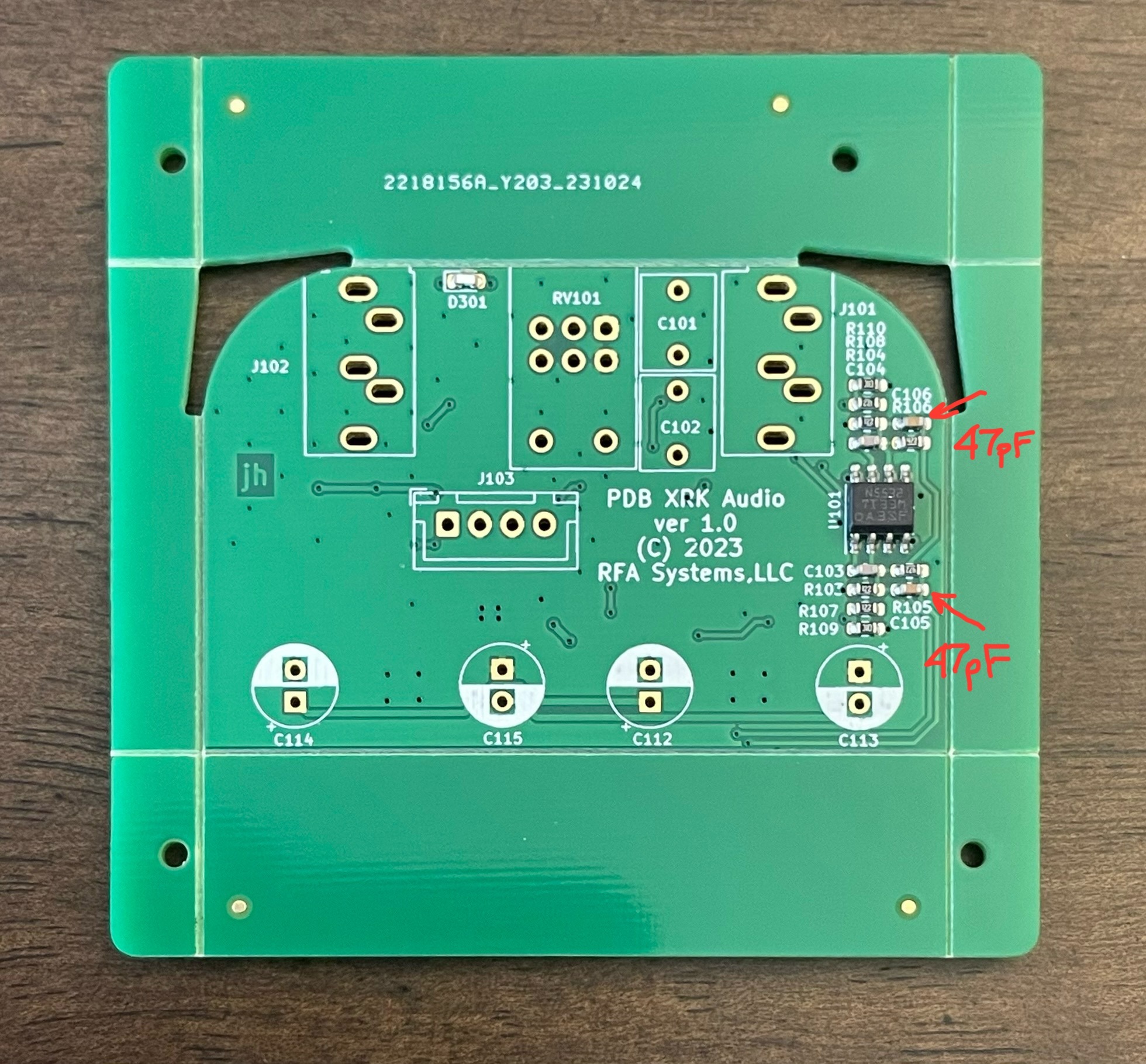

This also implies that a change to C105 and C106 should be made on the Pocket Diamond Buffer headphone amps to improve the sound quality and eliminate oscillation even some more:
Make sure you use NP0 or C0G high quality MLCC caps for this application.

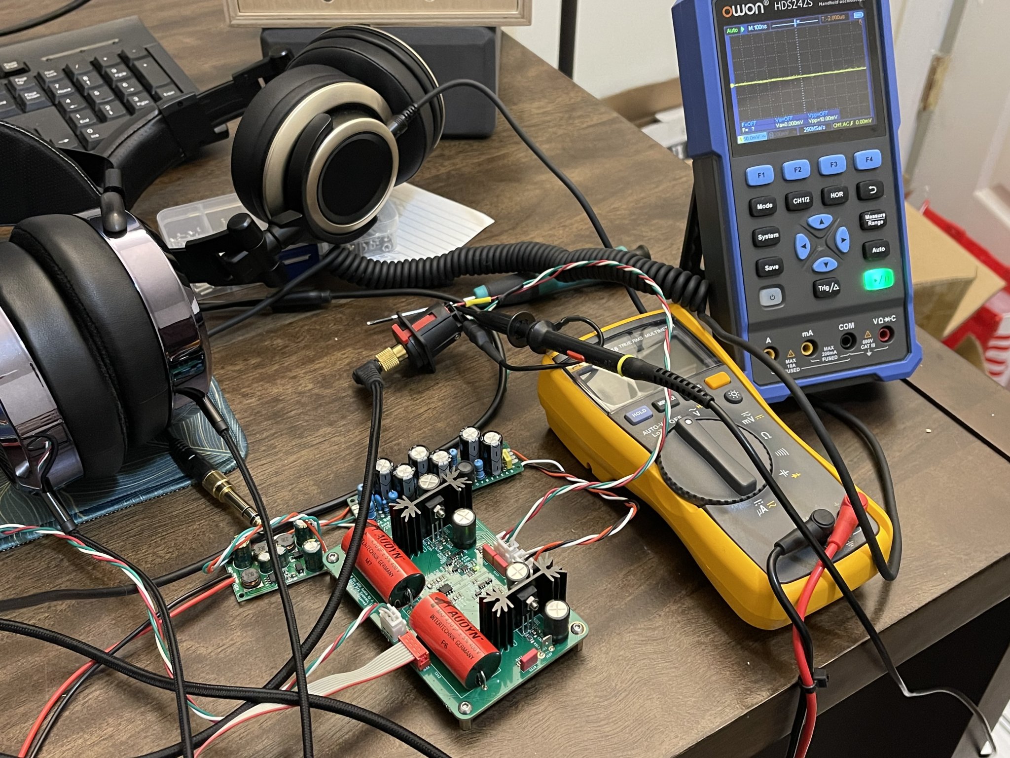

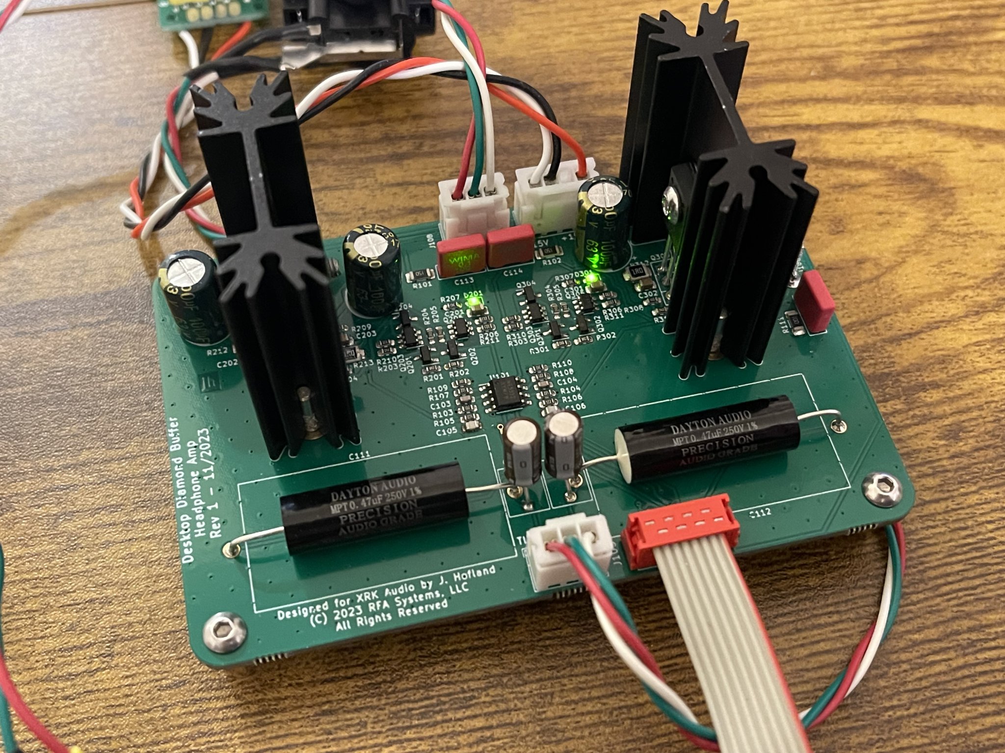

I made up another board with increased bias current of 78mA for lots of Class A depth of operation. Taller heatsinks. I am using Silmic 10uF input electrolytic caps bypassed with 0.47uF MPT film caps to keep it compact.
The 47pF cap modification was applied to C105 and C106. No oscillation and letting it break in overnight. Sounds great.

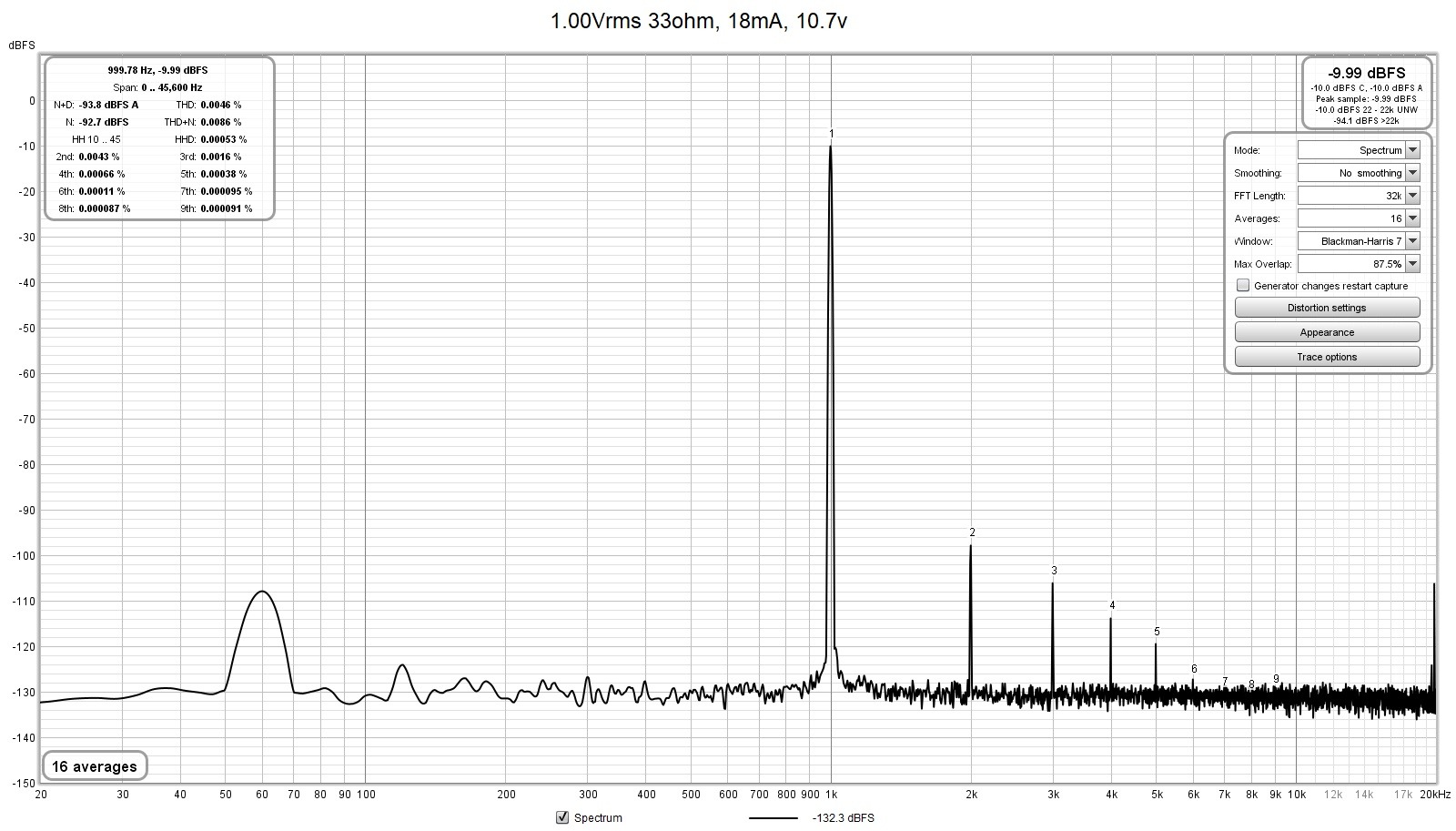

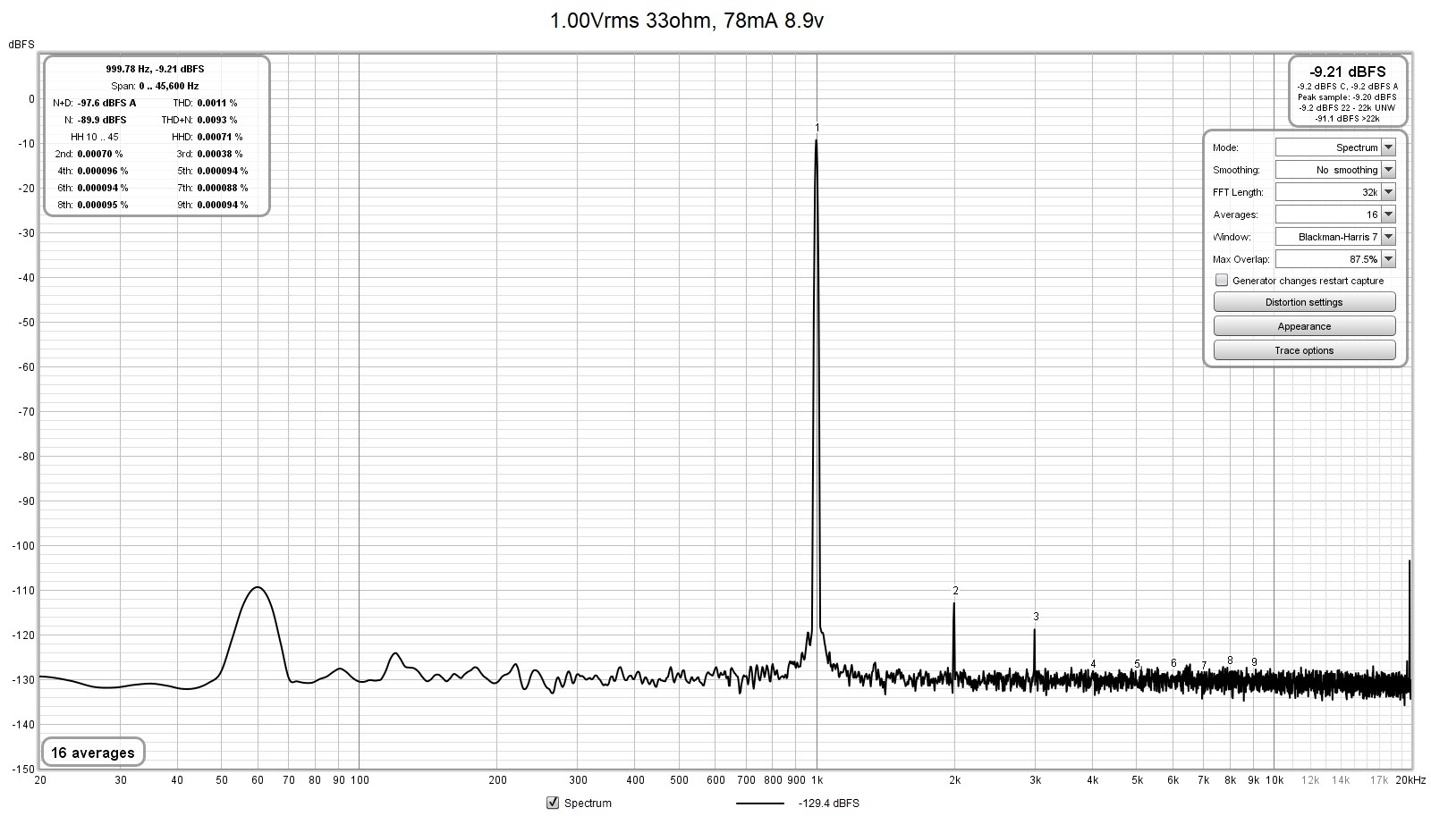

The higher bias current of 78mA gives a nice harmonic profile with only H2 and H3 present. Here is 1.0Vrms into 33ohms, with a +/-9.9v PSU (DC/DC followed by CLCRC filter:
Here is the profile for the same condition but with the other amp running at 18mA bias current, the overall THD has increased and there are a few more orders present H2, H3, H4, H5:

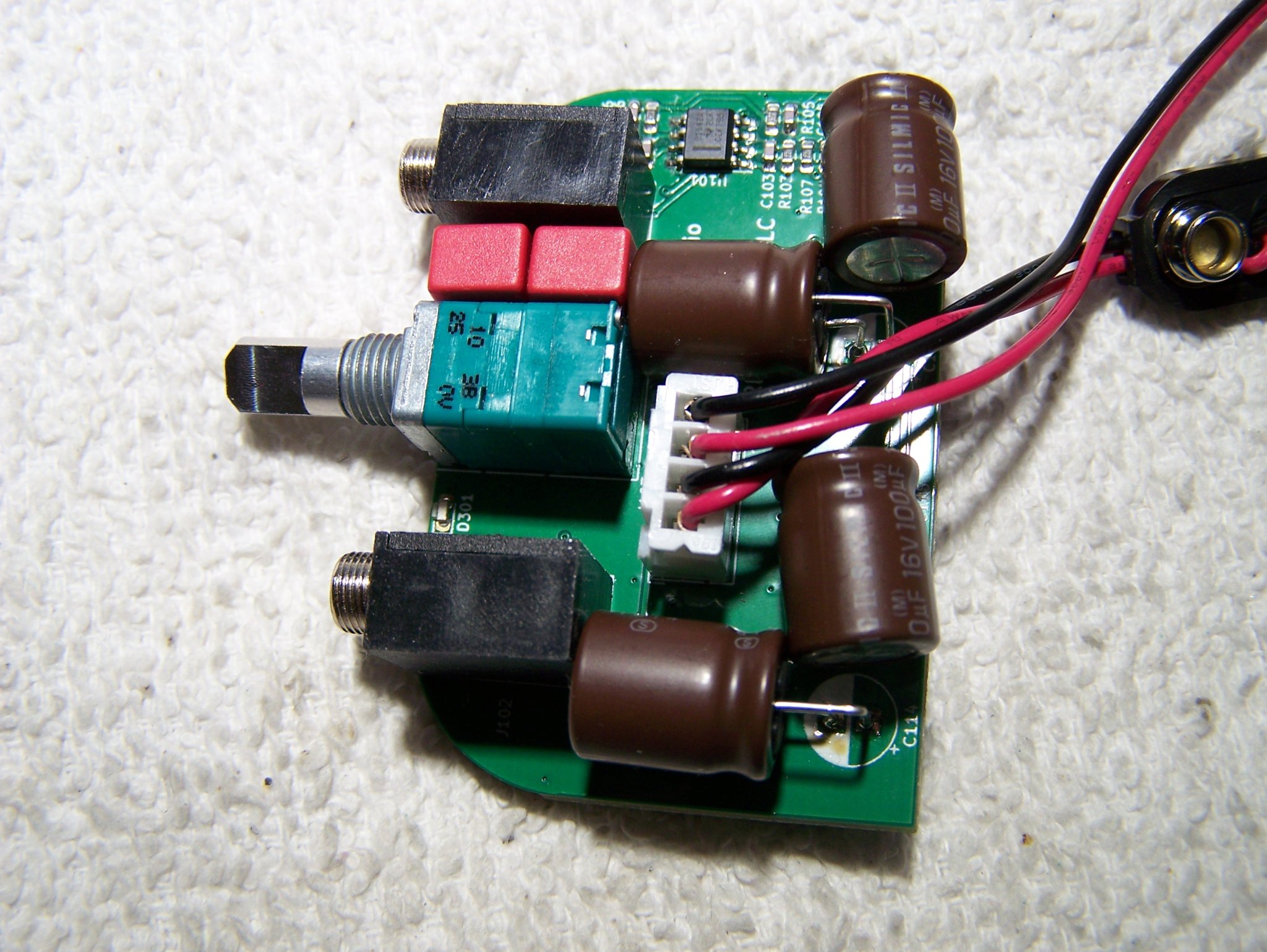

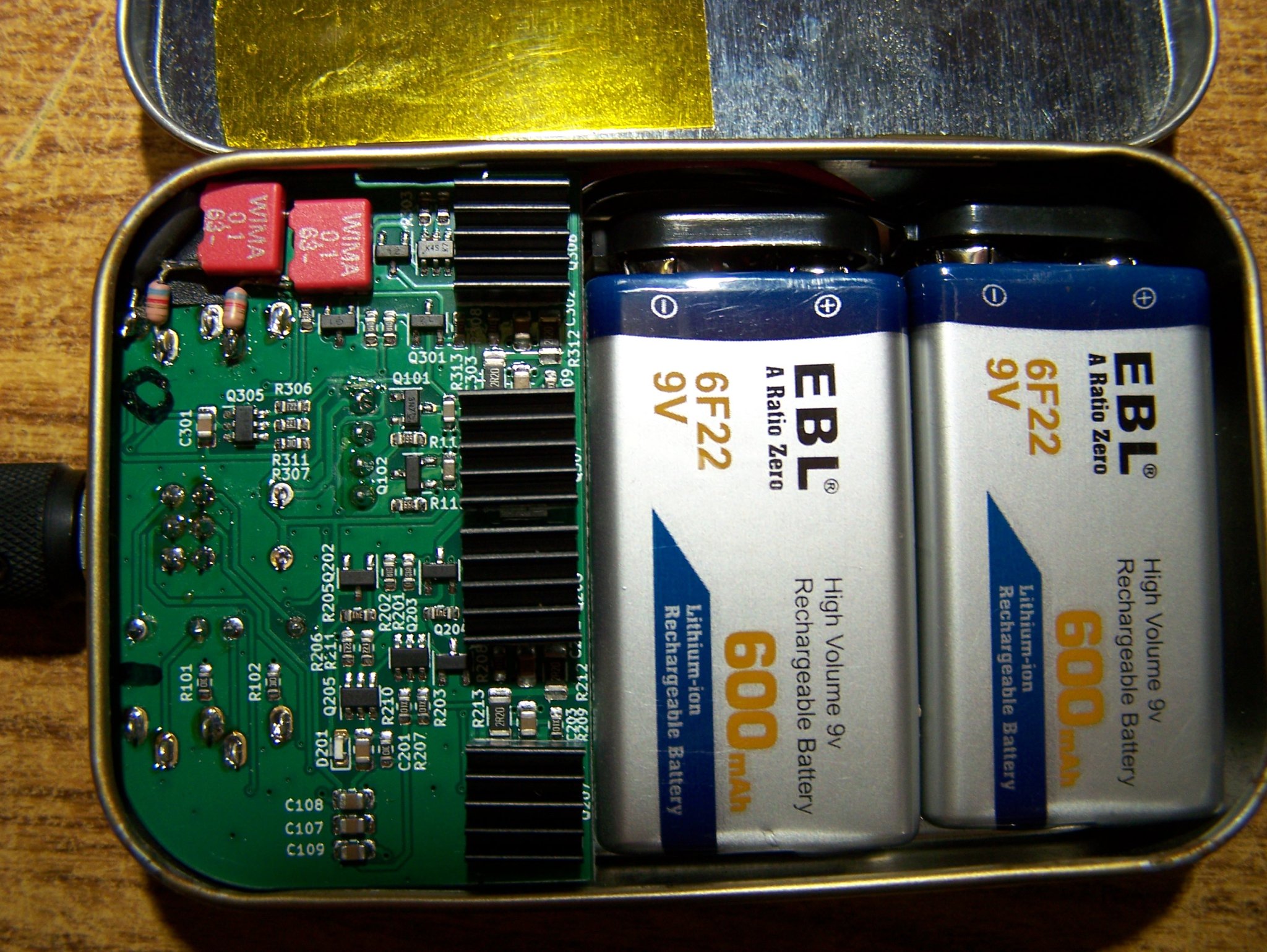

Got my PDB amp done.
I replaced C105/106 with 47pF, installed the snubbers, and am using ..... HEY! Stop ogling the last pic! Focus!! .... the OPA 1642 opamp.
The tin is one I've had for years. I also cheated with the rail cap's by using Elna Silmic II 100uF/16V that I still had in my stash (unobtainium now).
