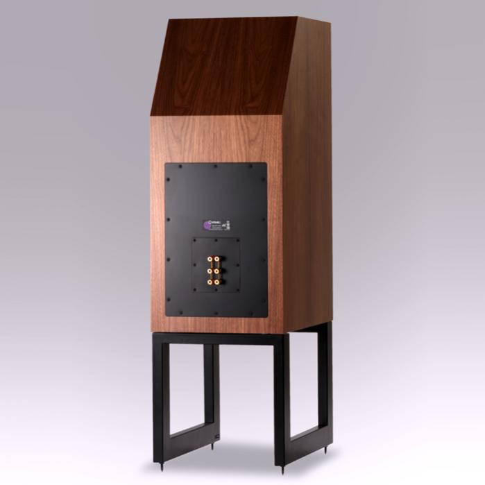

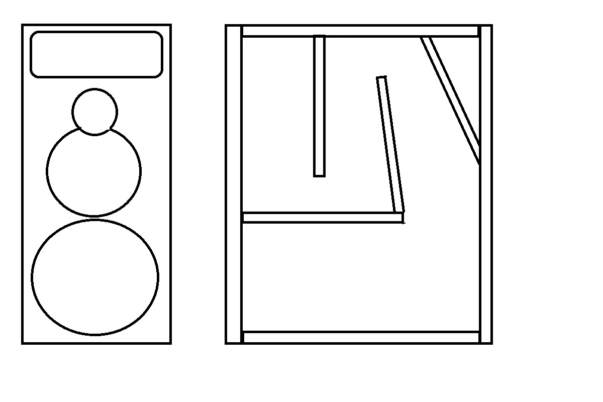

Hi

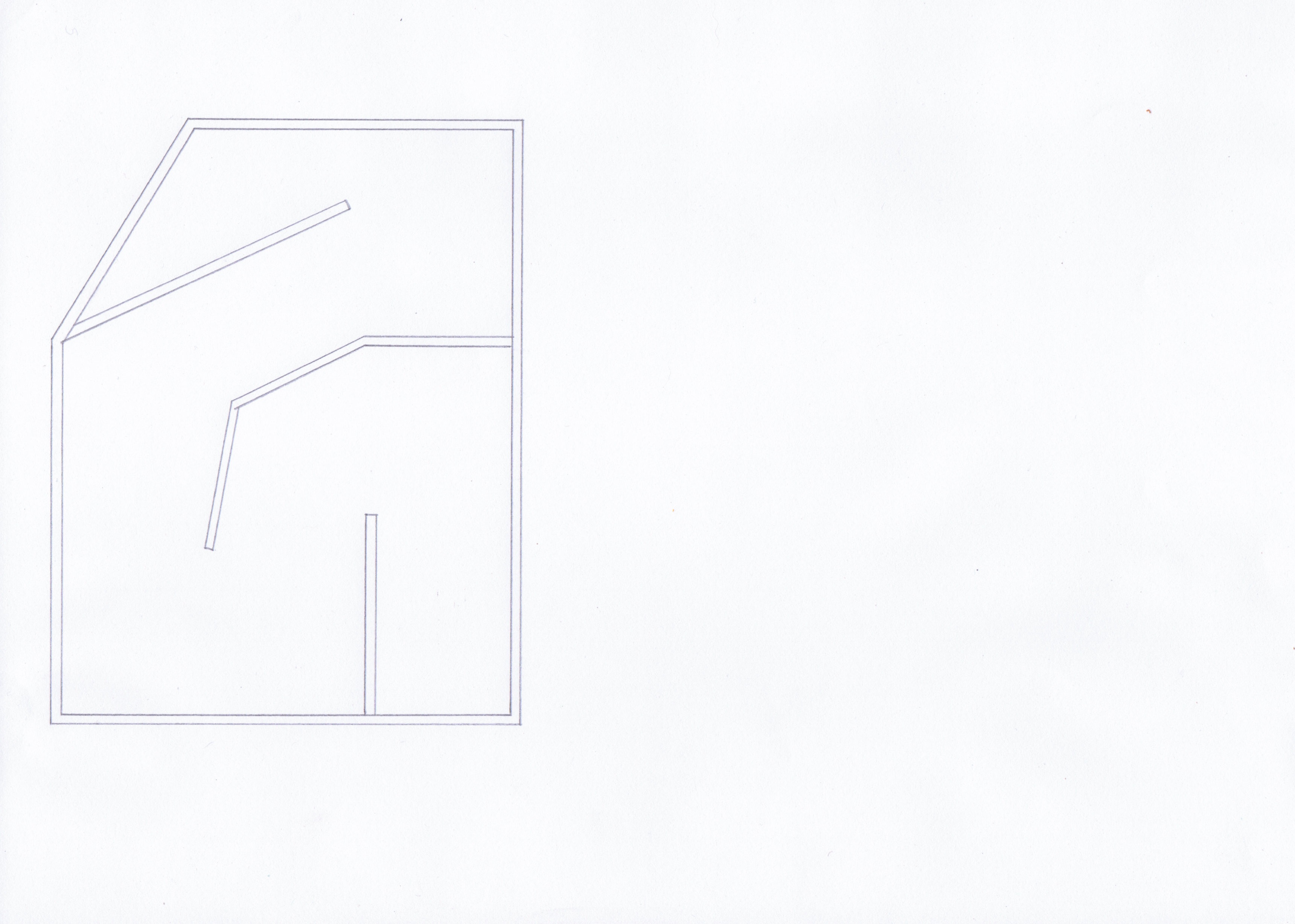

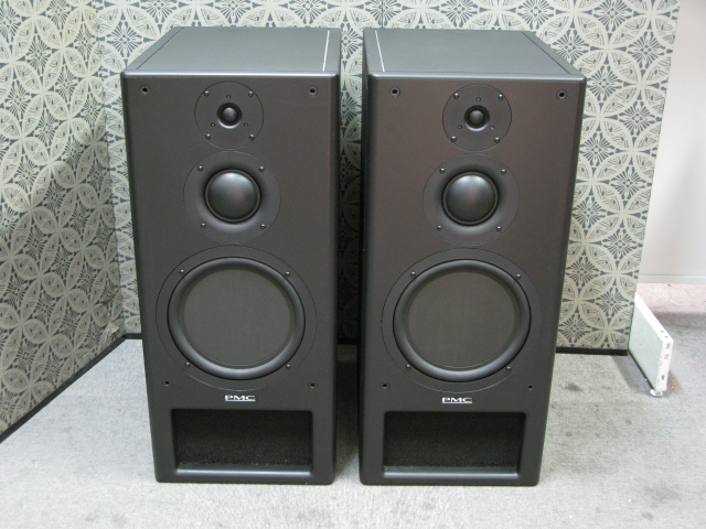

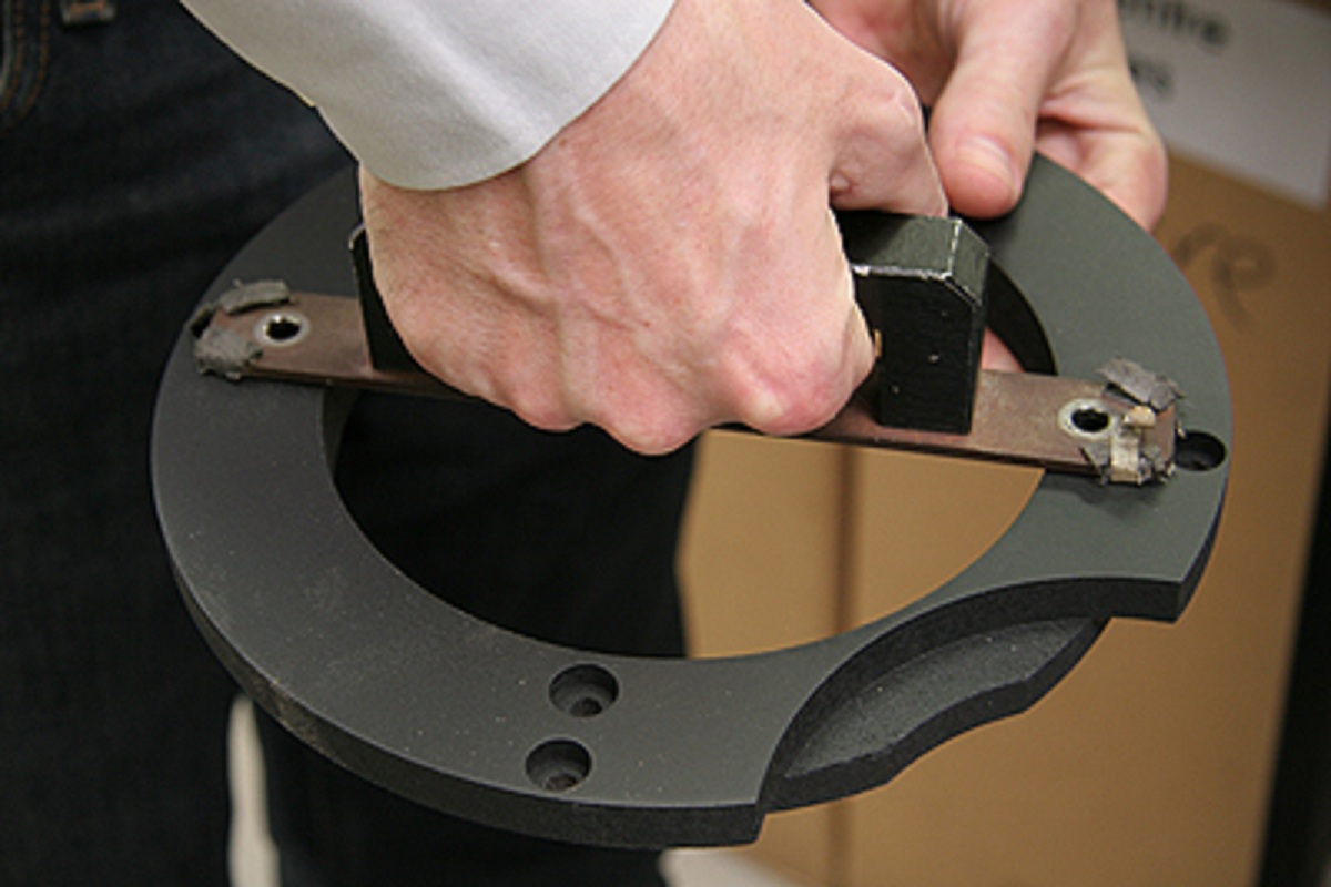

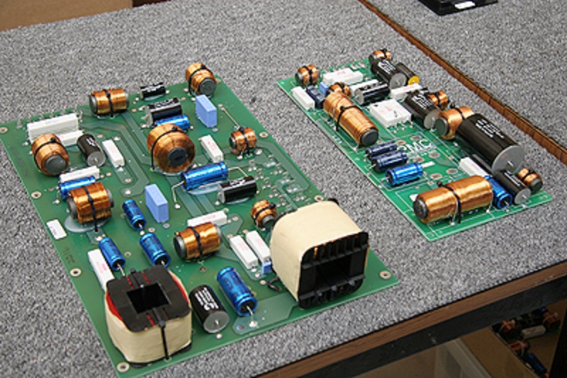

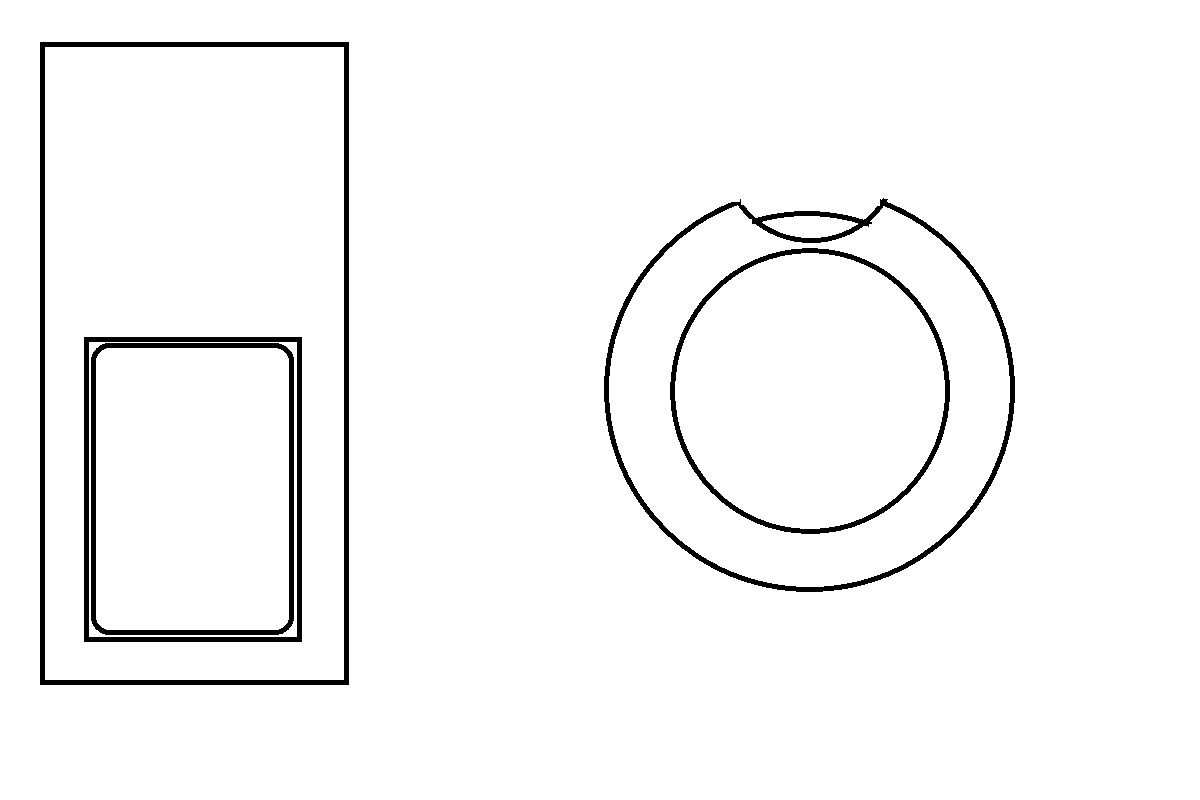

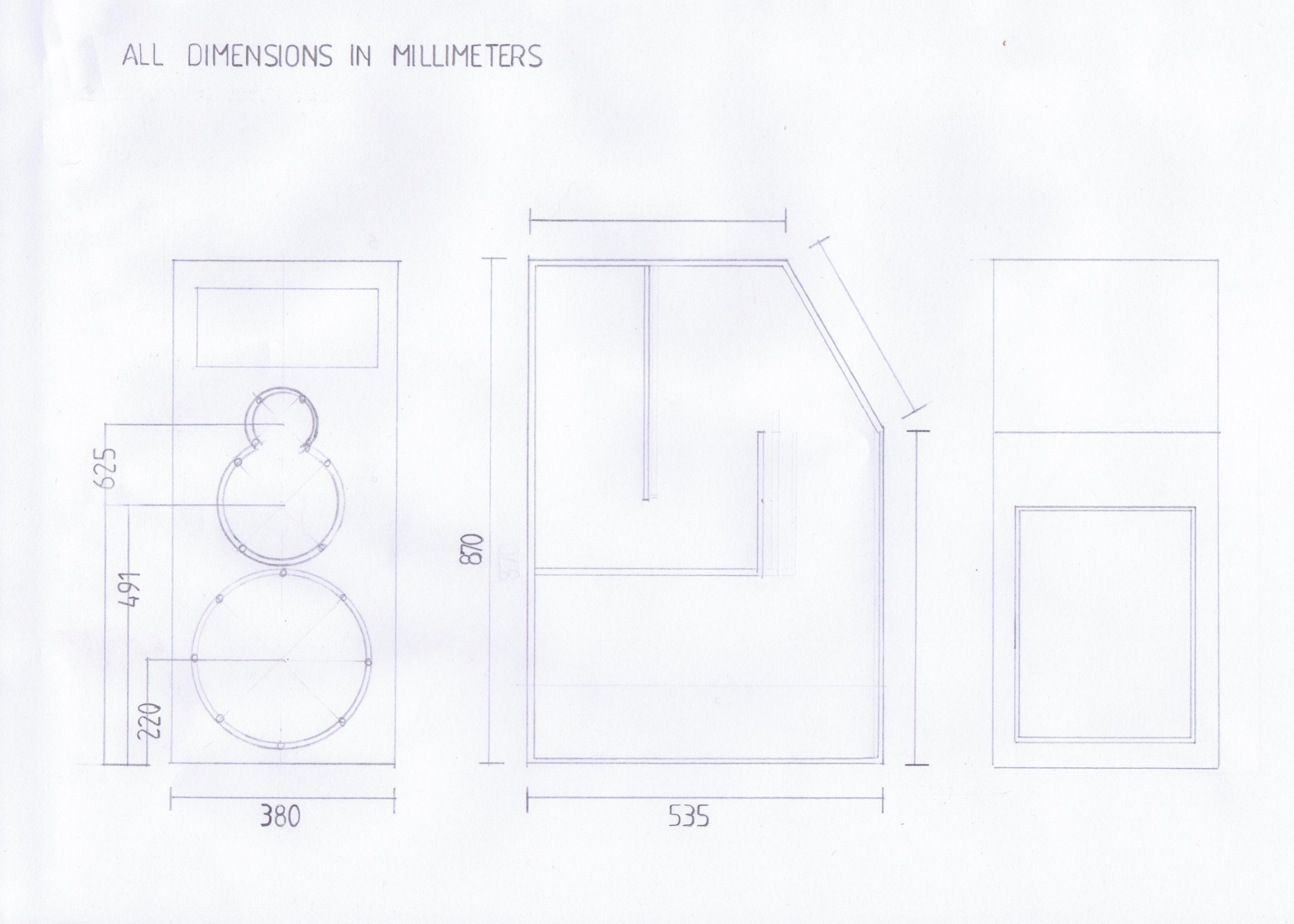

I'm planing to create my own MB2 clones, using Volt RV3143, Volt VM752, Vifa D27TG-35-06.
The cabinet will be constructed from a combination of 20mm and 35mm HDF board.
Im still at the early stage of design with this, and wondered if anyone else has tried the same project.

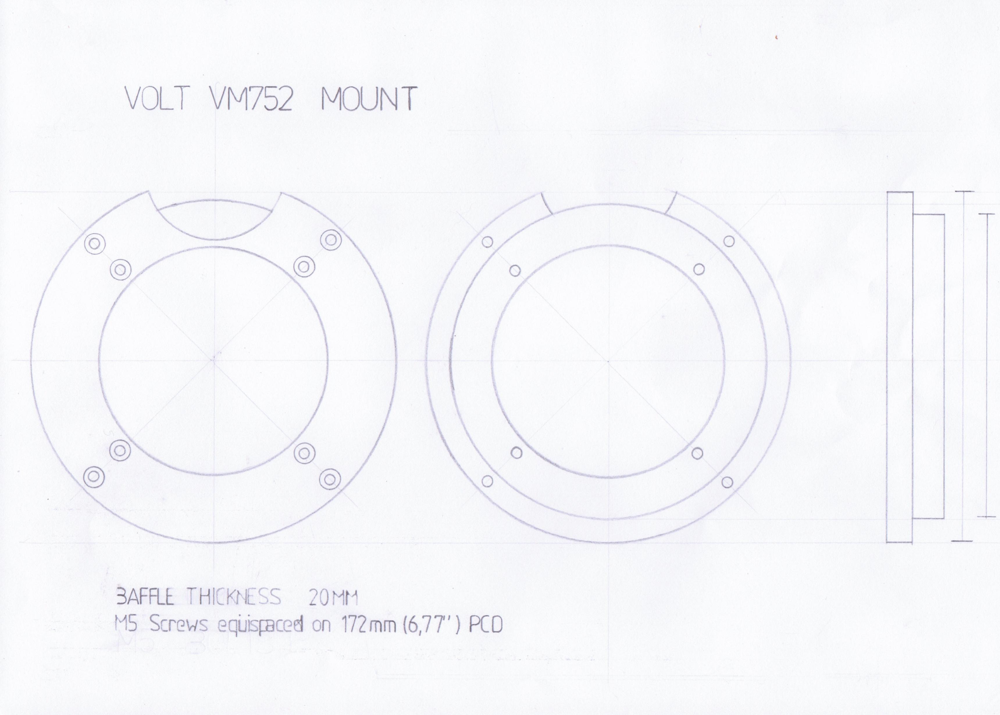

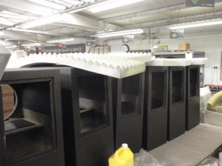

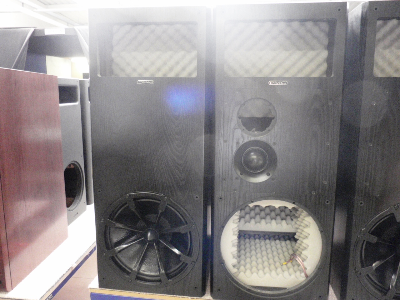

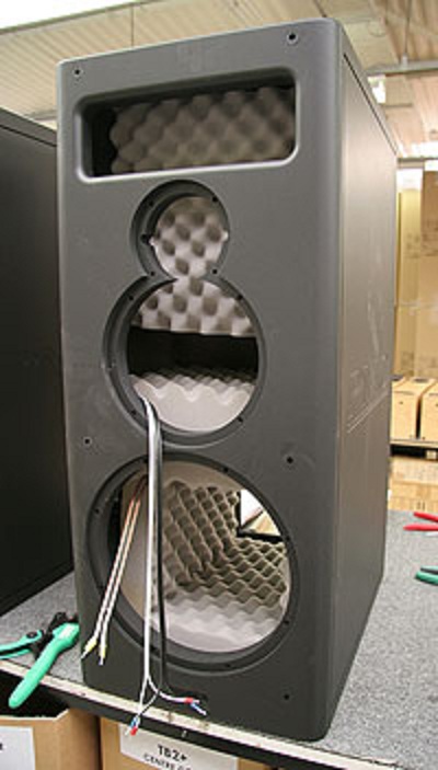

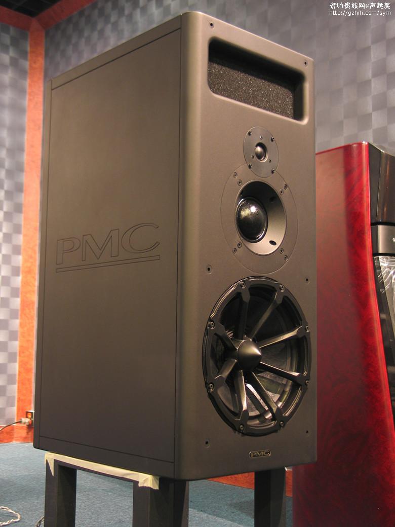

Does anybody know how they've constructed the cabinet? it has a gap of around 1mm along all the edges........

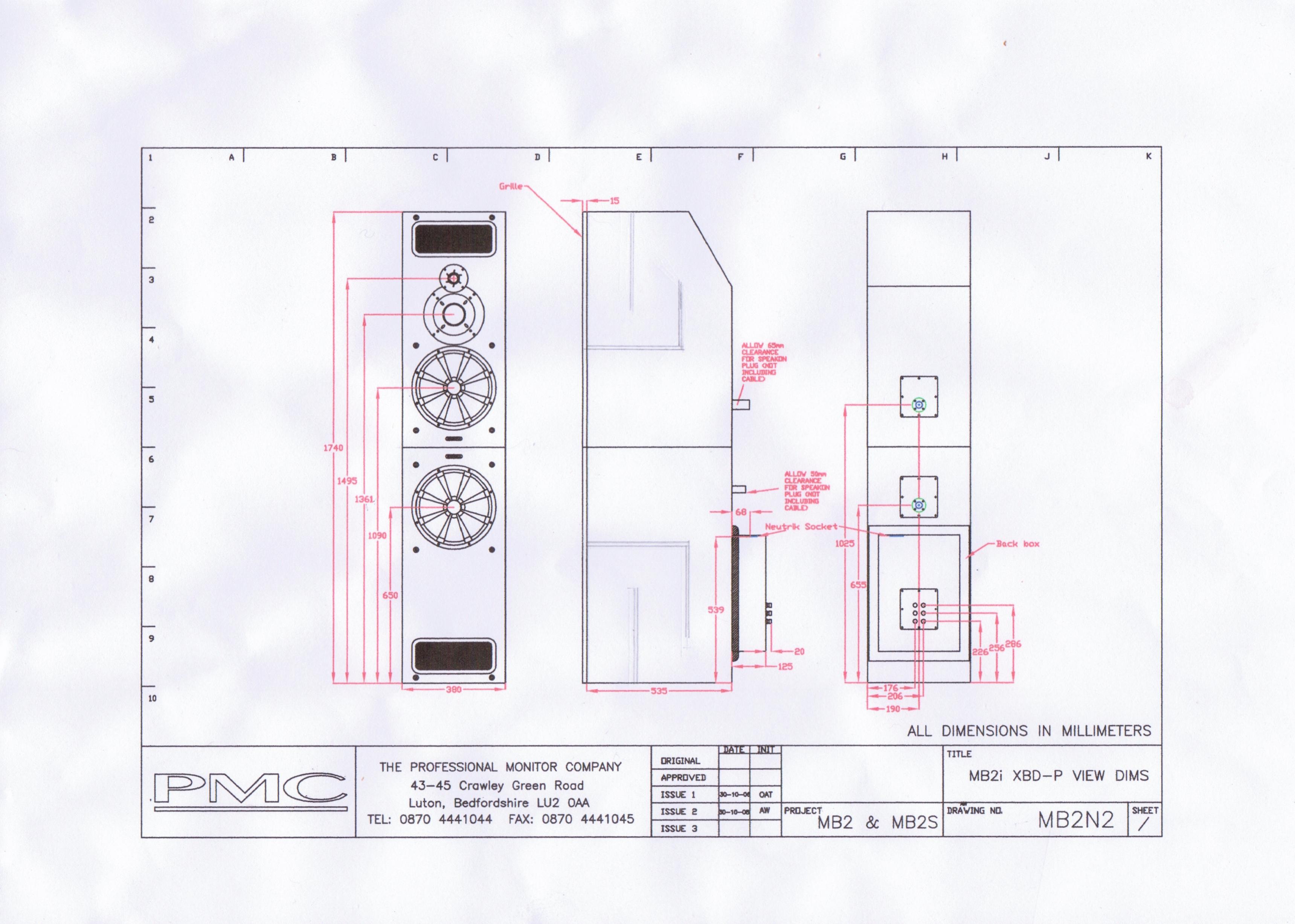

FWIW, since this is a commercial product, I rather doubt there are any official plans uploaded, and on the offchance anybody has the exact schematics, the legality of posting them would at best be highly questionable, since they are presumably the IP of PMC Loudspeakers. Equally, to work as PMC intended, you would need to use exactly the same drivers, crossover & construction materials as they do, in the latter case most obviously damping. PMC make their own foam or have a propriety type made for them, so you would need to somehow ascertain the precise damping properties of this and either get hold of some via unofficial means, or adjust the quantities, densities & locations of a more easily available type to ~mimic the behaviour of their own damping.
With all that said, there is nothing particularly novel about PMC's transmission line designs & you could design something similar or possibly superior easily enough.

As Scottmoose said, Why would anyone have plans of a commercial product? Based on sketch above, it would not be hard to design a transmission line from scratch. Again, this is a multiway, we would only deal with a full range TL here anyhow. Also, given dimensions above, you can reverse engineer it if you wanted to.

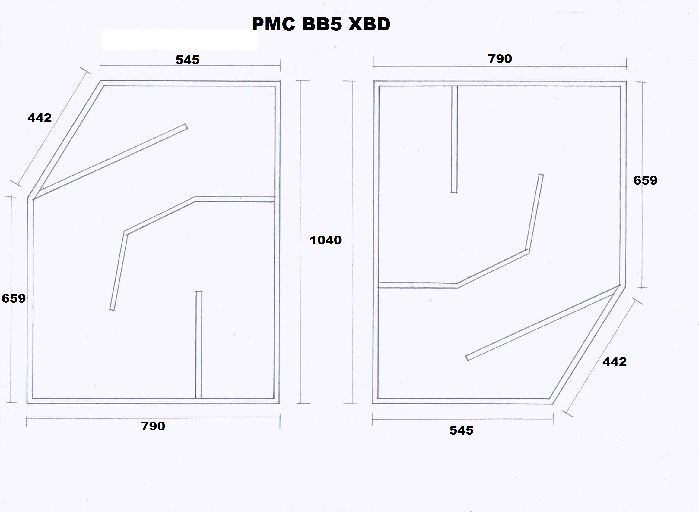

What he said above, spot on. Though im not too fussed about the copyright issue, because I believe PMC will know how hard it will be to replicate their products.
The internal design of the MB2 is still a bit of a mystery because i have found no information on it. I do however have the design of the BB5's because it was a back ground image in their MB2 / BB5 active brochure.

It would appear that either (or both) of PMC and Volt didn't mind making mid-range domes to almost the same design as the ATC ones when ATC stopped supplying them with their drivers! Maybe there was some legal agreement, or no patent/copyright, but the PMC versions are very similar to look at!

Fascinating and an excellent observation.
I wonder what grade cellular foam fill PMC use for their ATL in the BB5?
Volt VM752 Bandpas filter
Pleased I found this thread rather than starting another, I am going to try and work on a design influenced by the BB5 but not a clone.
Does anyone have a bandpass filter design for the Volt VM752 mid I could experiment with?

I believe that you can't buy these drivers from PMC or from anyone else but they look very similar to the Volt dome mids and since PMC source some of their bass drivers from Volt (the Radials which PMC have modified slightly (by doping the cone I believe to make it their part) I wouldn't mind betting that Volt were involved if they aren't now. One of the giveaways is the four bolt fixing on both Volt and PMC to clamp the driver together, the ATC has three. Also the Volt and PMC domes can easily be replaced whereas I believe the ATC needs more extensive rebuilding. I have a pair of the PMC domes and I think they are fantastic.
