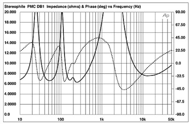

Basically, with certain grey areas between them where people get into linguistic semantics over definitions.
All QW based TLs & their variations are ultimately 4th order; even max-flat impedance designs will ultimately transition from 2nd to 4th. Frankly, I don't think many of PMC's enclosure designs are especially good examples of the QW breed, but there are commercial considerations they have to work with, which is fair enough in itself. Most appear to be modestly damped QW pipes designed to use the enclosure resonance to extend the LF. They are certainly not critically damped / max-flat impedance TLs, or at least, none that I have seen are.
Clearly we are having "a failure to communicate". I in particular am having trouble with the language regarding the phase of a wave. To me 0 degrees is straight ahead,360 would be straight ahead behind or ahead one cycle, and 180 would be 'out of phase' and would cancel with the straight ahead. Am I missing something?
I agree with your viewpoint on PMC enclosure designs. Those I've seen certainly are not optimized TL designs, for whatever reasons that happened. I just wish newcomers to TLs didn't get sidetracked by the several TL myths that prevail and promoted by people like Keilau.
