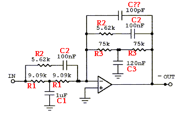

Hum..... for the 830668 values... should I just use what Linkwitz calculated (f0 = 74.3 Hz & Q0 = 1.57) ?
Or should I use the Peerless data for Fs = 33Hz, Qts = 0.51, Vas = 69L to calculate my own f0 = 80.3Hz & Q0 = 1.24 ????
What to do? Does anyone know if this will work for a sub x-over of 150 hz?
Peter

Maybe I was not clear with my questions. I apologize but you understood right, it was 2 parts.
1) I wanted to build the exact same enclosure and use the same driver as SL used in this page: http://www.linkwitzlab.com/Pluto/subwoofer.htm This would keep it simple for me by following a tried and tested design. Also found an excel spreadsheet that calculates Fo & Qo based on Fs, Qts & Vas from here: http://sound.westhost.com/linkwitz-transform.htm and decided to test SL's numbers. When I plugged in the data from the Peerless website, the calculated Fo and Qo did not match SL's measured Fo and Qo... Should I use the data from Linkwitz's measurements or the data generated by the spreadsheet? That was my original question but I have been shown how to make my own measurement with this: http://www.linkwitzlab.com/images/graphics/f0Q0.gif and will do so when I receive the driver. Apparently I am not the only one to have noticed discrepancies as someone else is the Linkwitz forum made his own measurements and they don't match either.
2) 150hz is the x-over frequency to integrate the sub to my satellites drivers. Great to know the sub will go that high. I know I will have to centre it between the satellites for best results. Thanks
Peter

Peter,
I have been building the same subwoofer you are. I was also wondering if I would use the parameters on Linkwitz's website, but after building my enclosure and making measurements I found that mine differ very little. I use somewhat different component values for the filtering - not shure what @ the moment since it is on breadboard on top of my amp about 2,3 meters above the floor - but if you want I could look it up for you.
Btw, I tried how much the subwoofer could take and I was only able to overdrive the unit when playing some testtrack with a helicopter @ 12 Hz making the windows throughout the house ring.
Good luck on you build!
Martin
