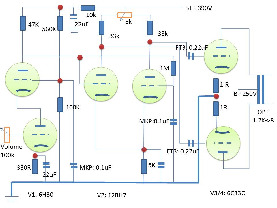

Pls Help me, this 6C33C pp Schematic is OK?
hello everyone,
I was planning a DIY 6C33C PP.
this is the circuit I intend to do, but I'm afraid there are some errors in it.

Well a few things that come to mind.
First here is a cap on the cathode tail resistor of the phase splitter that shouldn't be there.
Second I should think the 6H30 would do a much better job driving the 6C33 than a 12BH7. I would want a low impedance and lots of current to drive the grids of a 6C33.. I'd even consider an IT in this application.
Third the 6C33 is best run with cathode bias - if you use fixed bias you will need to delay the B+ until the filaments are fully warmed up to prevent arcing. Operating stability is less of a given with fixed bias with this tube, although I prefer fixed bias in general.
The grid resistors are missing on the output stage.
Not really crazy about this design.
