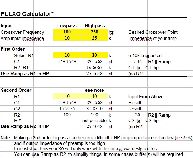

For a two way speaker, I want to make a 1st order PLLXO with 300 hz crossover point. My audio chain is as follows: Desktop PC> Asynchronous USB DAC> PLLXO > Lowpass and Highpass out> one Preamp before one powers amps for woofer and full range driver. So i will be using two preams and two power amps. Preamp for Lowpass section has got 100 k input impedance and 10 ohm output impedance. Preamp for the Highpass section has got 50k input impedance and 170 ohm output impedance.
In PLLXO calculator, should i put crossover frequency 300 hz in both Lowpass and Highpass sections or it should be different?
In the Highpass section should i use 50k (R preamp) as R1?
Can someone help and guide me please?
