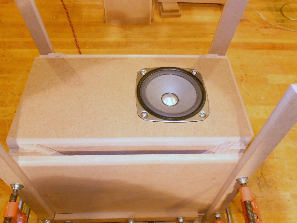

I saw you post that you were going to take them over to Doug's to try in his cab. Yesterday i just finished up a colour matched set for our proto Fonken125T which will free up a set. I thot i might ask if he'd like to borrow the spare set (me knowing that it would give you a chance to evaluate them too) -- i've not had a chance to contact him about that yet (Hey Dougie!!!)

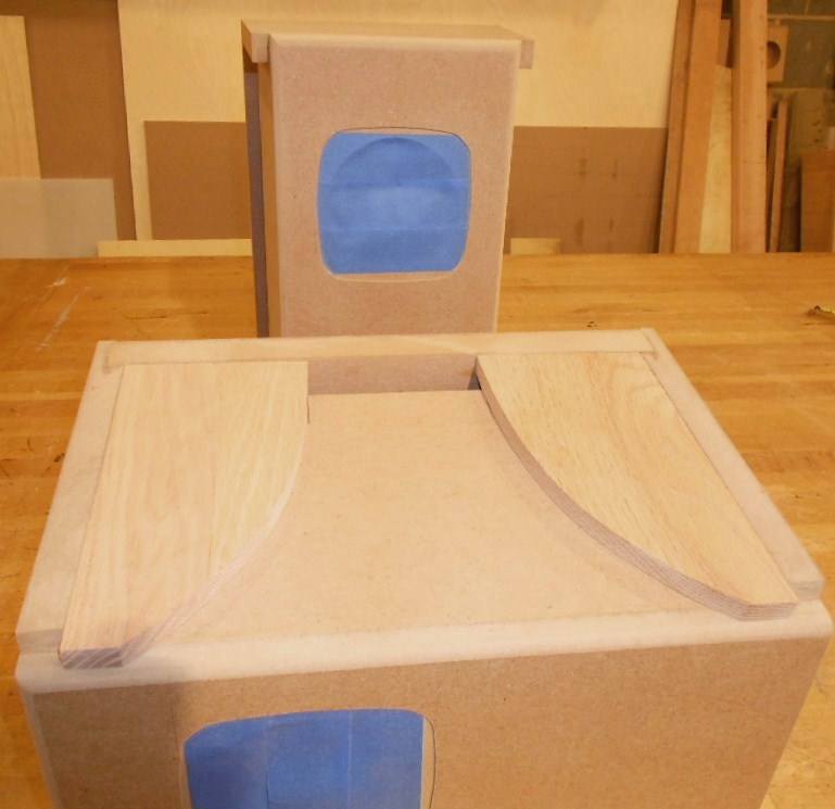

The Truth Is
I had a head start :D

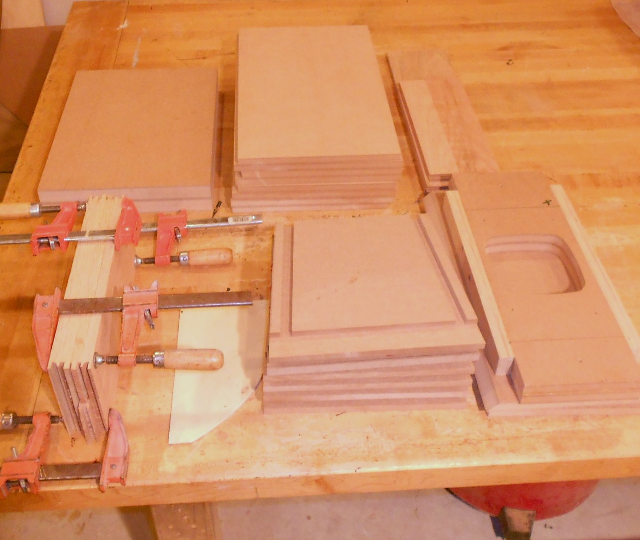

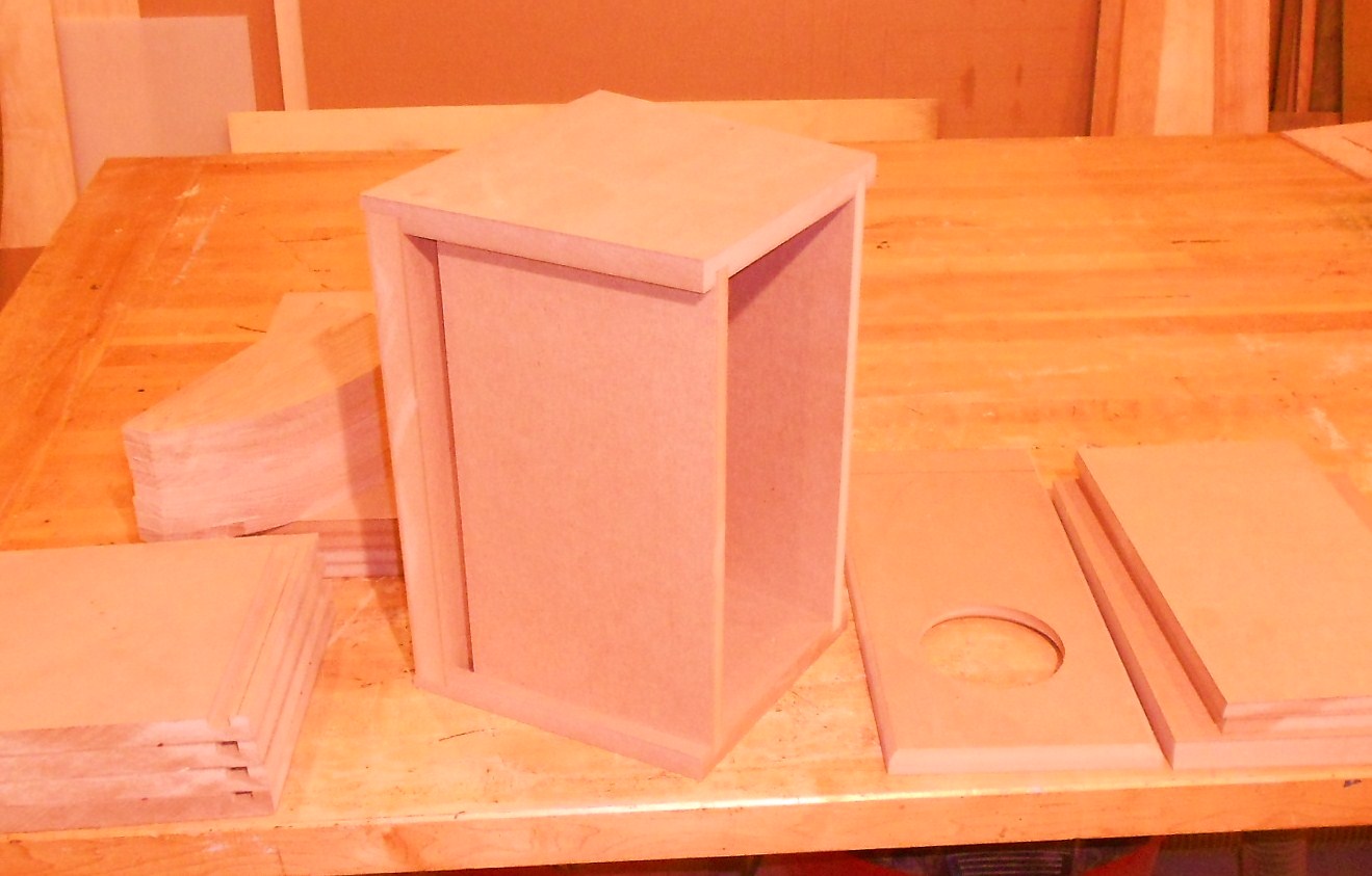

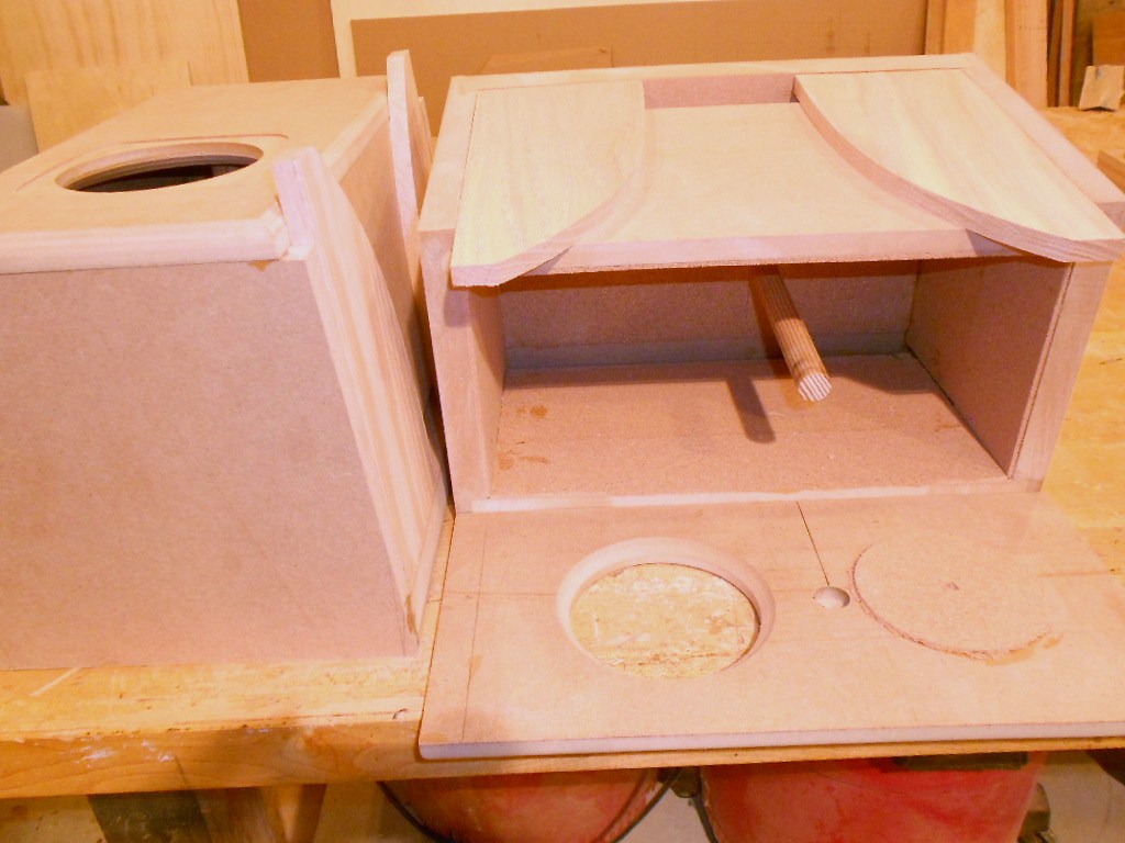

Second construction pic.
Cut length for backs and sides at same time - the box self alines square (because of the "triangle") for glue/clamping.
This is a dry fit; cork next, then glue/clamp up on corner of work bench.

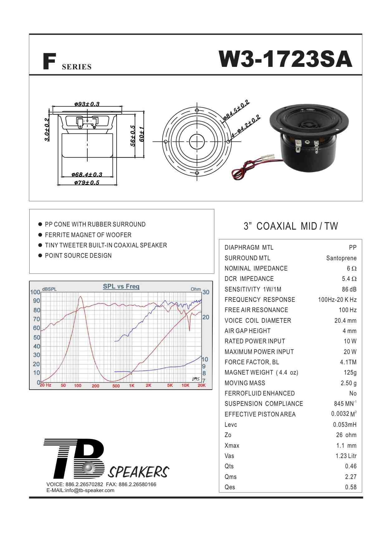

If two-way is not prohibited then maybe a TB W3-1723 coaxial speaker in small BR...
Max
You can play a coaxial really loud without scrambling/degrading/shaking the treble with cone movement/excursion. With a coaxial, the inbuilt tweeter won't be doing any flopping about if you happen to use more than a few watts during exuberant playback. The effort for passive filters doesn't seem to be more difficult than a full range, in some cases. For transparency, we'd just need to avoid RC noise in the crossover by avoiding coaxial that have high LE figures.
