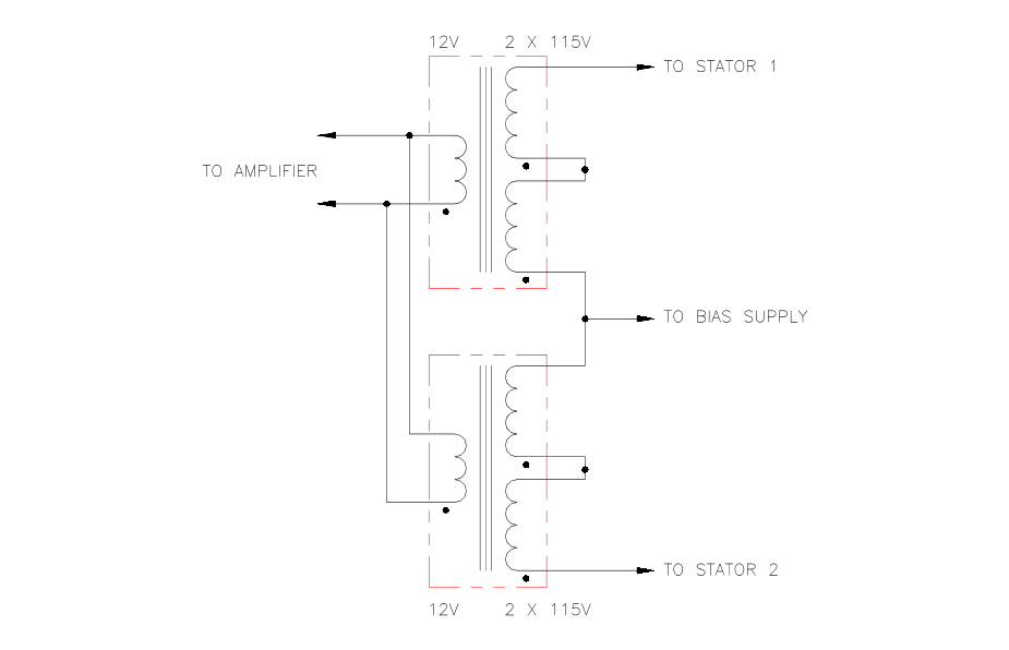

Allelectronics has a toroid transformer that looks like the right voltages, but low power handling. 115/220 volt primary, 8.5 volt at 1.1 amp secondary.
How does this look for wiring two transformers together?
That would be the way to do it. You could also wire the primaries in series for lower voltage out -unlikely you'd want that. However, if your amp should prove unstable with the primaries wired in parallel, you might try the series connection and see if the amp behaves itself.
A pair of those ought to have sufficient core area for driving an ESL.
